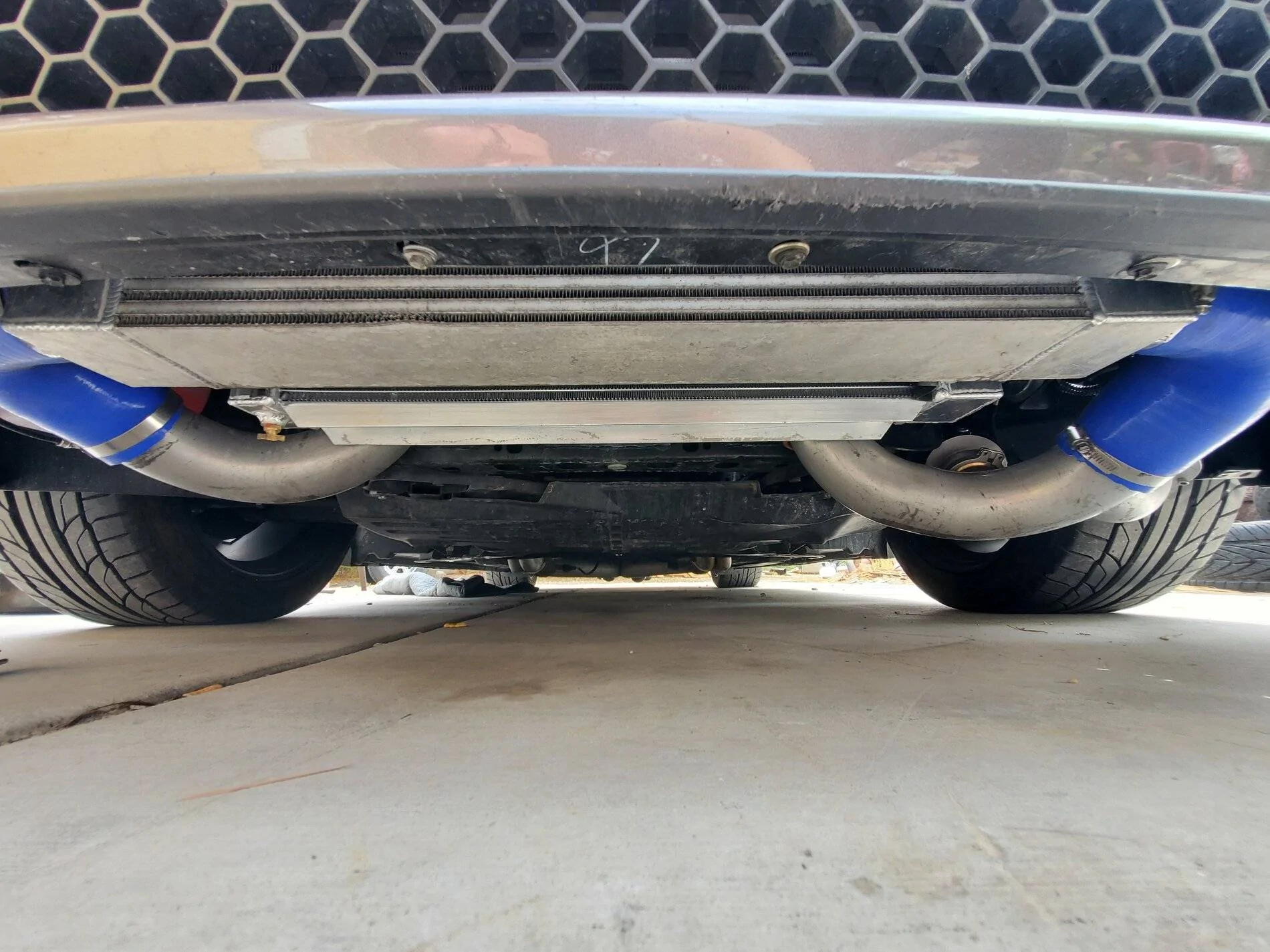

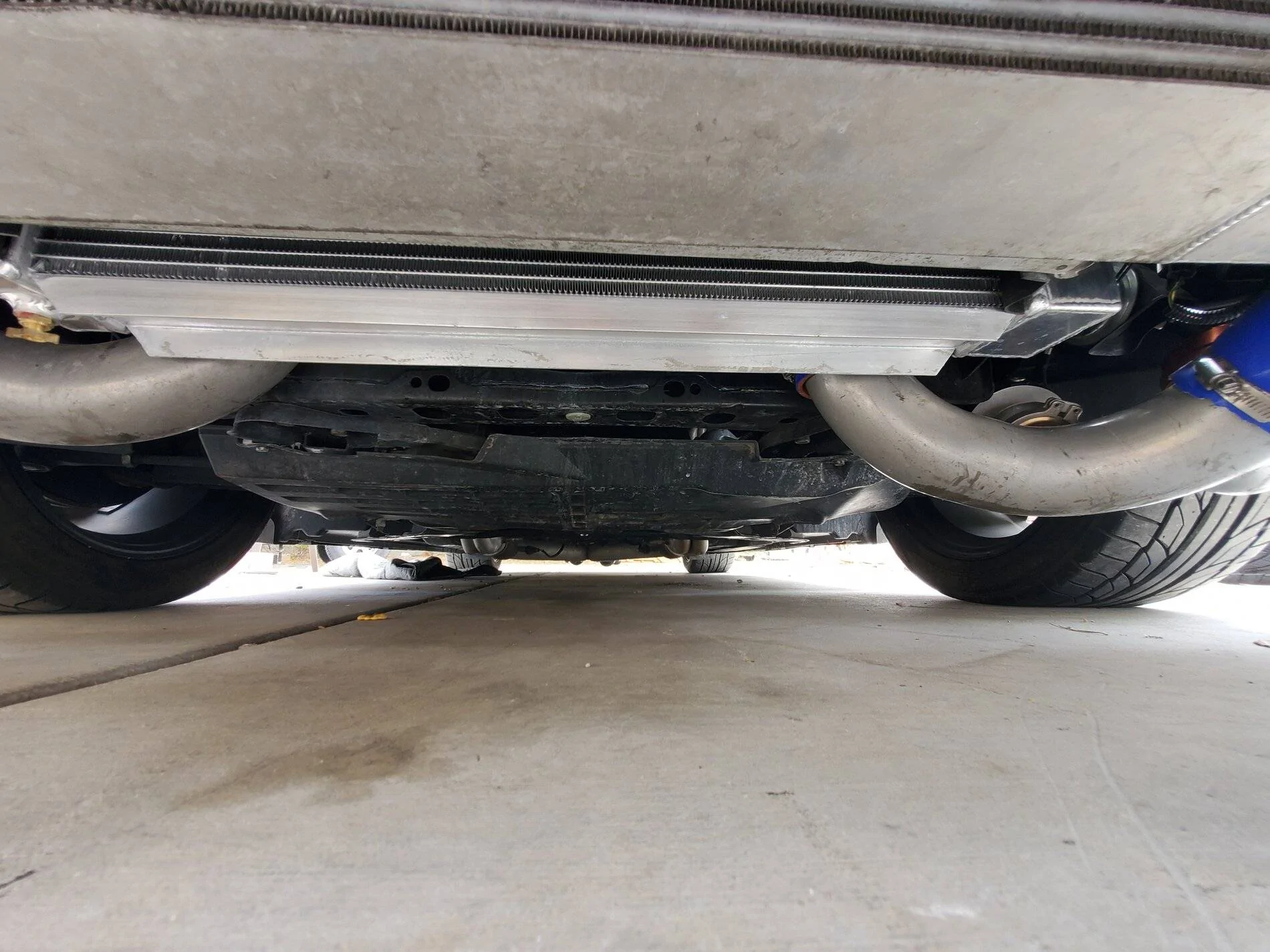

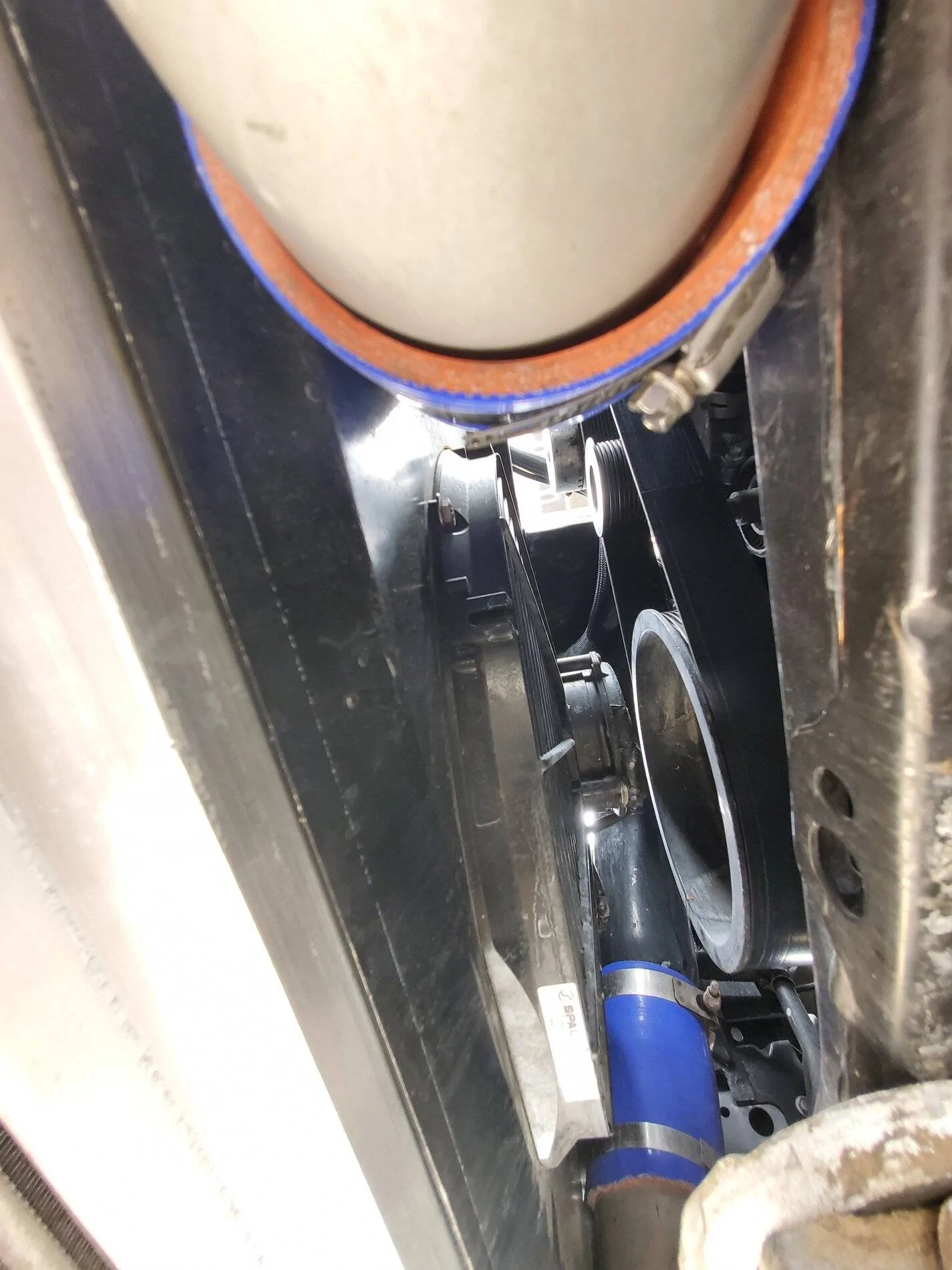

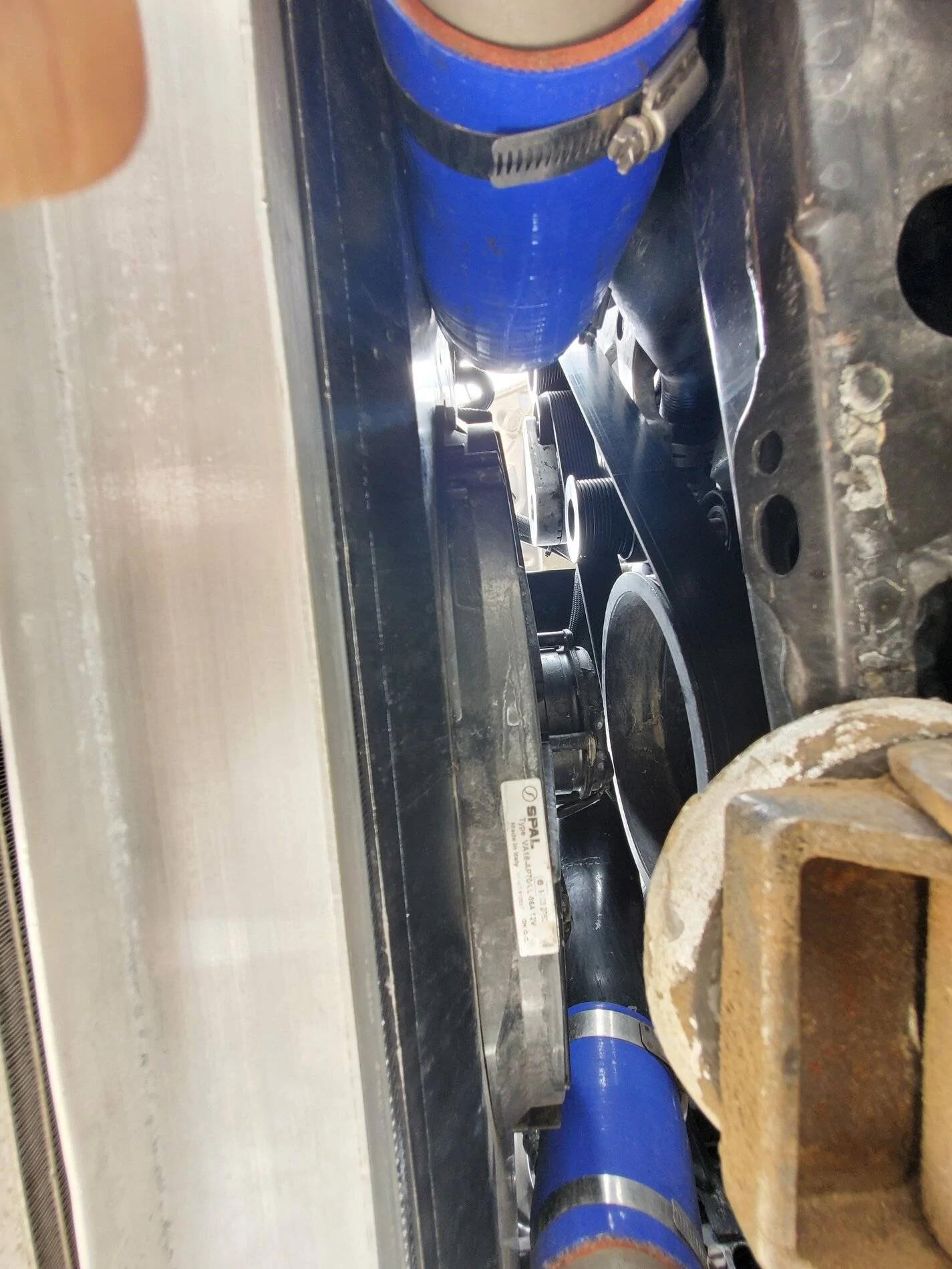

Here are a couple pictures of the bottom and of the fan/shroud. Let me know if there is anything more specific I should post. Please excuse how dirty the car is I have been thrashing on it the past few weeks trying to get it figured out.
Oh I see, yeah air is just gonna shoot under the rad instead of going through it
