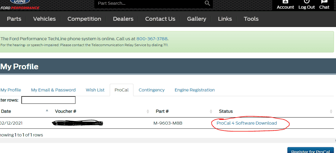

The CAI/throttle body are not installed yet but I wanted to check out the capabilities of the Procal4....so I created an account with Ford Performance and registered the device/kit, and installed the software with the link provided next to the part number (circled below). I then plugged in the Procal to the computer and updated the firmware.
There's no explanation as to what this download contains...is it just the application for your computer to recognize the procal? Is it the actual tune that you need based on the part number/kit? Not clear but I assumed it would become evident once I linked it up to the car.
Next, I flashed the NGauge back to stock (got rid of the nearly useless Lund performance tune...for good?) and plugged in the Procal. Within two minutes, I had corrected for the 4.09 gear ratio and tire diameter (using the revs/mile that I googled for my tire size). Super easy!
But.... There was no indication that anything else was affected in the tune. Is the computer already looking for the new intake parts? It seems like there should be another step here...like downloading and installing a calibration profile of some kind. SCT and NGauge units both required this.
Thanks for any input.

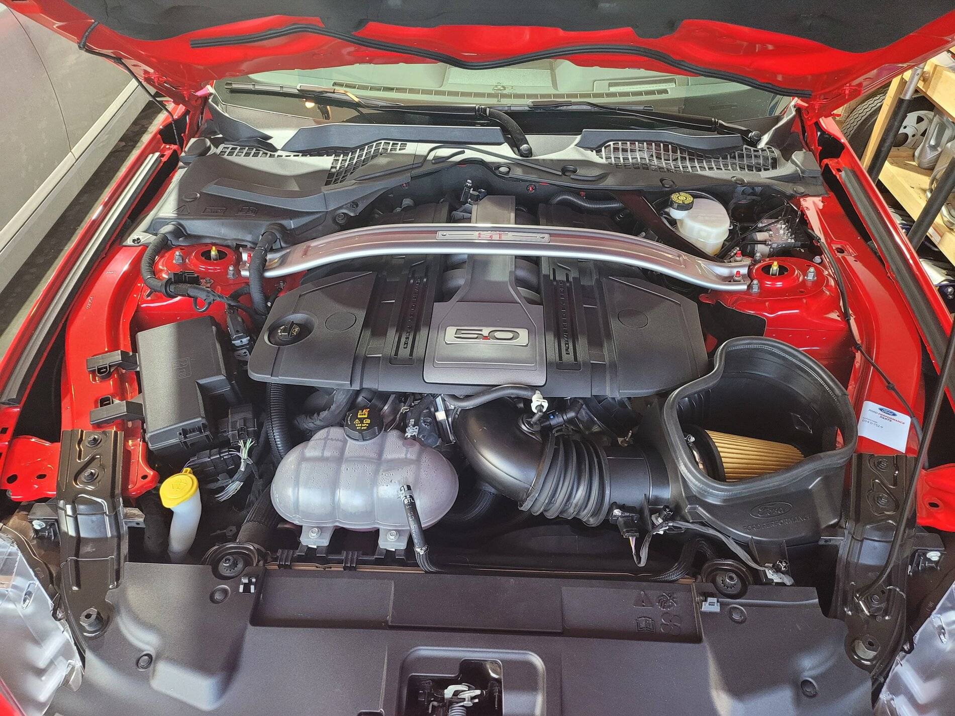

Yeah, it's crazy that a dealer wants $300 to $400 for the install. It took me less than an 90 minutes to do the install including about 25 minutes for the tune.
The hardest part was putting the rubber plug in the firewall after removing the sound symposer. I came up with an simple way to get the plug into the firewall. I took an old wooden dowel rod, rounded the end of it, and rolled up a piece if duct tape, stuck the rubber plug on the end of the stick, and poked it right into the hole in the firewall.
Another thing I found was that the stock airbox had a rigid inlet, while the new airbox has a rubber edge on the inlet. I had to remove the plastic radiator cover and the top radiator support and straighten out the inlet connection behind the grill because that rubber edge was folded over.
I've had my car for a year, and I have 616 miles on it now. The warranty really didn't mean much to me. The chances of me having a problem in the first three years is pretty slim, and if something does go wrong, I'll cross that bridge when I get to it.
So no need to cut or drill into the engine cover? looks like the connector works just fine in front of the engine cover?
Nope, on the 2018+ kit, they include a 90 degree connector for that hose, so no need to clearance the engine cover.
That connector was changed in later kits to alleviate the pressure on the nipple from snaking the hose to fit and had the added benefit of not having to cut the cover.
FP was supposed to send the updated part to early owners if they requested it but I was sent the pvc pipe instead.
