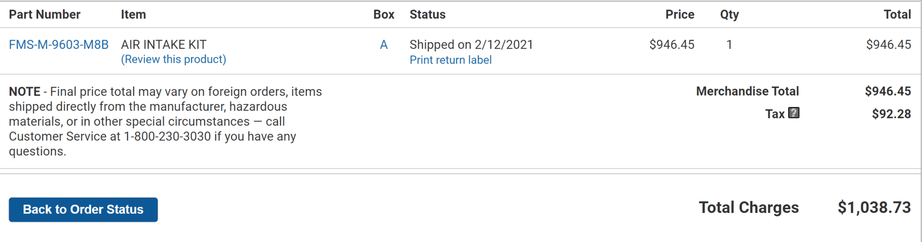

Summit Racing matches any price, as long as it's in stock.Cheaper at American Muscle:
Ford Performance Mustang Power Pack 2 M-9603-M8A (15-17 GT) (americanmuscle.com)
Edit: the first gen ( 15~17 ) s550's Power Packs are different from the 2nd gen s550's ( 18 + )
