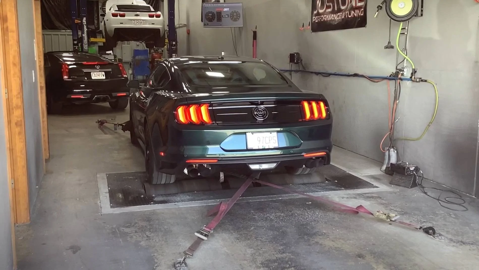

When my car was dyno’d with PMAS, the hood was closed. I wanted it closed to simulate real world conditions. The car made 469 rwhp/434 rwtq in that configuration. This was with One Ethanol S in the tank.

I should also add that I was pleasantly surprised with the outcome, but as I mentioned before, I had to run a PMAS for nitrous, otherwise I would have just stayed with the factory GT350 CAI system, or maybe even added a closed air box with a good filter.

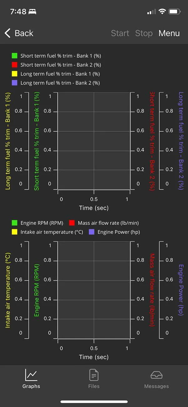

Bank 1 and 2 are all we have in the coyote.
It will show long and short term, you should also have a lbs per min channel.
Thank you.
I was kind of hoping it would combine bank 1 & 2 to give an overall value, as the graph function will only record four values, so I can’t capture short / long & 1 / 2, along with lb/min on the same plot.
I have now found I can split the graph though :
So I will have to see how useful that is once it starts to populate data.

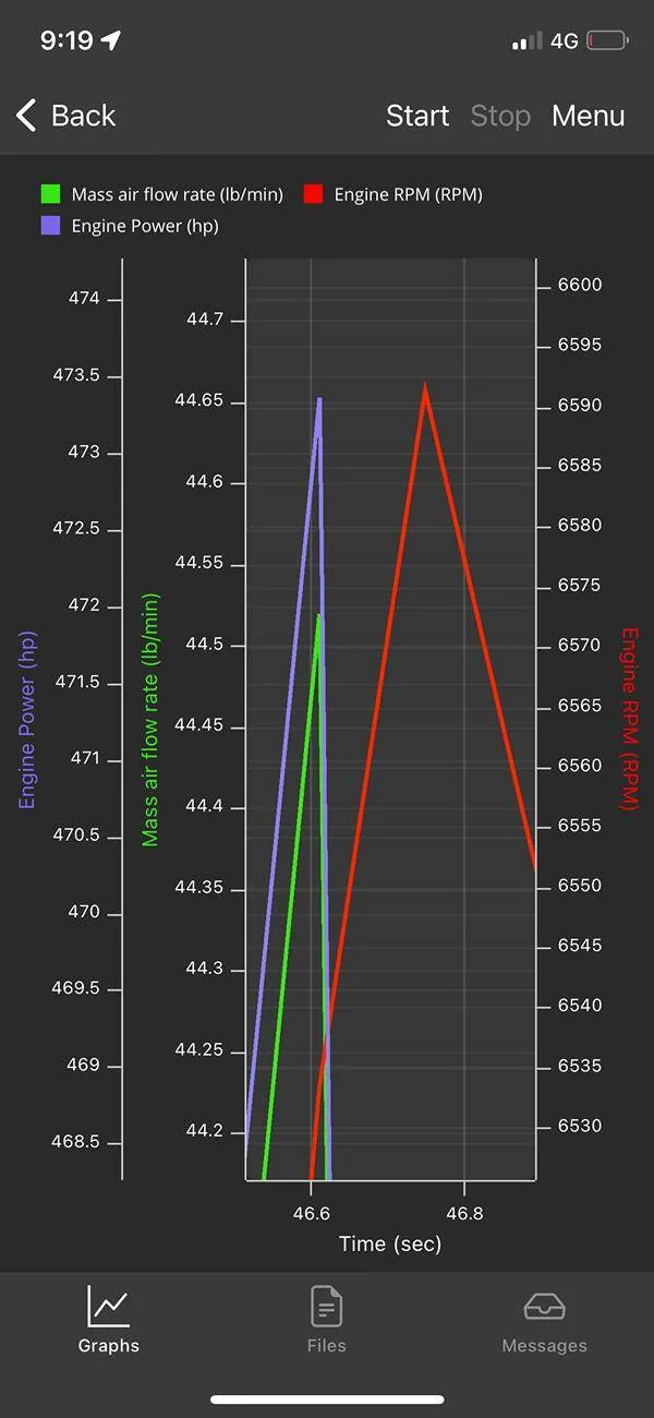

Here is a short test from when I started to mess around with it the other night :
I’m not sure I trust the calculated value in purple … lol
