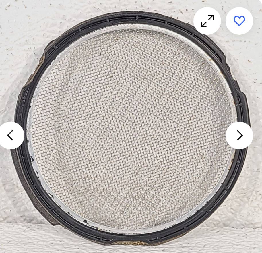

Screens are not how clean laminar flow is created.
If not why are 99% of all MAF tubes fitted with screens before and after the sensor?
I'm asking a serious question.

That is a lot denser mesh that what has been posted in this thread.

Mine always was a bit jerky at steady state-ish between 1700-2000 rpm. Especially when IAT were low. The wire mesh screen I put in cleaned that right up. Hence my instant result.

So, anybody other than @NightmareMoon & I put theory to practice
with using a screen ?
If so, what was your results ?
So nobody then . How can you claim what's going on without trying it ?
Anywho, the LTFT are readjusting.
Missed this, yes I have a screen before and after the MAF. It makes the car run smoother at idle and cruise. I see no hit to WOT lbs per min.

So 3 of us put theory to the test. Awesomeness.
