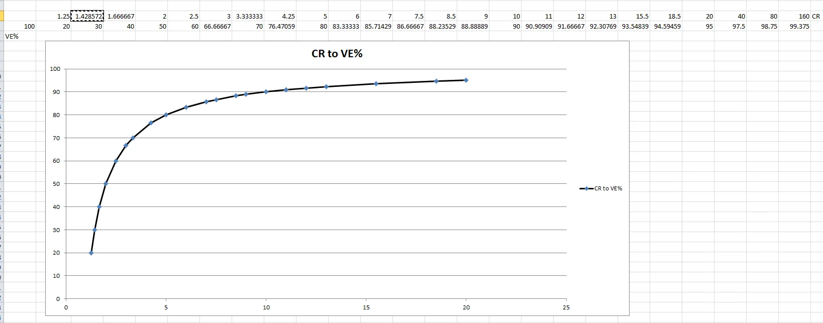

LMAO the formula assumes a lot. So if you have a 17.39 compression ratio, you can't make any torque, and if you go higher than 17.39, you have negative torque, what the gasoline isn't powerful enough to turn the engine over? SMH
By this formula maybe if we left the valves open during the entire compression stroke, we would make more torque. Who needs compression, our FI is going to boost air pressure up to 13 bar before it even enters the cylinder. Think of how Jet engines do it! Oh wait.
Maybe if you used a natural logarithmic function It would be more believable, but then you would have to admit that the higher the compression ratio, the more potential the engine has of making torque. Octane is a limit, lowering an efficiency factor doesnt get you around it, it just hurts output over all. You want air flow, not pressure. Think of what the compression ratio does to the intake stroke.

I figured someone would try and pick it apart but it is, in fact, valid. As I stated, this is an accurate limit between 7.5 and 13/1. It is simply a curve-fit based on what has been demonstrated by the oems. The oems have not produced a pump gas 17.39/1 compression engine and if they did, would it not be at the threshold of detonation?
For example....
- At 11/1 and 3.0 liters (bmw b58), the result is 383 ftlb. The engine is rated at 369 ftlb.
- At 9.3/1 and 3 liters (bmw s58), the result is 485 ftlb. The engine is rated at 443 ftlb.
- At 9/1 and 3.5 liters (ford GT), the result is 579 ftlb. The engine is rated at 550 ftlb.
- At 10.3/1 and 1.5 liters (civic SI), the result is 214 ftlb. The engine is rated at 192 ftlb.
- At 9.8/1 and 3.8 liters (911 turbo), the result is 575 ftlb. The engine is rated at 516 ftlb.
See how it works?
