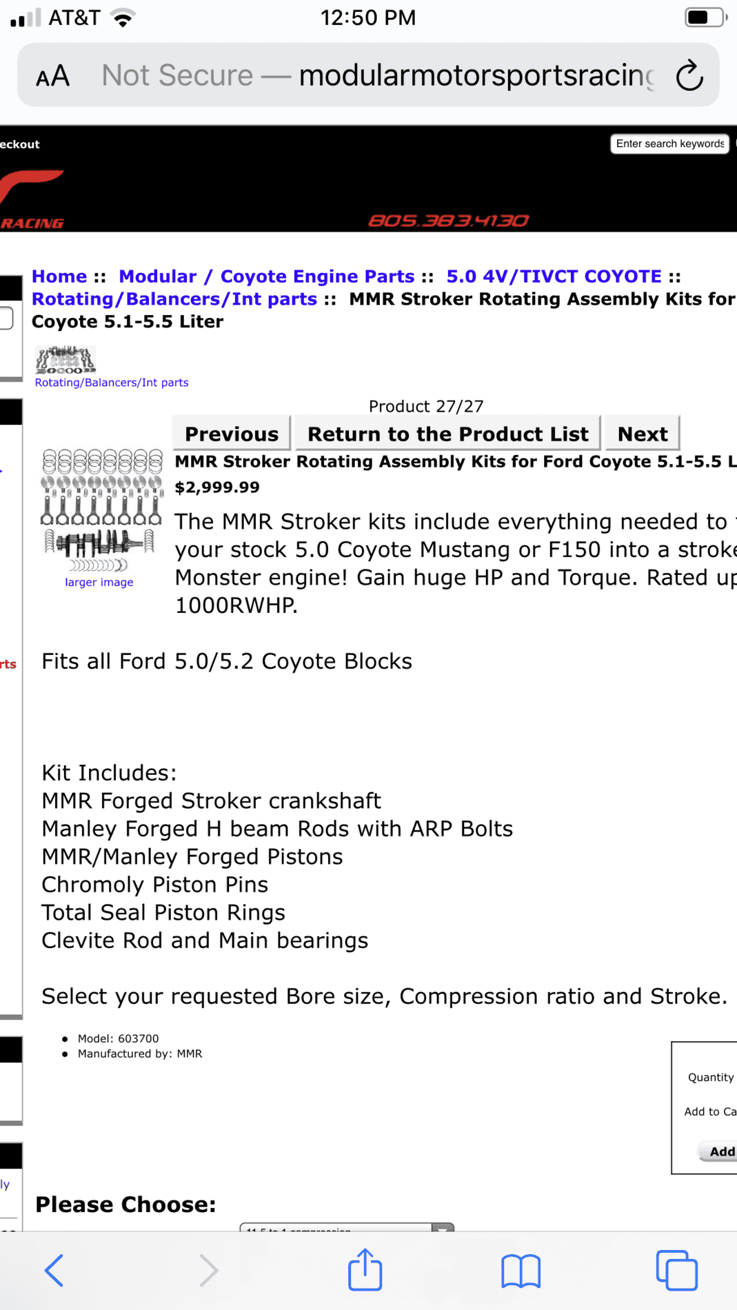

I really want to see someone build that 5.4 .
Based on the stroker kit MMR sells ( I am not sure if they use the Callies crank ) you could be out the door (parts only ) for $3000 plus the cost of the block (3.7 bore is required to make 5.4 with longest stroke ).
With the predator blocks going for $2200 that’s like $5200 and $3900 if you use a Gen 3 coyote block (will make about 5.2).

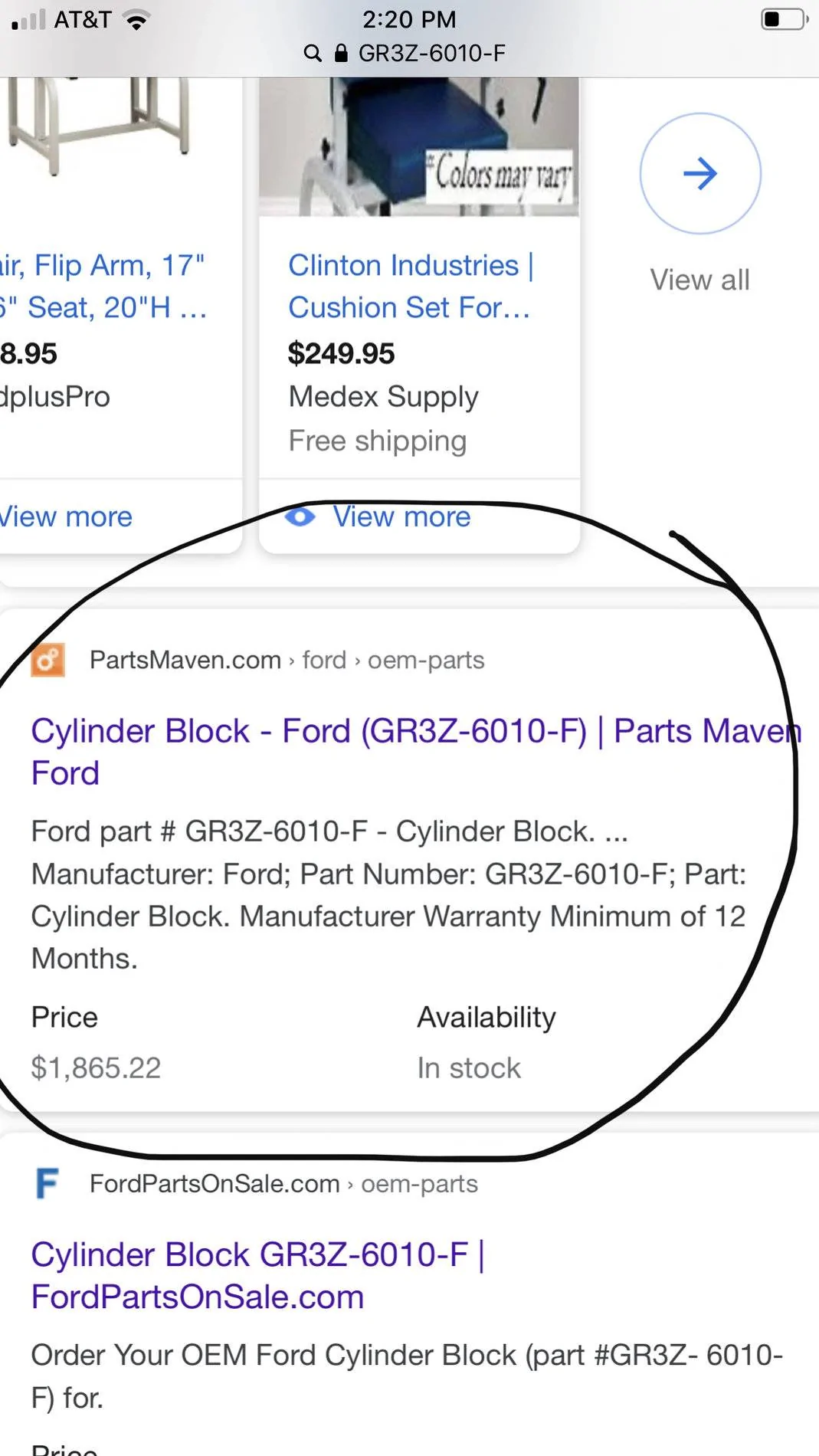

Oh oh !
I wonder if the “cheaper “ version of the upgraded 5.2 block is now available (GR3Z -6010-F) ?
It’s showing “in stock “ on some sites .
For some reason it’s does not ship for free either like the KR3Z-6010-A, which is the predator so it may only turn out to be only a couple of $100 cheaper ... and the KR is definitely available .

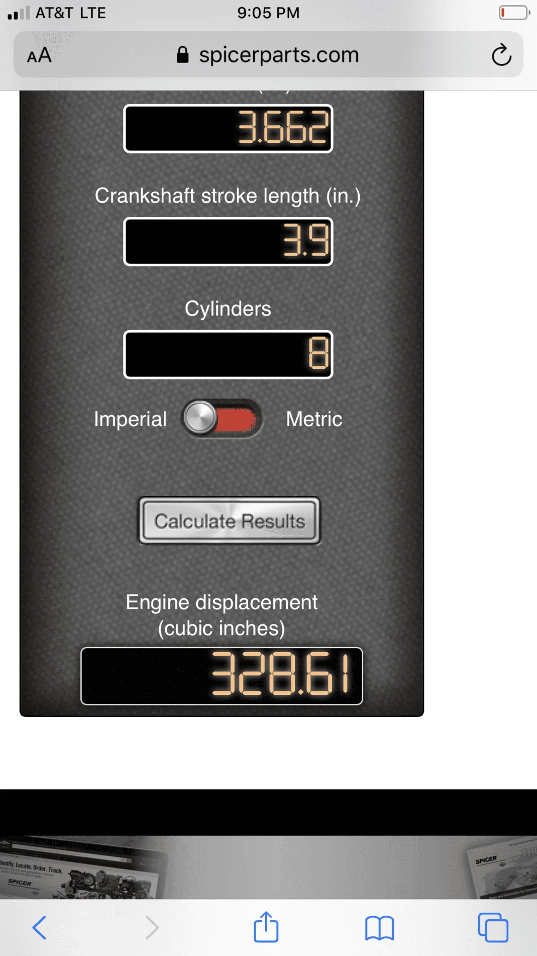

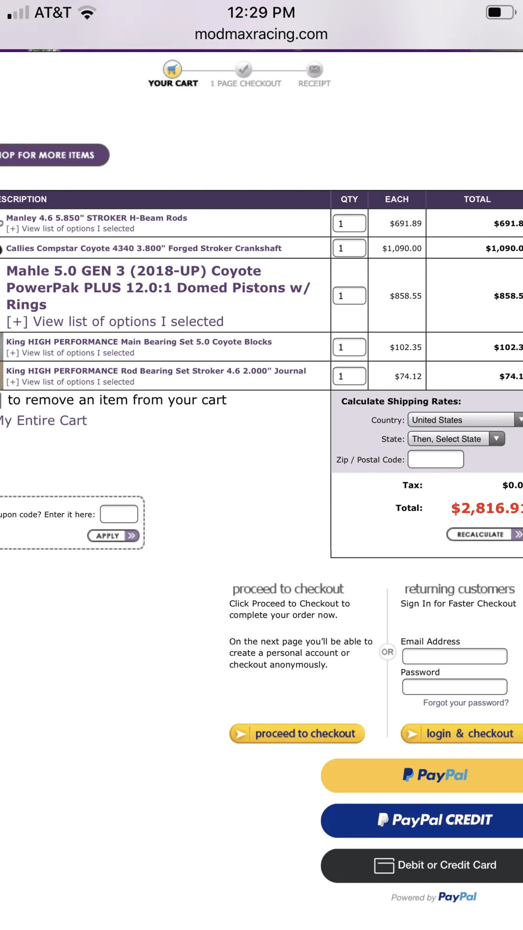

So following up on the srtoker .
Since the MMR kit does not the have option for the 3.662 Gen 3 bore , I decided to put /price one together with the Callies crank (it’s a $100 more than the MMR).
Came to $2800 so a little cheaper than the MMR kit
Can any experts comment on the what the ideal length stroke would be ?
I want as much displacement as I can get per bore but I suspect there are disadvantages with going too long on the stroke .
I would be happy with a stroked 5.2 from a Gen 3 coyote block (can get 5.3 with a 3.9 stroke )
The more expensive option would be using a predator block to get a 5,4(as much as 5,5 with a 3.9 stroke.)

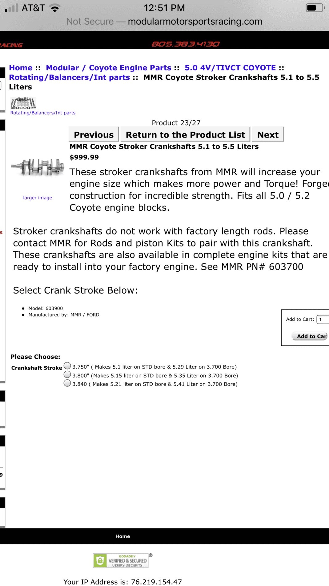

@olaosunt, to me the key is to maximize displacement while keeping the ring pack dimensions at least as good as stock and the rod/stroke ratio within demonstrated oem limits.
Any additional stroke will require a shorter rod to retain the oem ring land thickness and also avoid moving the wrist pin into the oil ring area. The stock rods are 5.933”. We can use the predator stroke of 3.66” as a starting point since it’s the longest demonstrated by the oem. The distance from the crank main CL to the wrist pin CL is 7.764”. If you back out the shorter mmr 5.85 rod from that number you arrive at a stroke of 3.828”
From a rod/stroke ratio standpoint, I stated earlier that I was comfortable with anything over 1.52 but that 1.48 was certainly too low. I’ve since realized that the LS7 ratio is only 1.516. Assuming the 5.85 rod at a 1.516 ratio gets you a stroke of 3.859”.
The lesser of my two limits is 3.828”. You can see why the longest mmr offers is 3.840”. Keep in mind that these are my thoughts based on the data on hand. Others may have some better data points and others still are willing to push the limits a little further than me.
And a bit of an epiphany...you could actually use the predator block and pistons with the 5.85 rod and 3.840 stroke mmr crank. The result would put the piston top 0.007 higher than stock. If there isn’t enough head clearance (there probably is) you could put a tad thicker head gasket. The result would be 328 cid/5.37L. And, since the displacement is larger then the compression would be higher, at about 9.85/1 as opposed to 9.5. I actually like this idea because you get the oem boost-specific piston design, geometry, and ring specifications plus the ultra-stout predator block and the extra cubes of the stroker crank and more compression.

Thank you again for a lesson even I can understand (sort of . Lol)
Max stroke of 3:84 it is then .

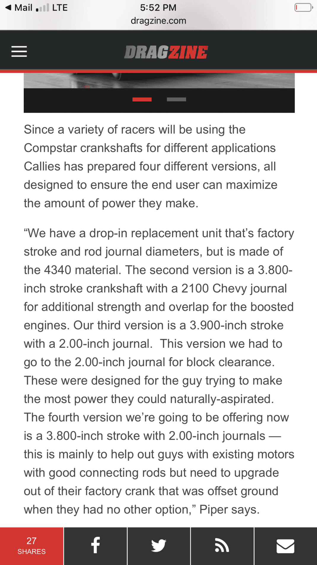

Here is an article about the Caliies cranks below
The 3.8 stroke is what they recommend for boosted applications .”It uses a 2.1 Chevy journal for additional strength and overlap “
https://www.dragzine.com/news/blue-oval-backbone-callies-new-compstar-coyote-crankshaft/
