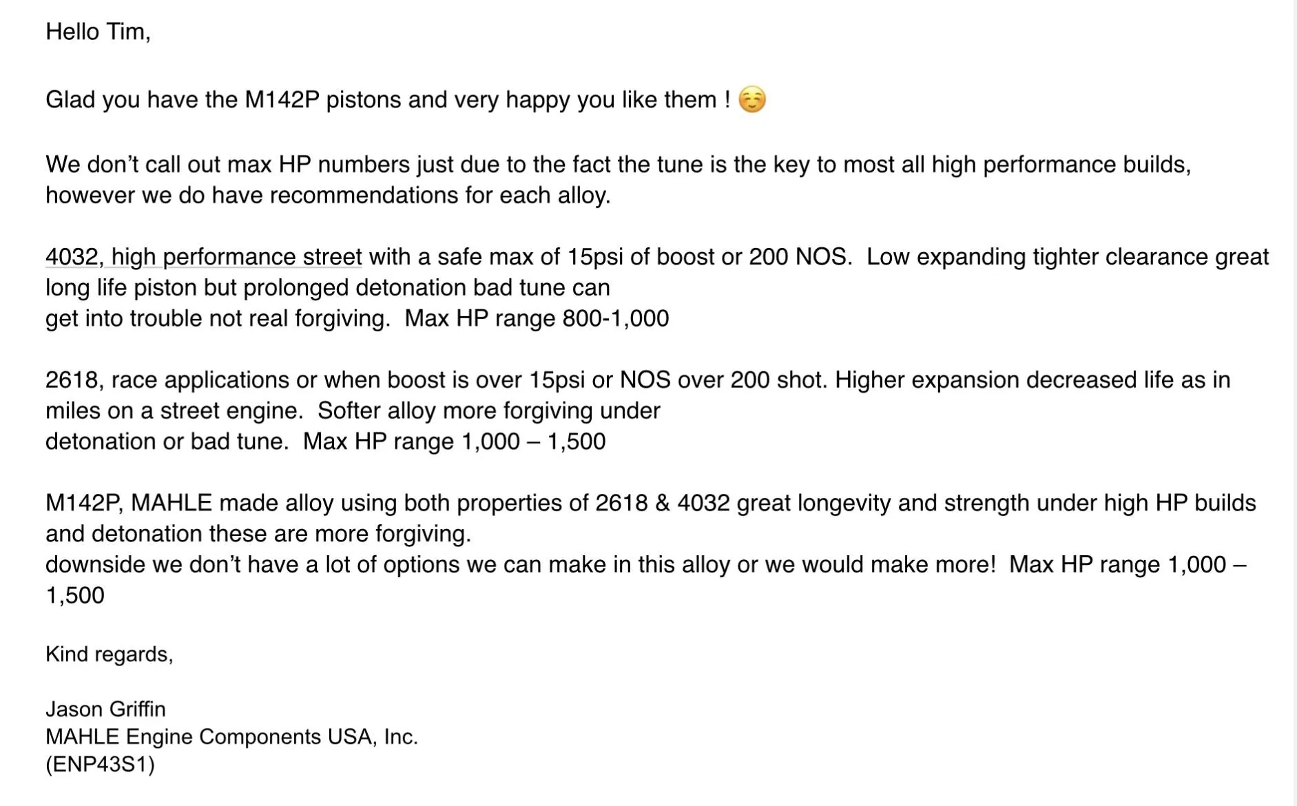

im getting a sleeved coyote built ATM using M142p pistons. when I was deciding what to put Into the build and going around in circles and trying to learn what various pistons are good for , strength , life span , ,warm up time etc.
when comparing all the metal types I went down a rabbit hole. The Mahle M142 properties I kept coming back too. Probably due to the fact it’s kind of best of both worlds. It’s a street car and I wanted OEM type of characteristics.
I reached out to Mahle USA and had many emails with Jason , with all sorts of question which he answered to help my decision.
This was one of my question‘s and his reply , which sealed the deal for me
I’m interested when comparing the limits of all 3 alloys. Does Mahle have a range where you would recommend 2618 over the 4032 or M142P.
2618 with its shorter life span , but better in racing applications , and the other 2 less expansion tighter tolerances better for street applications and quicker warm up time so to speak.
Where does Mahle draw the line between each piston alloy ? And HP rating ??

I don’t like when they limit the pistons by boost. It’s not exactly an accurate way to measure.
the numbers he is quoting for 4032 is the same numbers most performances shops put on the stock pistons.

I tend to agree. I think they are very conservative in there approach to talk HP numbers etc. And yes boost is so variable on every set up.
It would be nice if they did have a detailed spread sheet on HP ratings of there products. Give the customer a bit of an idea what to aim towards for the HP needs.
I felt from my research 4032 was about as strong at stock pistons….yes probably better more tollerent but not a huge Amount better let’s say in the coyote world Anyway. This is why they are not highly sort after or i guess popular in build On here and most shoot for 2618.
due to The fact that the M142P acted like OEM with regards to heat and tolerance and they are it not far behind 2618 in strength I gravitated toward them.
I looked outside the coyote world and found m142P very popular in the bmw , Audi, Europe market and very hard to find anyone with a bad experience with them. So that what cemented my decision.

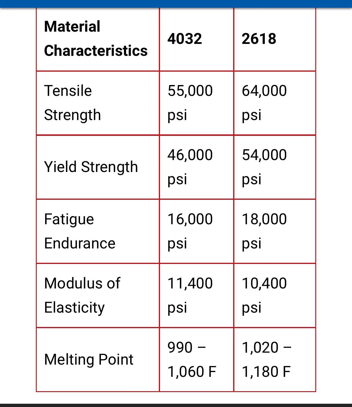

There are few free lunches or big leaps in metallurgy. It happens every once in a great while, but if someone is claiming something that seems spectacular, it usually is.
There are certain constraints that are difficult to circumvent.
Strength vs toughness for instance. Thermal expansion vs toughness (particularly in Aluminum alloys).
There are "tweener" alloys that try to be a better, more optimized blend of trade offs, but if you find an alloy that's stronger AND tougher AND expands less but costs the same, then the obvious question becomes "if that's true, then why would anyone buy the other two?"
If it were true, it would run the other alloys out of use.
