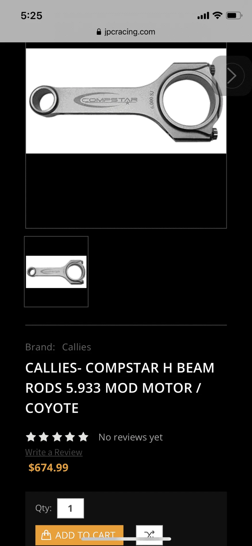

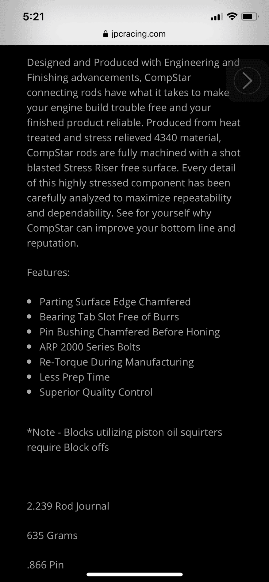

k1 was one of the rods I was considering but decided on this. check these out

I can’t say about other rods but the compstar’s were balanced to each other almost perfect. They do not need to be balanced ether because the bob weight was same as the factory rods. So if balancing is a factor then then you are money ahead

Do the H-beam rods not clear the oil jets?

It would "appear" it's not the rods, it's the pistons. Seems most if not all forged pistons do not require the factory oil squirt jets.
My question is why is it necessary to remove the jets, since the oil jets help remove the heat of combustion and allow the engine to come up to operating temp quicker and more efficiently?
What would it hurt if you kept the oil jets with a forged piston?
From How to Build a Coyote Engine on any Budget:
The factory oil squirters are designed for the factory cast pistons and are not needed with high performance racing pistons, like our JEs[quote/]

forged pistons do not need squirters and almost all aftermarket pistons will hit them.
You don’t want squirters because 1. The oil is better used elsewhere. 2. Oil spraying under the pistons will add weight to the rotating assembly.
