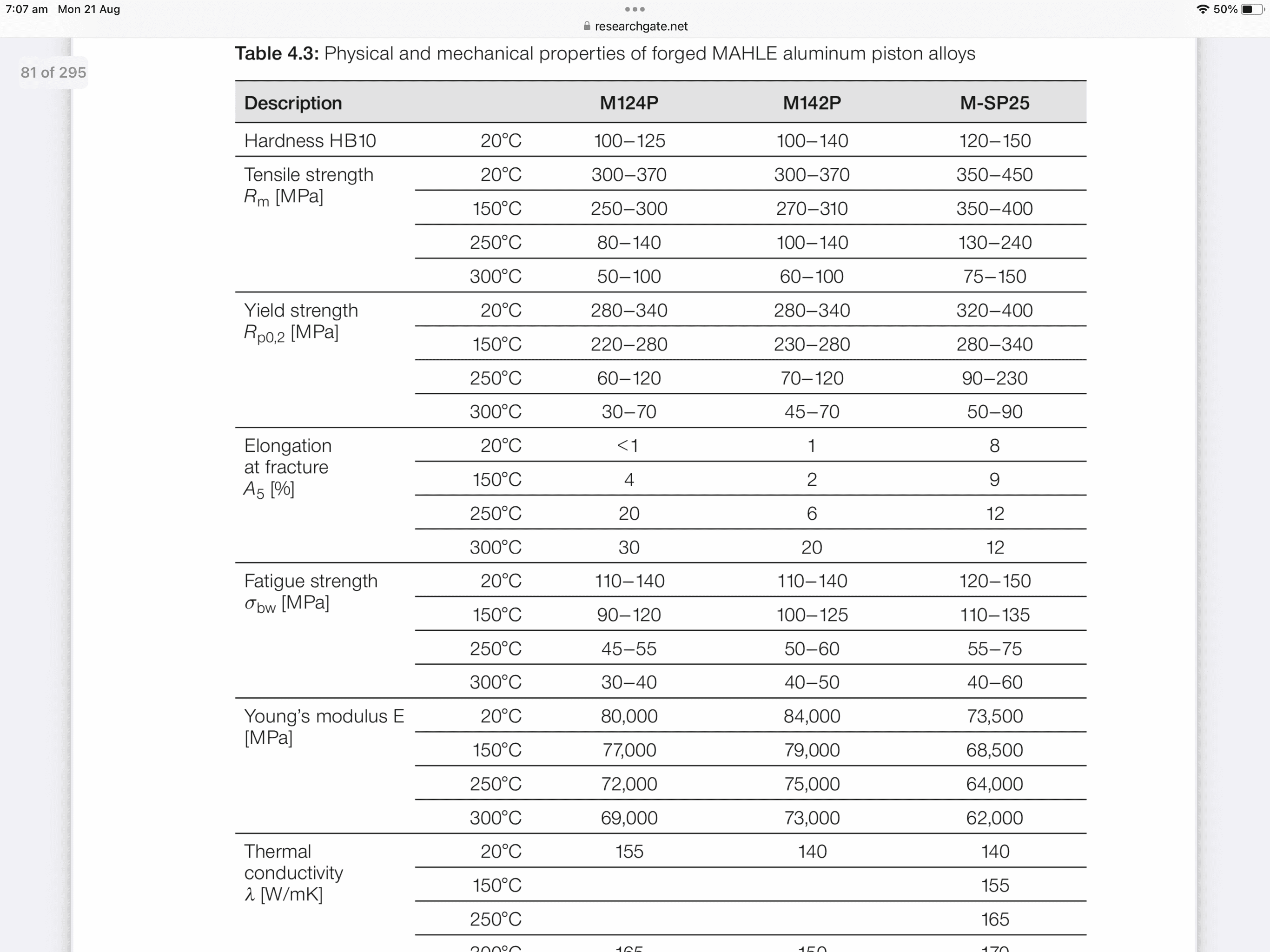

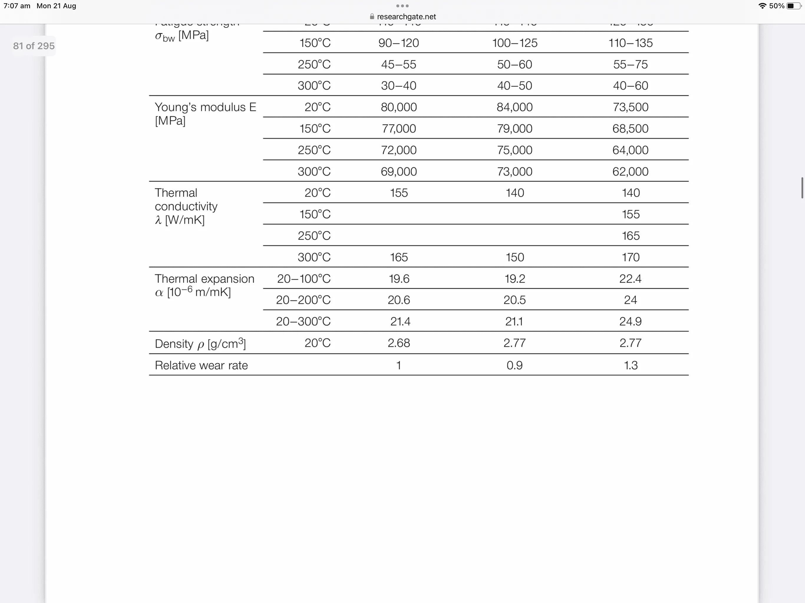

So the only benefit to 2618 is ductility. It can take more detonation than any other but it’s softer and expands 15% more than m142p. So 2618 wears out much faster, I wonder if people know that they are expected to change 2618s every 30,000 miles or less. If you have a race engine that you tear down regularly and make big numbers 2618 is perfect for you. But if you want to build one engine and have it last 100,000 miles 4032/m142p seems to be the better choice.
If stock pistons are holding 1000+ as long as there’s no detonation. How much more can m142p pistons hold over stocks. At what point is 2618 needed. Is 2618 able to hold a little more than m142p or is it a significant difference
Mahle drop in pistons appear to be 2618.

I don’t know the answer , but your logic 100% matches is why I went with M142p. They will easy do 1000+ , I only want 750 , 800 on an every day driver. Give me OEM type warm up times etc and Longevity.
through my research I felt it was a good all round option for a street car.

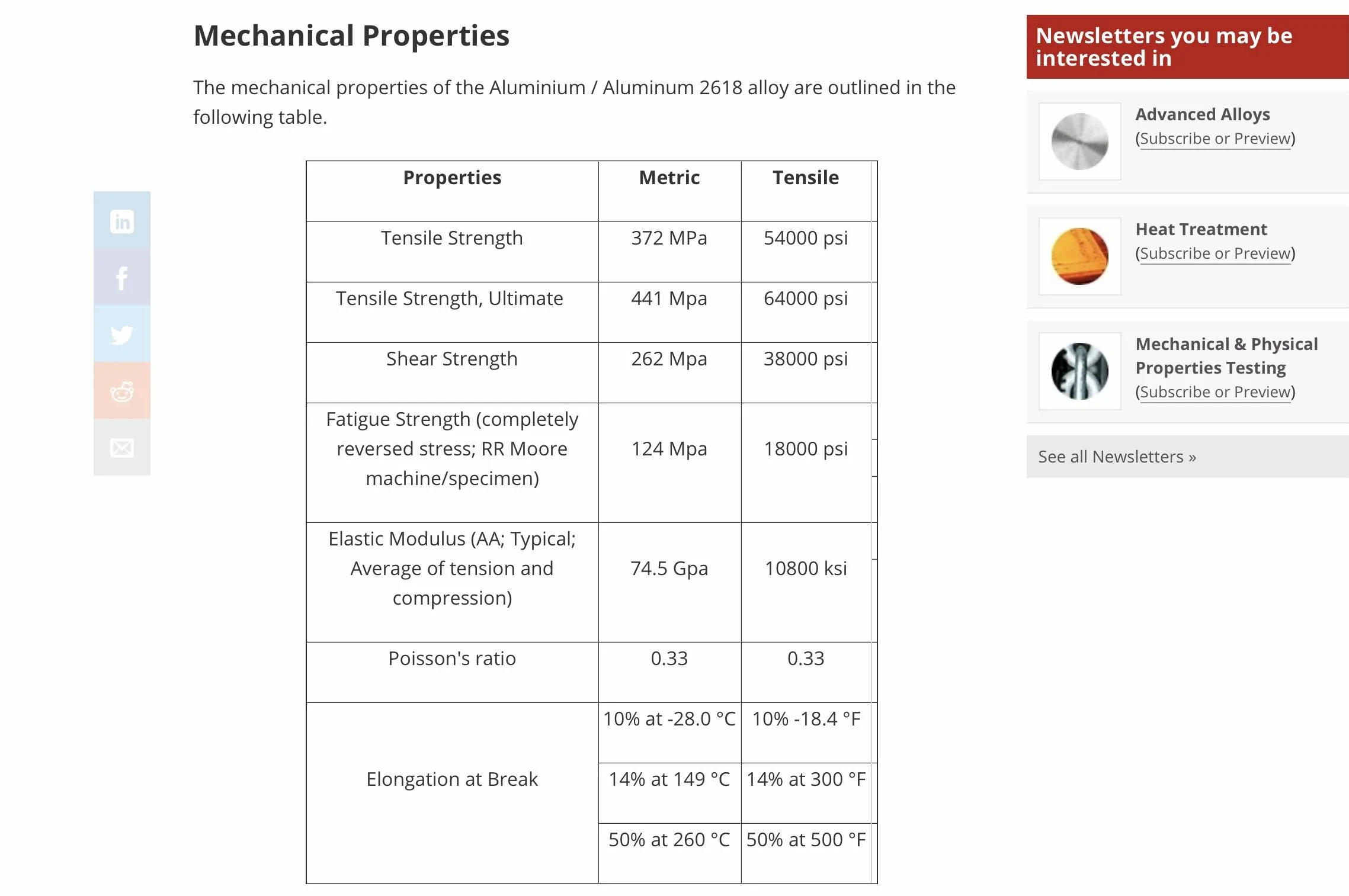

if You compare the ā€œ physical and mechanical property’sā€œ of the alloys gives you a good representation of there differences. They are different , but in my eye’s the mechanical difference in overall strength wasn’t massive , maybe 10% if you could put a number on it.
so many factors go into the over all mechanical ability of an alloy.
google the different properties to get an idea of there meaning.
