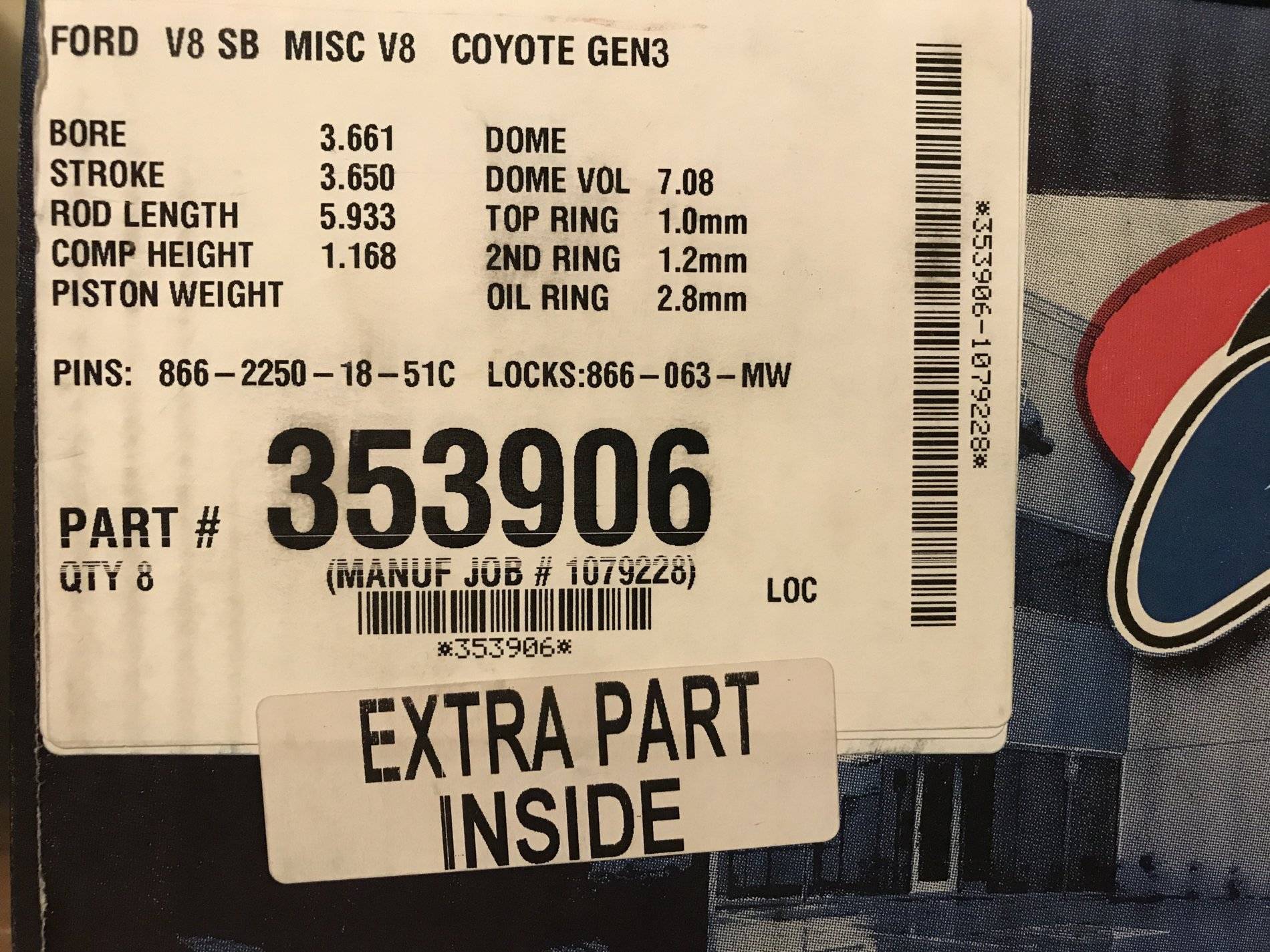

Toy Cobra,
Is you motor running yet? What did you thing of JE's quality?
