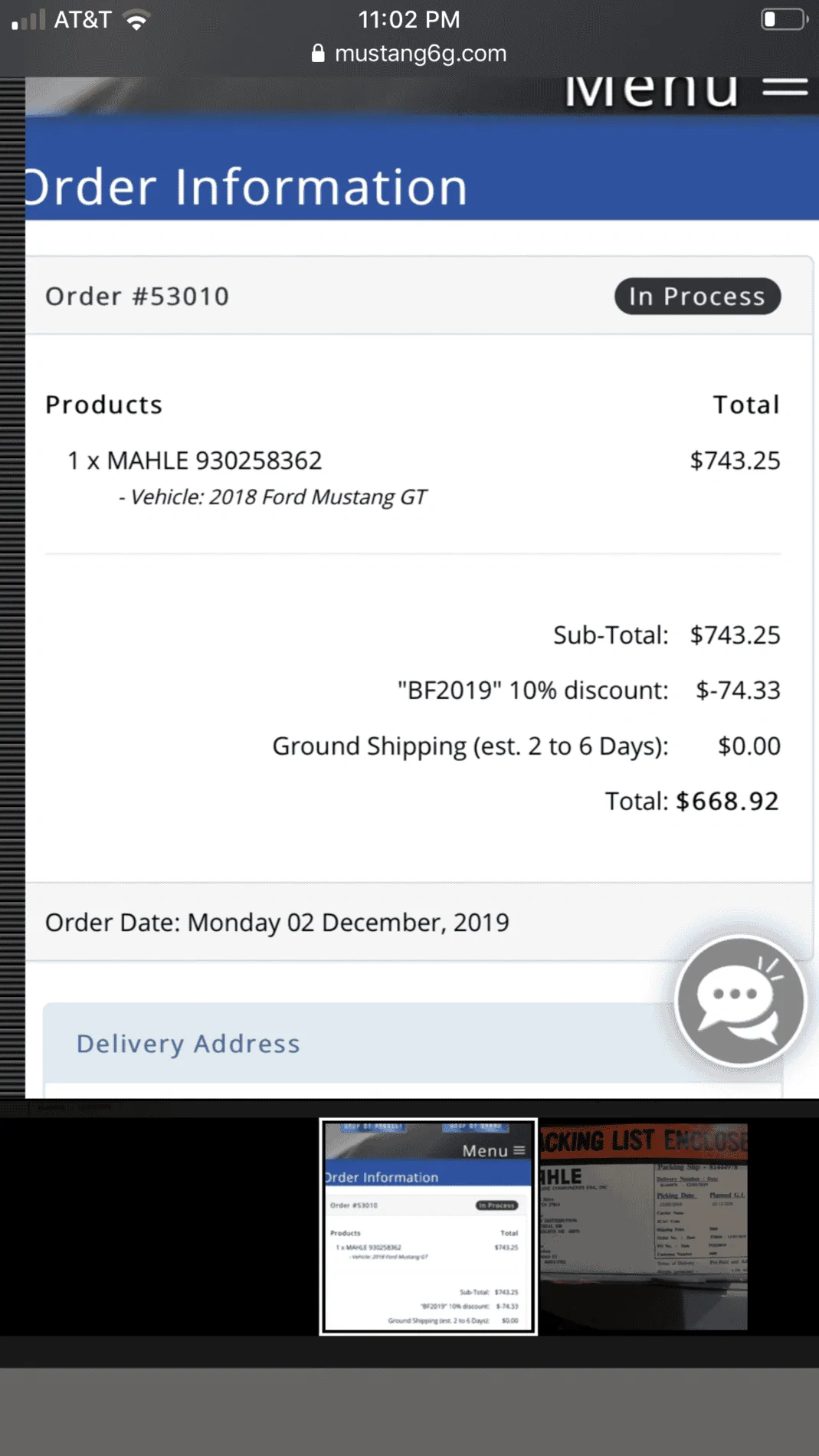

I have been trying to get these Mahle's for nearly 2 months. Found some JE's in stock, but are quite a bit higher in cost. Never thought these would be so hard to get.

I have the J&E 2018's in a 5.2. Haven't run it yet. You can get them for less than $700. https://www.vividracing.com/pistons...e-1201-70cc-dome-pistons-set-p-152657250.html
That’s a nice price and similar to what I paid for the Mahle but does not like the J&E Come with rings ?

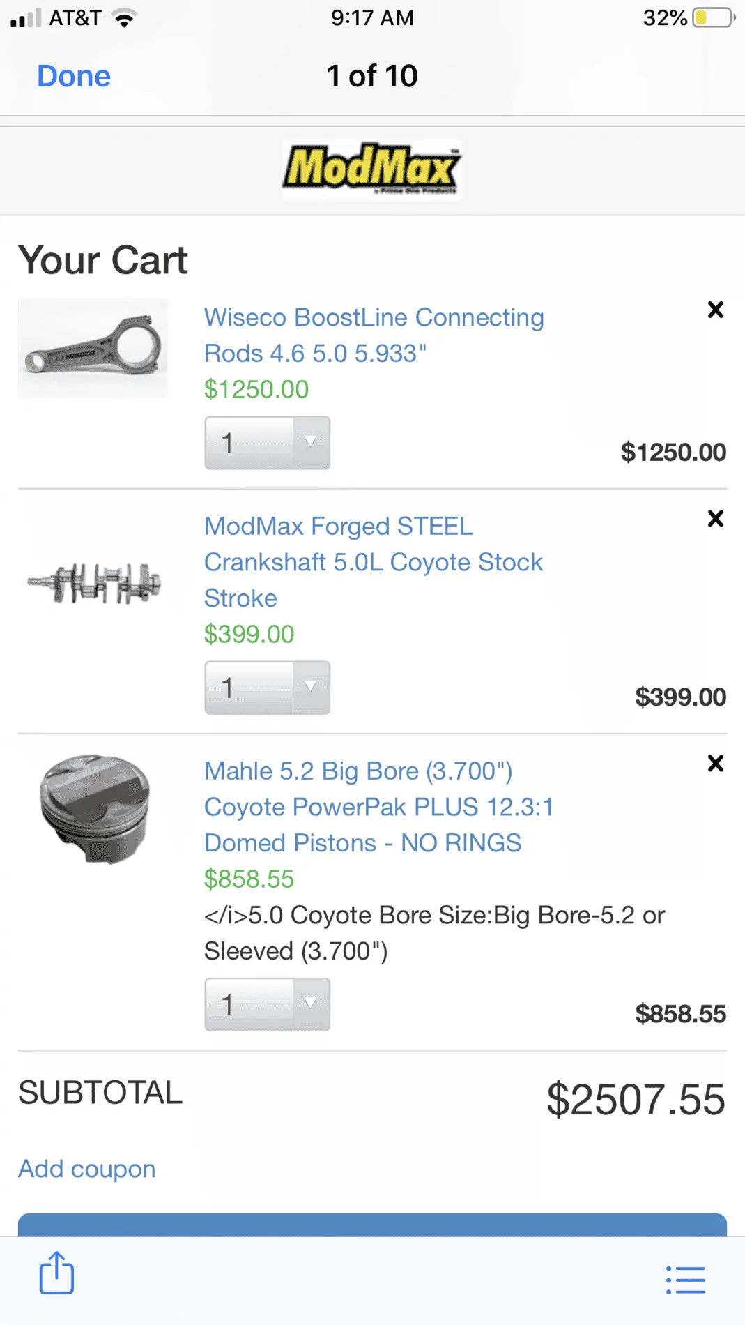

Funny you say that about the rods as one of my builders thinks the boost line rods are a “gimmick”.
Not truly an I beam but same cost .He thinks the Manly H tuff rods are a better option if you don’t want to spend the $$$ on an I beam rod .

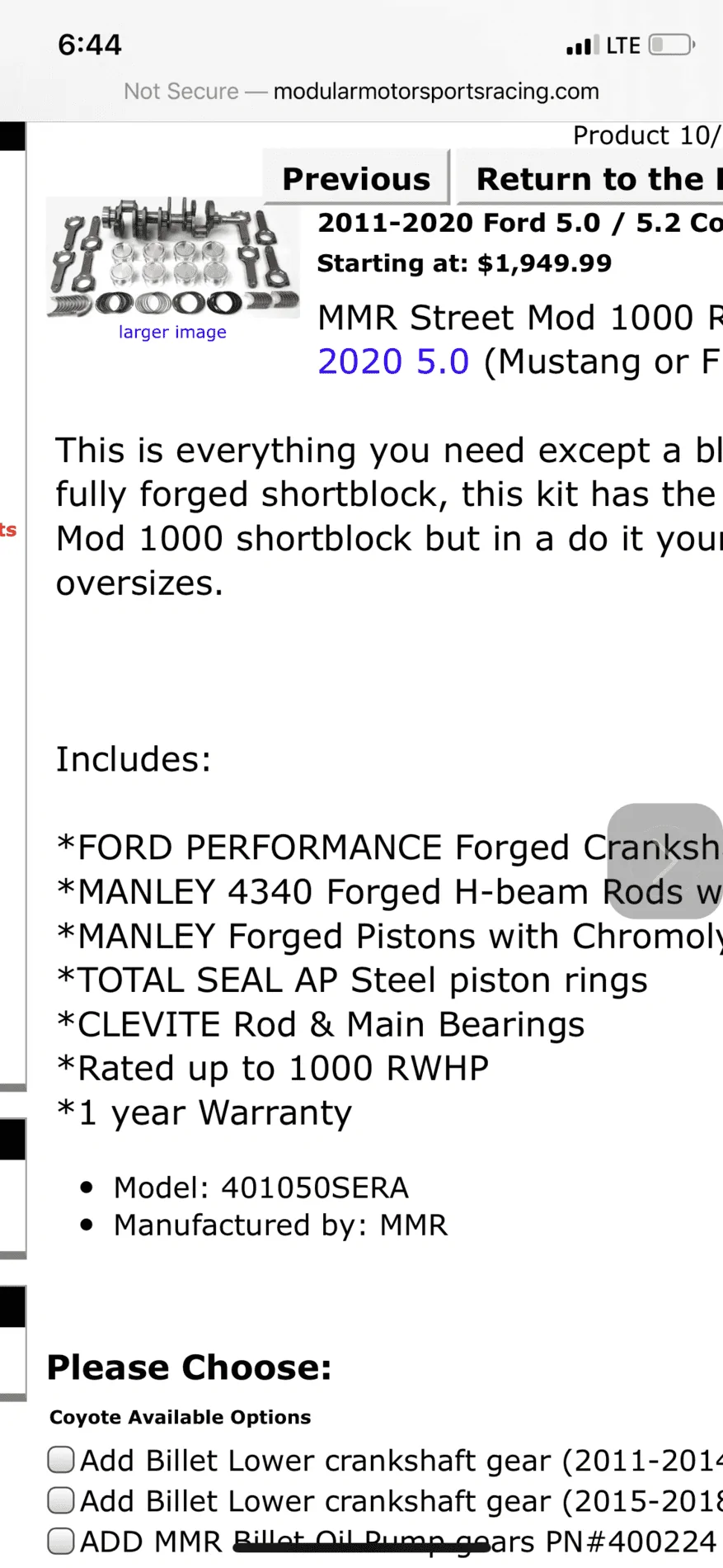

Below are the parts I first put together for the 5.2 block build but he can do $200 cheaper if he supplies the Manley pistons and H Tuff rods .

Boostline rods are not I beam And not H beam they are an A beam rod

Only $200 cheaper. The rods are like $400-$500 cheaper alone
If you are planning to stay around 1000-1200 I would do this

boostline rods will handle 2000+hp and are light weight like I beam
