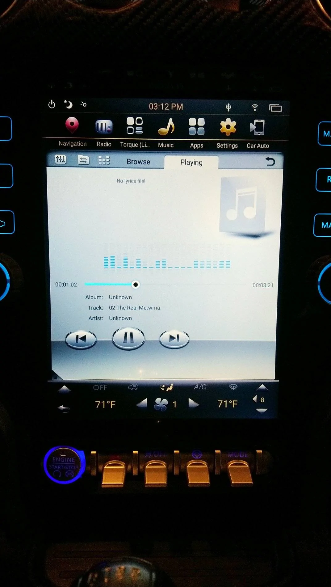

What was I thinking?!?! I was so concerned about trying to make the original voice command Ford Sync player work for my music files, I never spent the time to try out the music player software that comes with the head unit. The Music player is quite good, and sound quality is FAR SUPERIOR. I'm sure some after market Player Apps will be even better. This one however, will suffice quite nicely for now. I figured out, in order to make this player work with my USB thumb drive files, I had to plug it into the extra USB cord I ran under the glove box (as it wouldn't work with the USB port by the stick shift). One of the nicest things, is I set it to play full screen so it shows all of my albums to easily scroll through and select. When in full screen, the player also allows me to grab the little "dot" and slide it to fast forward or reverse. Can't do that with the Sync software provided. Frankly, it and it's DSP SUCKS compared to any decent media player!!!
I can't wait to try out some other music player apps, since sound quality is my thing. Don't care much about video.
I'm was using one USB plug for the dash cam, and now the other for my music files. I can see perhaps getting a much larger than this mini-32GB drive, in order to include some video files, like movies for the wife to watch when we take trips.
One problem, is it DOES NOT show the Album name or Artist. It always says "Unknown". I wonder if it has to do with saving all the files in WMA format??? I thought that format would also save all thumb data?!?!
Anyway, the real beauty of any decent music player, is it has a function EQ, and a "Loudness" option to boost the low end noise. I really like this when listening to older recordings, because all their older recordings seem to sound better with the loudness turned on.
I can finally hear "The Axe" in all his glory!

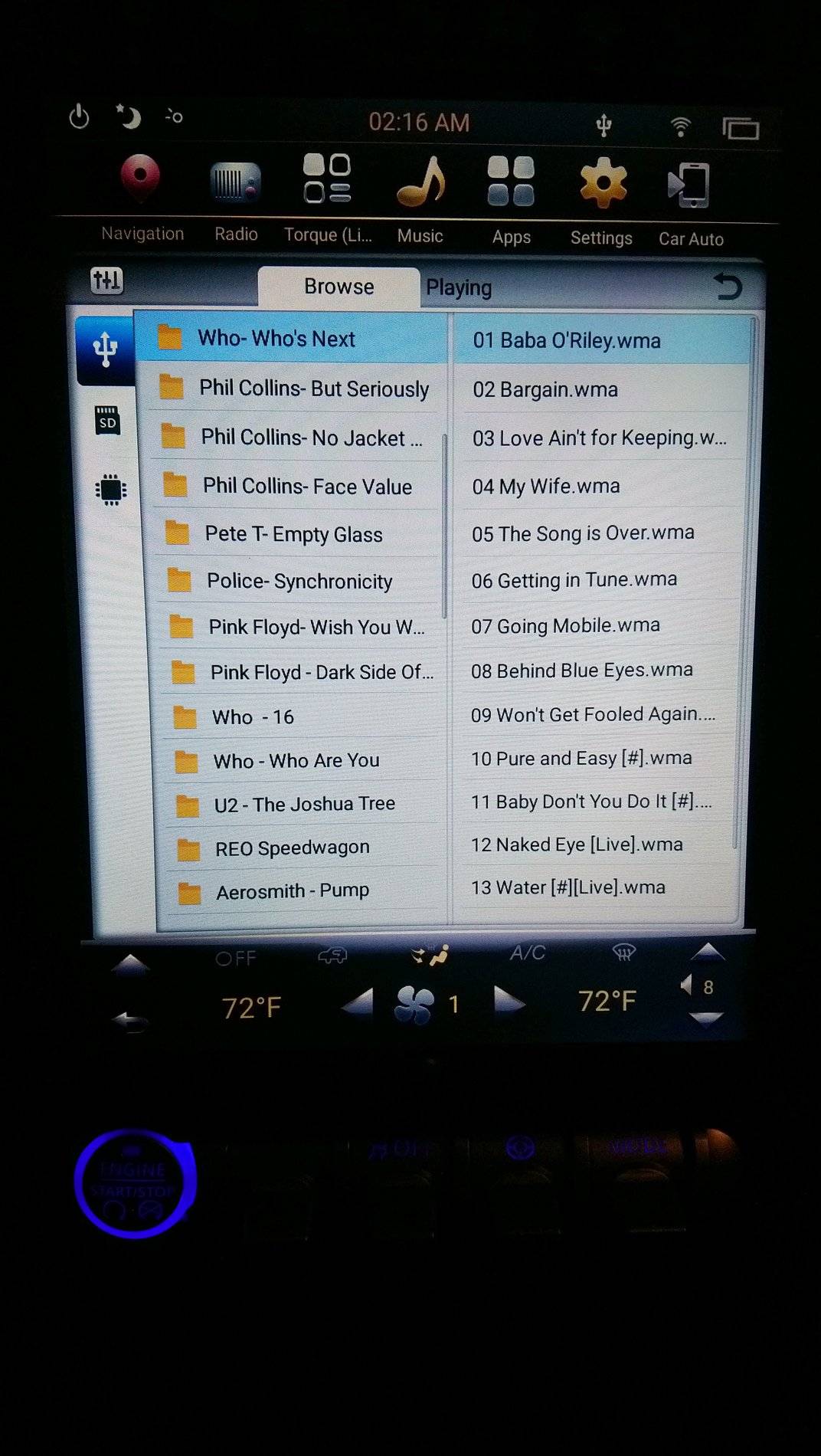

Question: When I go to the Browse tab, How do I get it to list all my Album files in Alphabetical Order?
