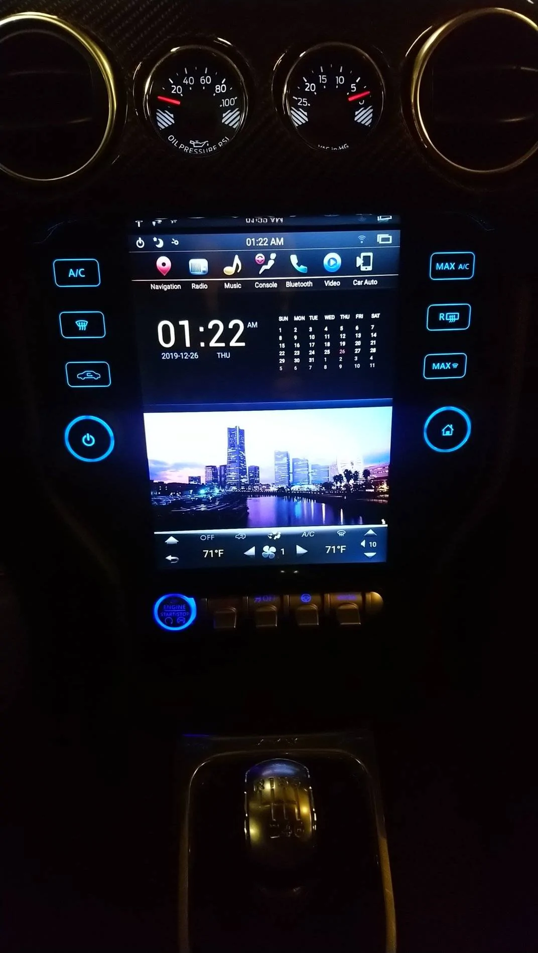

My first complaint, is the home screen. It has this huge clock and calendar, which is completely useless. You can't use it for anything at all. It just takes up space. And, the city-scape pictures below are completely useless. You can't even edit those to get rid of them, and put a different picture in there. It's very amateurish. A real home page allows for basic widget apps, like weather and news links, etc.. To be honest, the home page should have the Sync software/radio in the bottom panel, and not useless pictures of cities none of us live in.

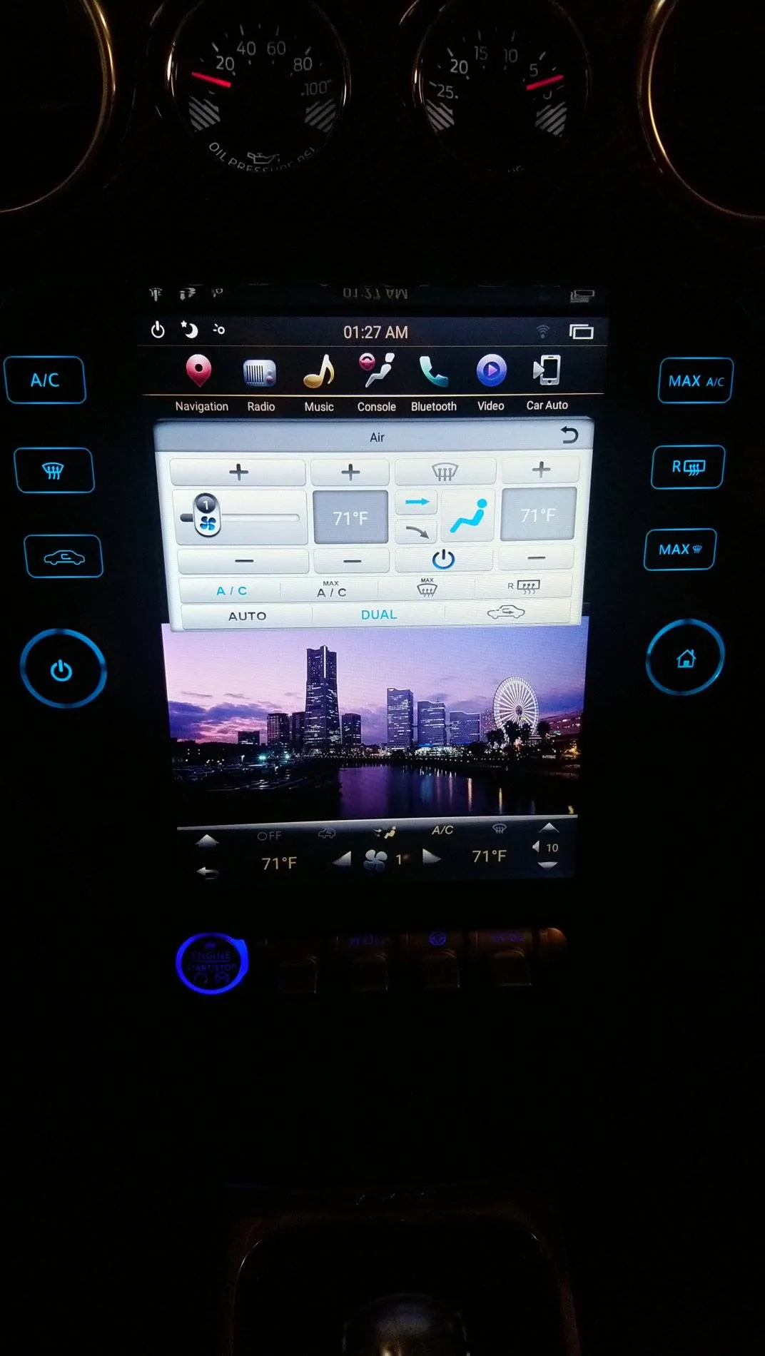

The second problem, is the A/C controls. The bottom panel allows you to control the fan speed, but the temperature can only be controlled by bringing up the split screen to change it. This is very difficult when driving. All the other Phoenix vertical screen radios allow you to adjust cabin temperature on the bottom with fan speed, but not this one. Again, very amateurish, and frankly unsafe to use while driving.

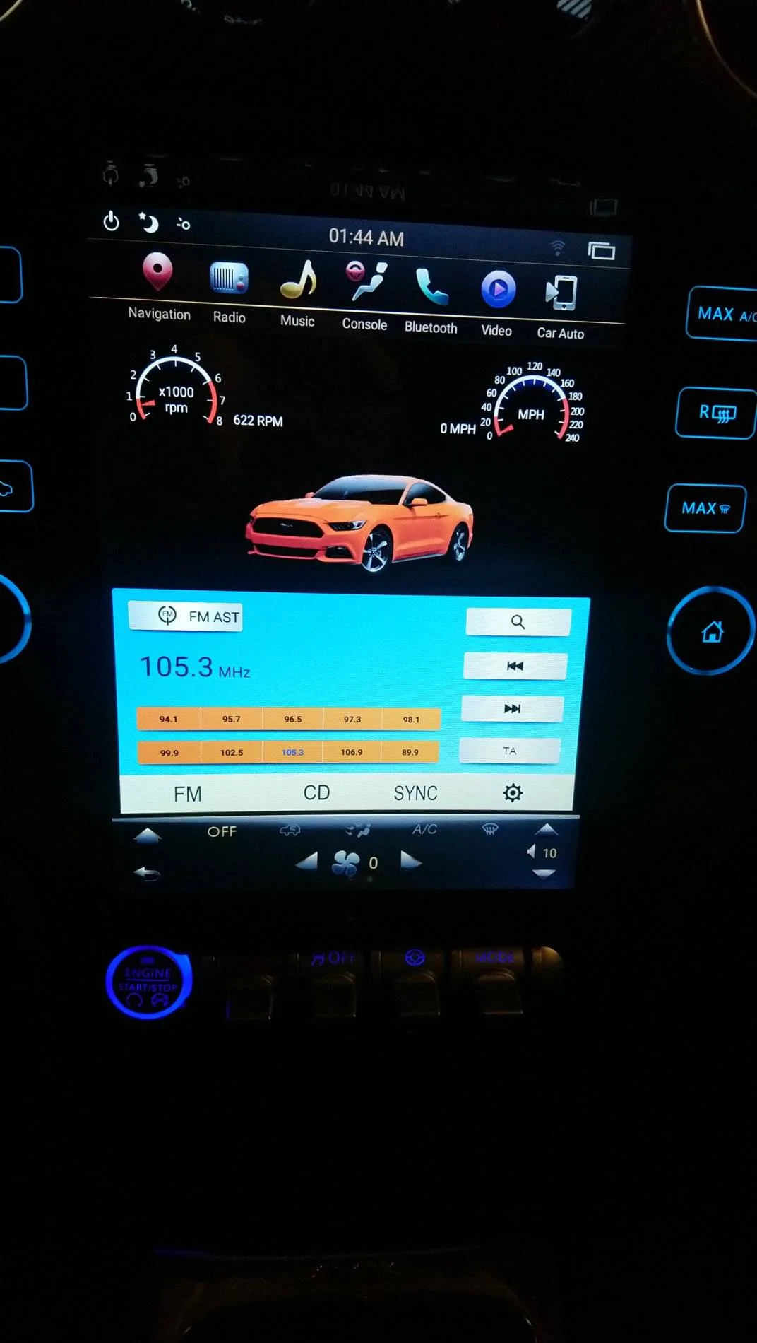

Next, the Sync software. Most things are there on the radio tuner and USB music player. Sync still works, along with text message alert. This is the one part I really do like. They managed to keep most of the important Sync functions.
Now for the bad. This Sync radio software looks like it was designed by a 10yo child. Bright blue background with yellow station buttons. In fact, it is SO BRIGHT, it is quite distracting while driving, even with the night back lighting turned all the way down. This could be potentially unsafe.
Also, the original radio, and even the premium Tesla radio software shows Radio station Identification and song title. This radio is very poor in software design, and should be the same as the Premium version of this radio for the same price. Seriously, I paid the same price as the Premium version of this radio, and it should have the same nice looking software and functions.

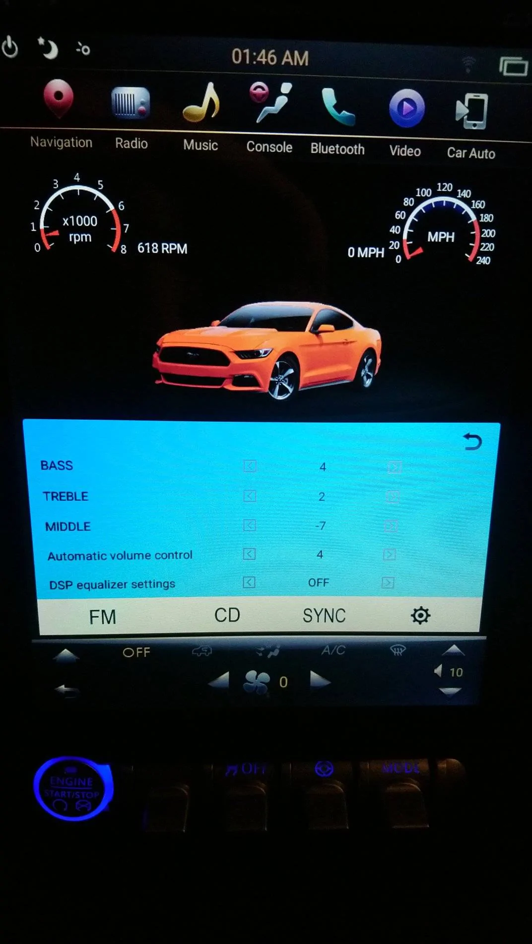

Also, in the settings, I can no longer adjust the mid-range frequency. The DSP says it changes from Rock to Classical, etc, yet no perceivable change in audio quality.
On the main radio station panel, it should have the Outside air temperature indication, and Station ID info that the Premium radio software has. Again, very amateurish. It's as if they included only the basics, and charged a premium for it.
You would think Phoenix would go through these with a fine tooth comb to make sure all the programming is functional. I paid the same price as the premium radio, and got less in a product. They need to rectify this IMMEDIATELY!!!
Middle range adjustment on the EQ is at -7, and is non-functional.

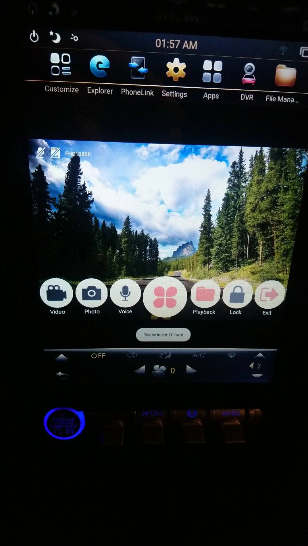

Next, the HD dash camera. This camera is turning out to be a complete waste of money. I installed it several times now, and no matter what I do, the camera will not start and record video each time I shut off the car and start up again.
Every time I start the car, the app will not show video and says it has no SD card installed, which it has a brand new one that I tested in my other camera, and works fine. It is a Samsung Pro Endurance card that is the best for recording video. If only the camera worked.
The only way to get the camera to record video, is to reach under the dash and unplug/plug in the USB connection every single time I start the car. Otherwise, no go. It's just a cheap nuisance. I am very disappointed in this dash cam.
The pic of the forested road is default and it keeps saying to install a tf card. It just won't boot up properly after turning off the car.
UPDATE: I plugged the camera into the other provided USB cable port (there's 2 USB cables), and after rebooting the radio, it started working. I will have to do this a few more times to see if ti still keeps working as it should.

OK, another update.
After switching the HD Dash Camera to the other USB port, it now appears to be working as it should. I'll just use the other port for loading pics and such.
