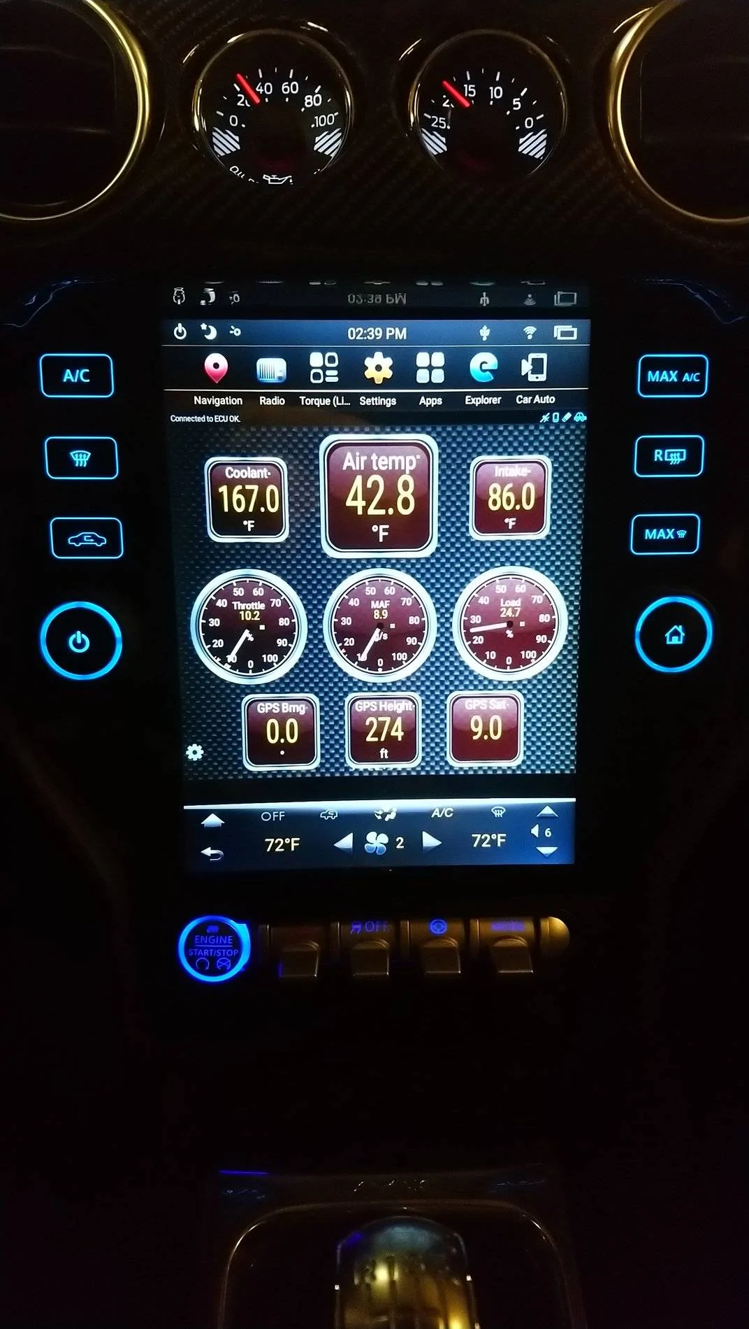

I have a question about the obd2 port... I have an ngauge tuner plugged in there that I do not want to remove and I like having it plugged in... is this possibe woith this unit ? is it possible to have 2 things plugged into the obd2 port with a split adapter or something?Update: For all those who have complained about losing Outside Ambient Air Temperature (including me), it is available to be read by the Torque Lite OBDII App available for free on Google Play. I got the OBDII "vertical screen" reader from Phoenix when I purchased the head unit, and finally got around to installing it. It works very well, and I find myself using it quite often when driving. Especially since the screen is not as bright as having the radio software glaring in my eyes with bright blue at night.
The App itself is very simple to use, only takes up about 5MB of memory, and loads very fast when you start it. All data pops right up within seconds of starting the car. It's quite good for being a free app.
About the only downside, is I have to manually start the App when starting the car to bring it up. So, to make that easier, I programmed the custom app launch button next to the radio icon to start Torque Lite. Hmmmm.....If only I could get the head unit to start this app automatically on startup.
does the wifi obd2 reader still plug into the obd2 port?Yes, the drive modes with the toggle switches on the bottom still work the same. Some have said they have issues with their traction control, but my base model shuts off traction control with no issues. The color of the car on the screen is always orange. You can install a picture over the top of it to get something else. I installed just a basic Mustang emblem and got rid of the silly MPH and RPM gauges, since they are on the dash to begin with. There is a YouTuibe video showing how to do this.
On the base models, the outside air temperature is shown on the Sync-1 stereo/center head unit, not the drivers dash. So, it is lost when you install a new head unit. However, I installed a wi-fi ELM-327 OBDII reader and Torque Lite app which has the outside air temp. I posted a pic of this on Page-4 of this thread. In your case (Premium model), if outside air temp is already on the drivers dash, then you have nothing to worry about. It will stay there as always.
Yes, it plugs into the OBD2 port, and I would think if you got some kind of splitter, it may interfere with the readings and data used by the Ngauge.does the wifi obd2 reader still plug into the obd2 port?
