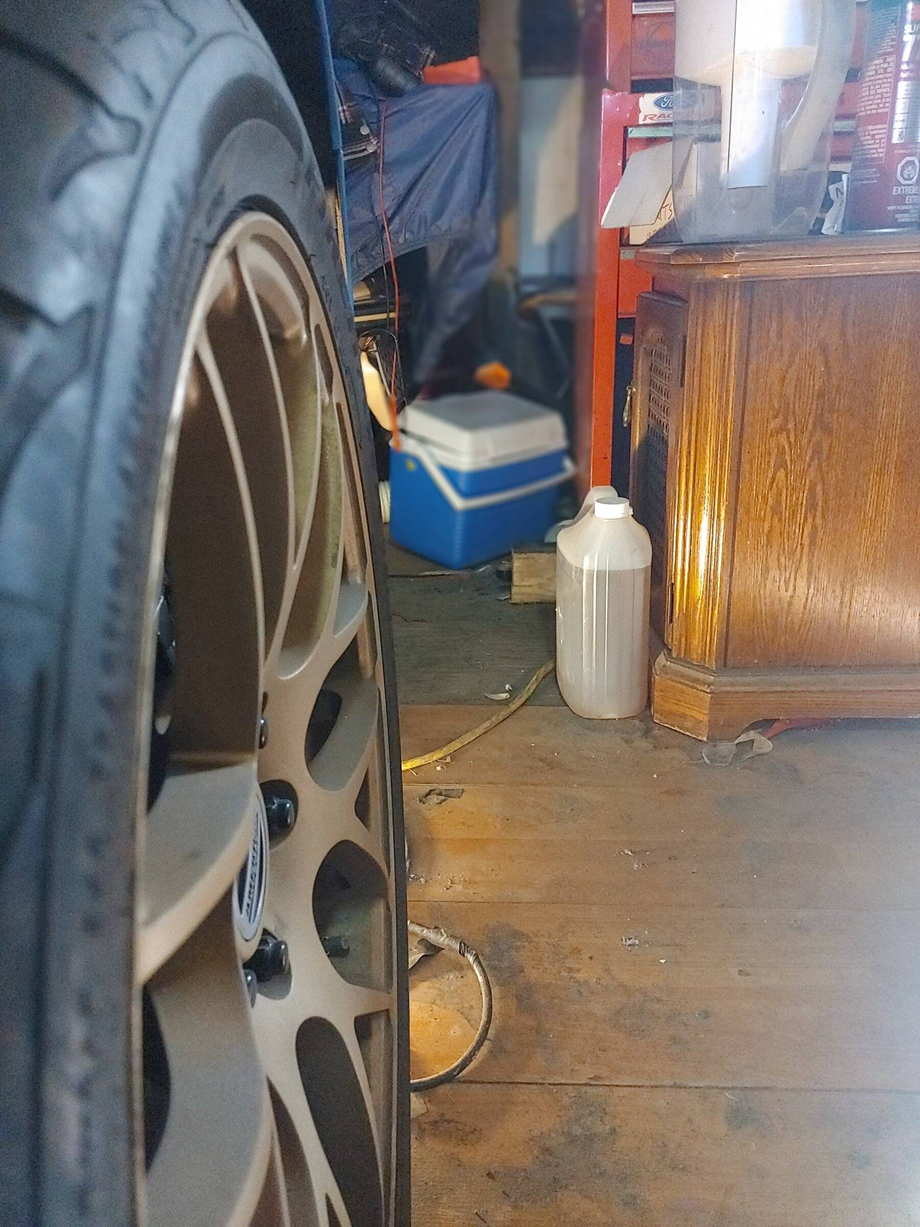

Hm, I have to check that. I have to get a new set of tires soon. If this is possible without any problems (TÜV Gutachten) I am definitely willing to go bigger. 😃
Here's a 325/30r19 firehawk indy 500 on a 19×10 rim. Barley any bulge.
