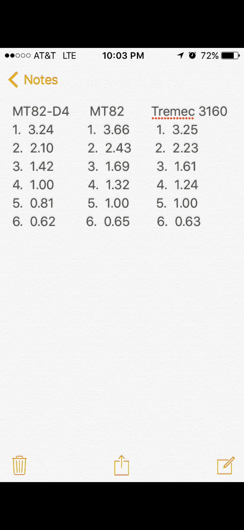

Other than 1st, the gaps are really across all gears, not necessarily 3rd and 4th. To me, the D4 gearing is better suited for the street, not so much for the track. Although, it is nice being able to trap the 1320 in 3rd with the D4 and save that shift.
Well that explains why 5th pulls so much better. I thought the Tremec was also a double overdrive but I see now that 5th is 1:1
Looking at the chart, I swear 1st and 2nd are much shorter in the new car but the chart shows 1st being identical and 2nd being very close...
Yes, 5th in the D4 is a great highway gear unless youā€˜re just on a long haul and need the overdrive for cruising. I rarely use 6th.
How do I know if I have the mt82 or the mt82-d4? I didn’t know there was a second one besides tremec
