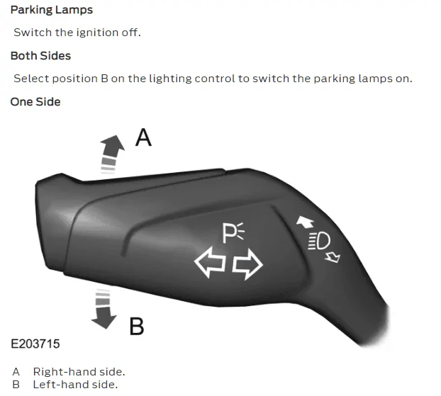

I had stopped and parked, and locked the car, 2017 GT Australian model. Light switch setting is on automatic so DRLs operate. On my return to the vehicle 30minutes later I see that one parking light is illuminated. I found that I had accidently bumped the indicator stalk up on leaving the vehicle, which for some reason lit up the corresponding parking light bulb. I repeated this for both sides to convince myself that I wasn't going mad, and it happens on both sides. I can't imagine why this is a feature, or whether it may eventually time out. Anyone else heard of this?

Yes, it's a feature. I've seen it in other Ford vehicles as well.
I believe it's mentioned in the user's manual. I'll see if I can find the relevant section.
Edit: strangely enough, it doesn't seem to be in the Mustang's manual. I did, however, find it in the user's manual for the Mondeo. I'm sure it works the same in the Mustang; they must have just forgotten to mention it.

Yeah, that's one of the reasons they're called "parking lamps". When you park on the side of a street you can turn on your outside parking lamp to make your car more visible to traffic. It actually looks pretty cool when you have a lot of cars doing it.
Seems to be (or maybe was) a more common practice in Europe than in the US, maybe due to narrower twisty streets, etc. All the BMWs I owned did it. Not sure my US spec Mustang will do it, but I'll check when it's not 4*F (-15C).

For when parking on street or side of a road and it is foggy out, to keep others from seeing your parked car after it is too late.
