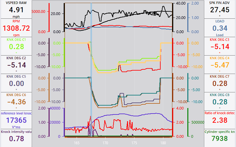

There's this Whipple phenomenon where the supercharger sets off the knock sensors in the 1000-2000 rpm light-throttle acceleration from a dead stop. The Whipple remedy is to limit knock retard to .5 deg at that load and speed range. I decided I didn't like that solution so I started using PCMTec to try to find a better solution. What I learned is just how little I knew about how the knock sensing works on these.
PCMTec allows you to log dozens of parameters that lead up to knock retard, not just raw per cylinder retard.
Apparently, the PCM is always calculating a "reference level", or a rolling average vibration from the engine. There is a running "knock integration" that represents the current level of vibration. It then divides the knock integration by the reference level to determine a ratio. When this ratio exceeds the "knock threshold" in the tune, it is interpreted as knock. The "knock intensity" is the ratio minus the knock threshold. The knock intensity is used to determine the amount of timing removed, which comes from another table in the tune.
I was able to catch the whipple SC rattle in a log and you can see the knock reference level, knock ratio, and intensity. This is false knock, but still a good graphic showing how the algorithms work.

you going to adjust the threshold?
I’ve been contemplating this. With the peak knock ratio being under 3, threshold at around 2, and the intensity, being ~2.x - 2, ranges from 0 to 0.8, I understand my options.
The problem with limiting knock retard is fairly obvious. The problem with simply raising the threshold is that it not only makes the pcm blind to light knock, but also reduces the reaction to it since the calculated intensity will be less as well.
I see two options now: 1) increase the threshold but also increase the kr amount once the threshold is met. Eg raise threshold from 2 to 3 and then increase the amount from 1.25 to 2.5 at 0.0 intensity. 2) reduce the amount to 0 at 0-1 intensity. This would have the same effect but leave the ratio and intensity data and calcs the same as they are now.
I initially attempted to raise the reference level (through constants) because that would be technically correct but then learned that the rattle starts suddenly so even at higher reference levels it still shows as a spike in ratio.
assuming you are on e still. whats map during this event? wonder if the bypass closing is adding to this.
Speed is 1000-2000 rpm and load is typically .3-.4. It’s the same speed and load as cruise so I don’t want to neuter my knock system. Bypass valve doesn’t close until much higher loads.
neg adding or removing spark in per cyl in the software?
Negative is retard. You can see all cylinders actually go to 10+ deg of retard when this happens. Yes it’s on e, so I know it’s false. Also, even on gas it will run steady state at the same speed and load with no trace of knock.
