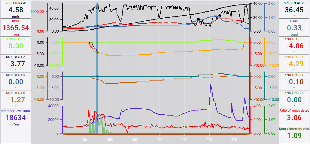

My initial attempt to remedy the issue was to reduce the timing removed as a function of knock intensity. Up to knock intensity of .5 it wasn't to pull much at all, but in the attached log you can see the intensity is 1.09 (as high as 1.5 at times). The peak KR was 6 deg, which is better than the 13 or 14 I might have otherwise experienced. Either I need to reduce KR to zero at any intensity up to 1.5, just increase the knock threshold to about 3.5 or 4, or perhaps increase the recovery rate. I tend to think the first is better because once you raise the threshold then it can't do anything with knock retard at lower spark knock ratios.

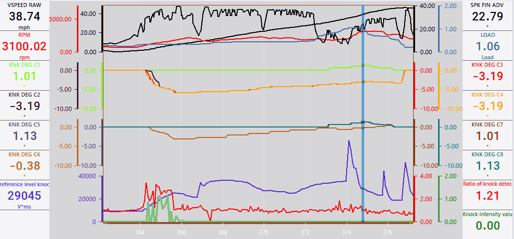

I also was able to demonstrate the "real" problem this causes. In this log, a full 10 seconds after the false KR came in, I gave it some more throttle to force an rpm and load increase, and a downshift. You can see that the 6 deg of KR had only advanced to about 3 deg of KR (keep in mind this is AFTER the cal was improved). Even going to 3100 rpm and 1.06 load AND downshifting, the KR didn't reset to zero until I let off the throttle. In the past I've seen up to 14 deg of false KR and if you go WOT just after, you might only be running 6 deg of spark.
