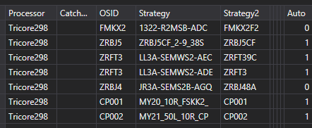

Here is a subset of the boosted operating systems that are already available via our repository and have been for several weeks. The last two are MY20/MY21 control pack strategies (NA).
Any Whipple/Roush files that we have added support for where a stock file was not sent in will not show up in our repository/calibration list, they will however be able to be licensed/edited and flashed.
This discussion is best continued on our forums, I've made a link here to list which operating system have been added.

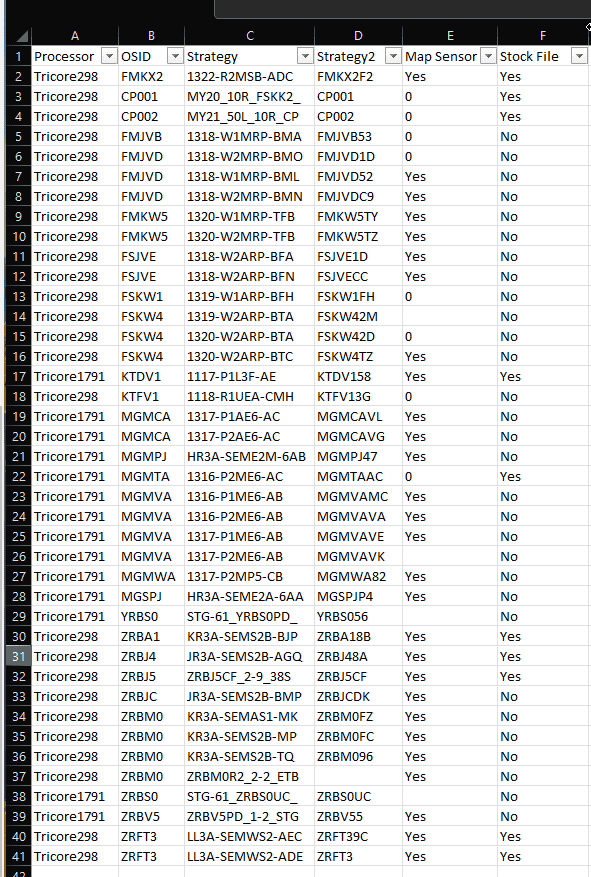

Here is a list of all the control pack/roush/whipple cals we support as of today. The files marked as "no" for stock file will not show up in the repository, you will however be able to read license them. There are 7 more Roush strategies being added as we speak which will show up in the stock file repository shortly
https://forum.pcmtec.com/topic/1835-whipple-roush-control-pack-support/
@Grimreaper Your Roush strategy has just been added and is now supported. Please be aware that Roush have obfuscated your spark tables in your specific operating system. I do not believe any other software products support this calibration for this reason. We will reply to your support ticket as well.
Please be aware that we have never advertised support for 3rd party custom operating systems. We have since clarified this on our website.
Here is a list of supported whipple/roush/ford racing strategies as of 30-08-23. You can see the Map Sensor column which indicates if the strategy has the roush harness added.

298 is gen3.
1791 is gen2.
There were no boosted gen2 strats when i posted. I think your mixing the gen3 in with the searches in the repository
Map sensor alone is not enough to locate a boosted os.
Roush gen2 is maf based, some will have baro, some will not. Added after few years of kits shipping.
Roush gen3 is Sd based from F150 structure ive been told. Map sensor and no maf
Whipple gen2 is maf based. Tunes all usually say baro sensor is presnt but have not seen one with the sensor physically present.
Whipple gen3 is maf based, gen3 ecu has built in baro sensor, have not seen whipple add additional map sensors.
