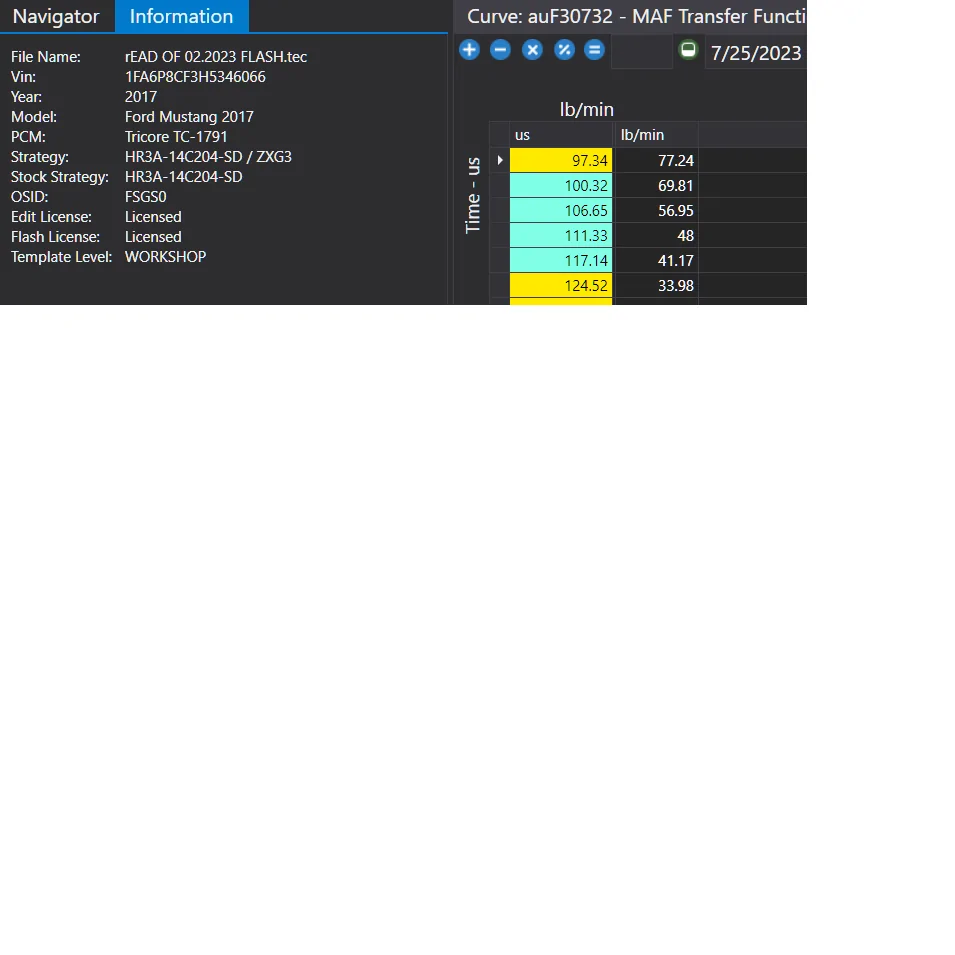

I might have to ask this at PCM's forum but has anyone figured how to transfer completed HP tunes to PCM format? I think the only way is to flash the car and then read with PCM.
Flash with HPT and read with PCMTEC…
BUT
Unless you have the Workshop package, or you have a template from the company, you won’t be able to see the data unless you license it. That’s how I understand it from everything I’ve read and done.
Just got back from the shop. It is HUMID. Anyway I flashed one of my race tunes written with HPT. I then read it with PCM and it kept my license.
So my worries are over. Also like Roland said I do have the ability to turn on my o2 sensor, this race tune has them turned off.
So you were able to see the data without licensing it?

It is still using the license from when I licensed my car.
Understood. Wasn’t sure if you’d licensed it or not. That’s great to know.
So as I understand it then: you’ve licensed your car/OS in PCMTEC, edited that file in HPT, flashed it with HPT, re-read it with PCMTEC, and were able to view/edit that file in PCMTEC under the same license for that car/OS/etc?
No.
I read and licensed my car with PCMtec
Then I flashed the car with a race tune I created in HPtuners (flashed with HP)
I then read it with PCMtec and it retained my PCMtec license.
For me this is huge. If it did not keep the license I would have to manually redo several tunes.
