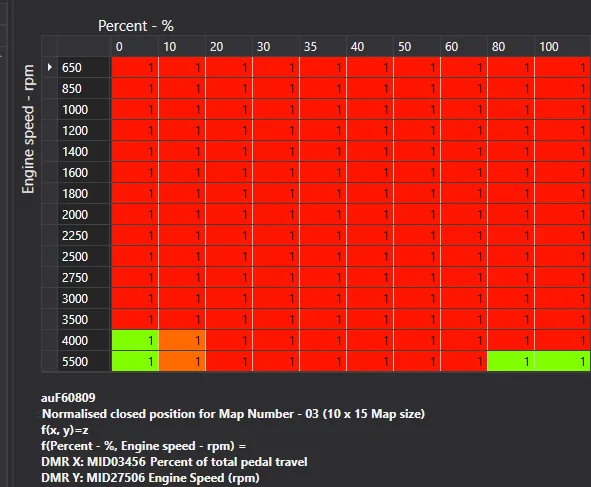

Been playing with the data logger. Looks like we can log any parameter we can modify. The speed density channels look interesting. Might be able to dial in manifolds better.
I've only been at if for a short time but haven't been able to find the line logging feature.
When datalogging you can look at the exact DMR that the X and Y axis use (not all tables, but most). This way if something says load, it might actually be inferred load due to anticpation logic (eg 1st gear revving very fast) and logging the standard SAE load value is not actually what is being used. This way you can be 100% sure you are logging the correct values.
Eg for the active exhaust you might see % and go "what percent". If you look down the bottom you can see the exact DMR to log to properly trace and calibrate this table. Simply type in MID03456 into the datalogger to log that value.
