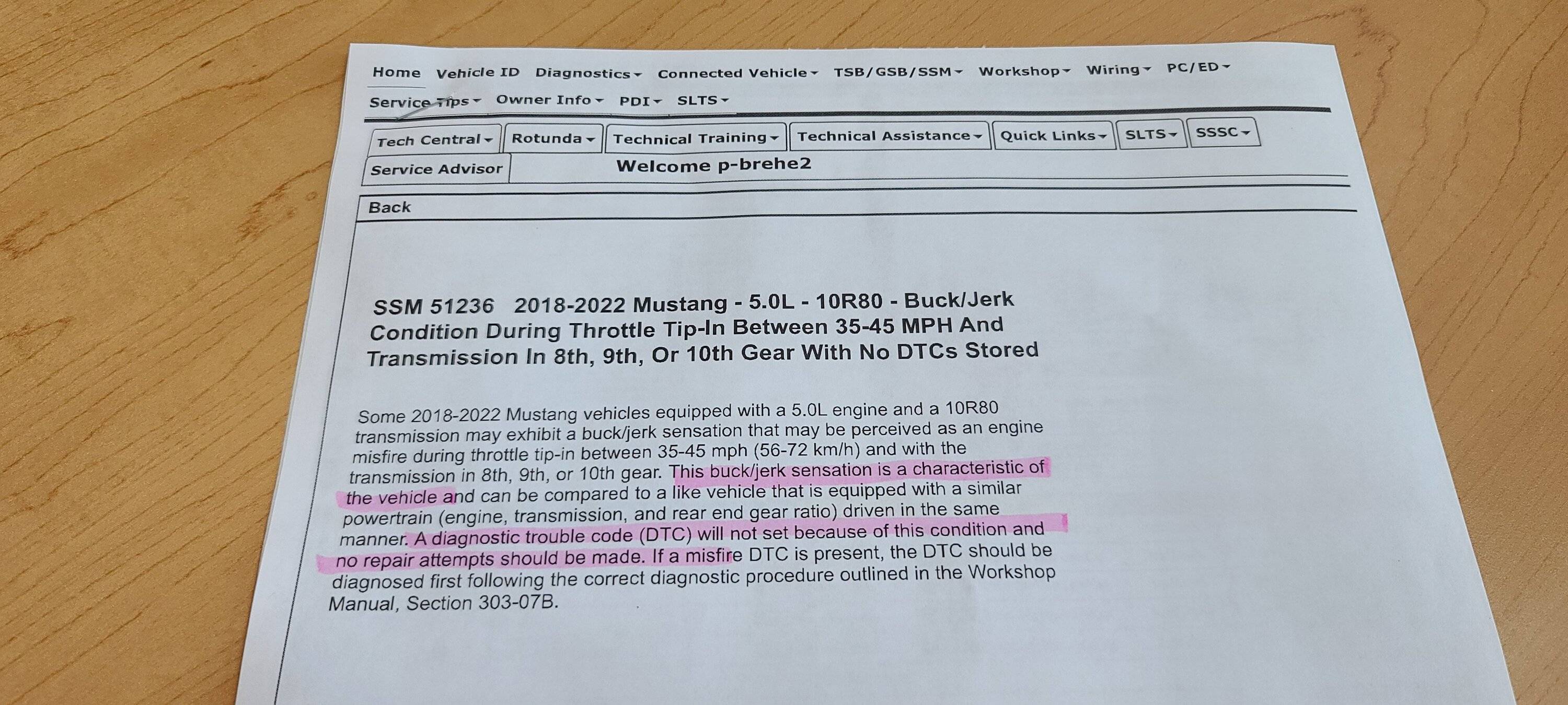

Read the whole SSM . It also states to compare to like vehicle . Witch they did not highlight. Time to go find a like vehicle .

That’s just the nature of the 10r80. Not a smooth transmission at all. If it was a misfire you’d see P0300 or P0308 codes. If you’re so inclined just buy and install new spark plugs or coils. But the only way to “solve” this is to buy a Porsche with a PDK, a BMW with a DCT, or trade for a manual mustang.
