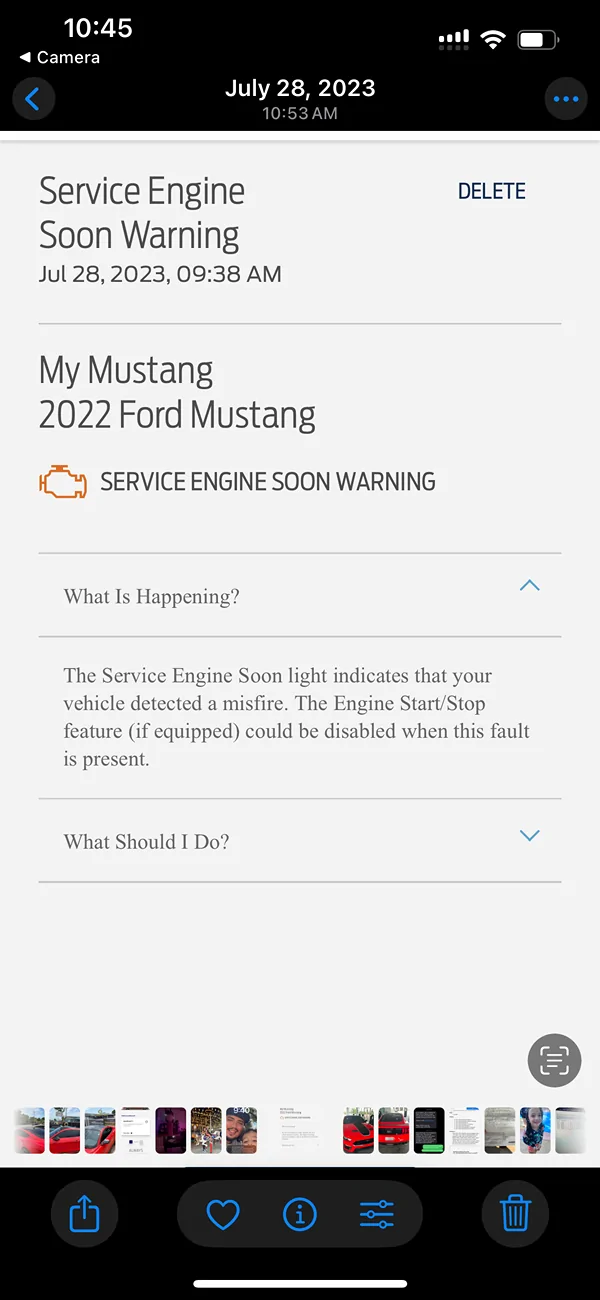

As soon as I let the clutch out and gave the car some throttle, I could easily feel a misfire.
The check engine light illuminated solid, and the engine started getting very rough. I was about 1 minute from my house, so I slowed down and kept driving.
The check engine light then started flashing, indicating a very bad misfire and potential damage to the cats due to unburnt fuel. This was confirmed by my AFR numbers on the dash; when giving the throttle, my AFR sat around 15 or 16 which is highly abnormal.
Once I got home, I grabbed the codes off the PCM and found 2 pending codes: P0303 and P0303-00, both indicating a misfire on cylinder 3.
