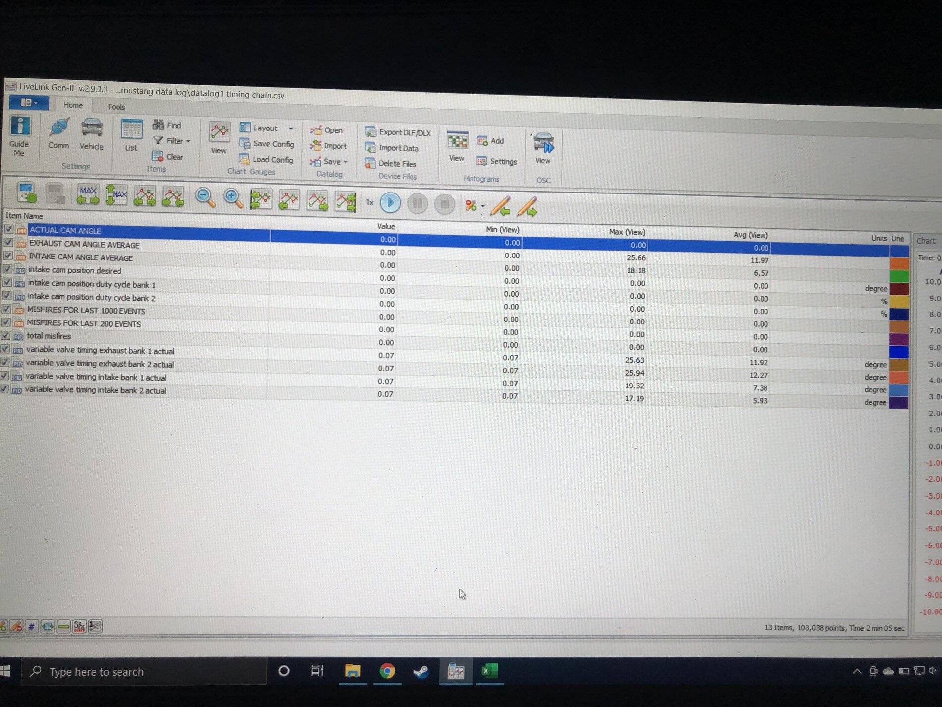

ok I did some data logging at idle to check my timing for the P0019 code. Does it look off ? I’m not even 100% sure if I even data log the right stuff. Thanks !

Did you do a crank relearn? When I installed my whipple and didn't touch the OPGs I got some sort of code and had to do a crank relearn and then all was good.
not yet. I’ll try it on my lunch brake and report back
