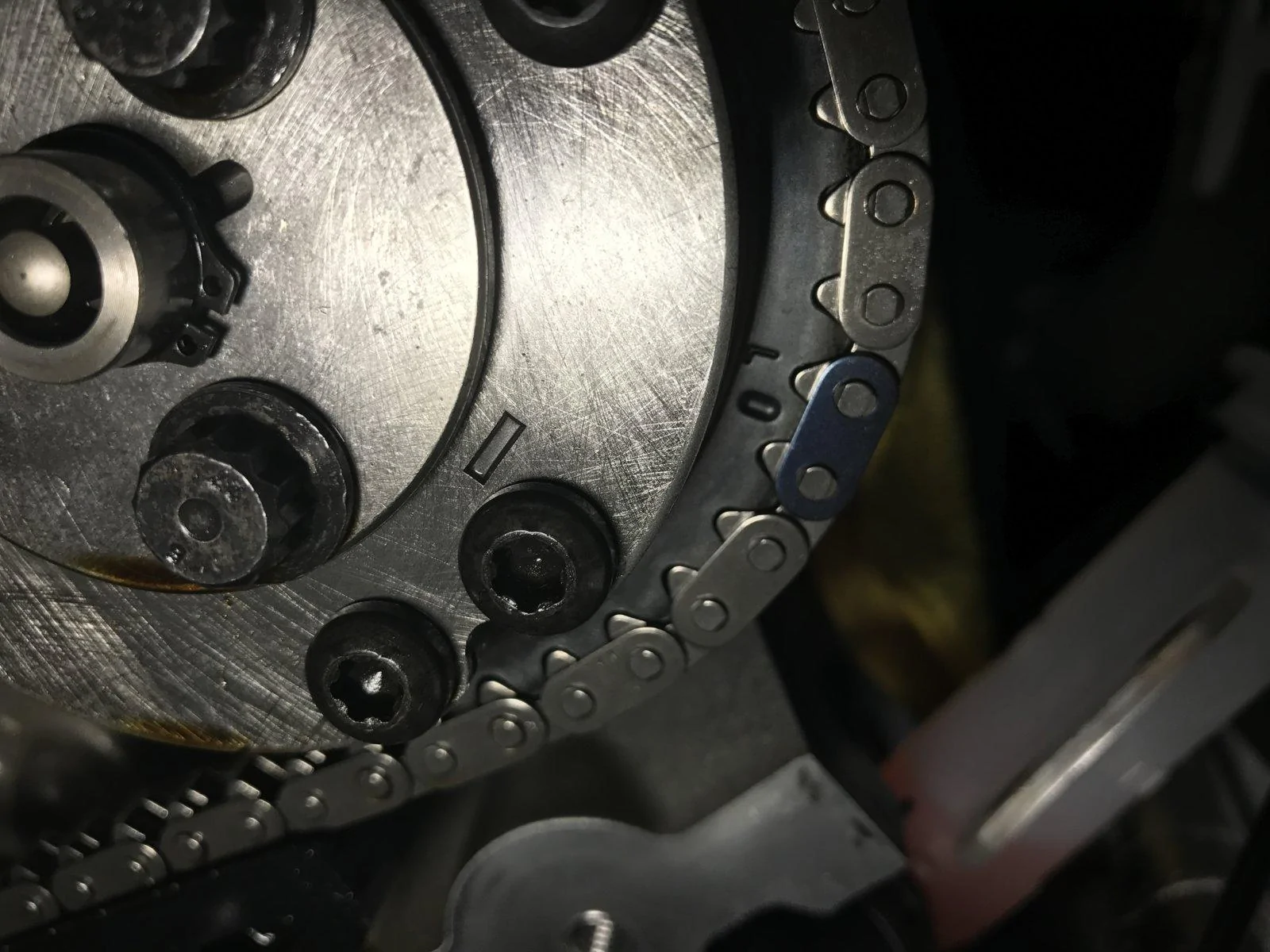

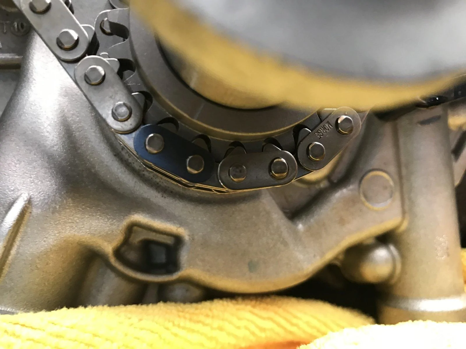

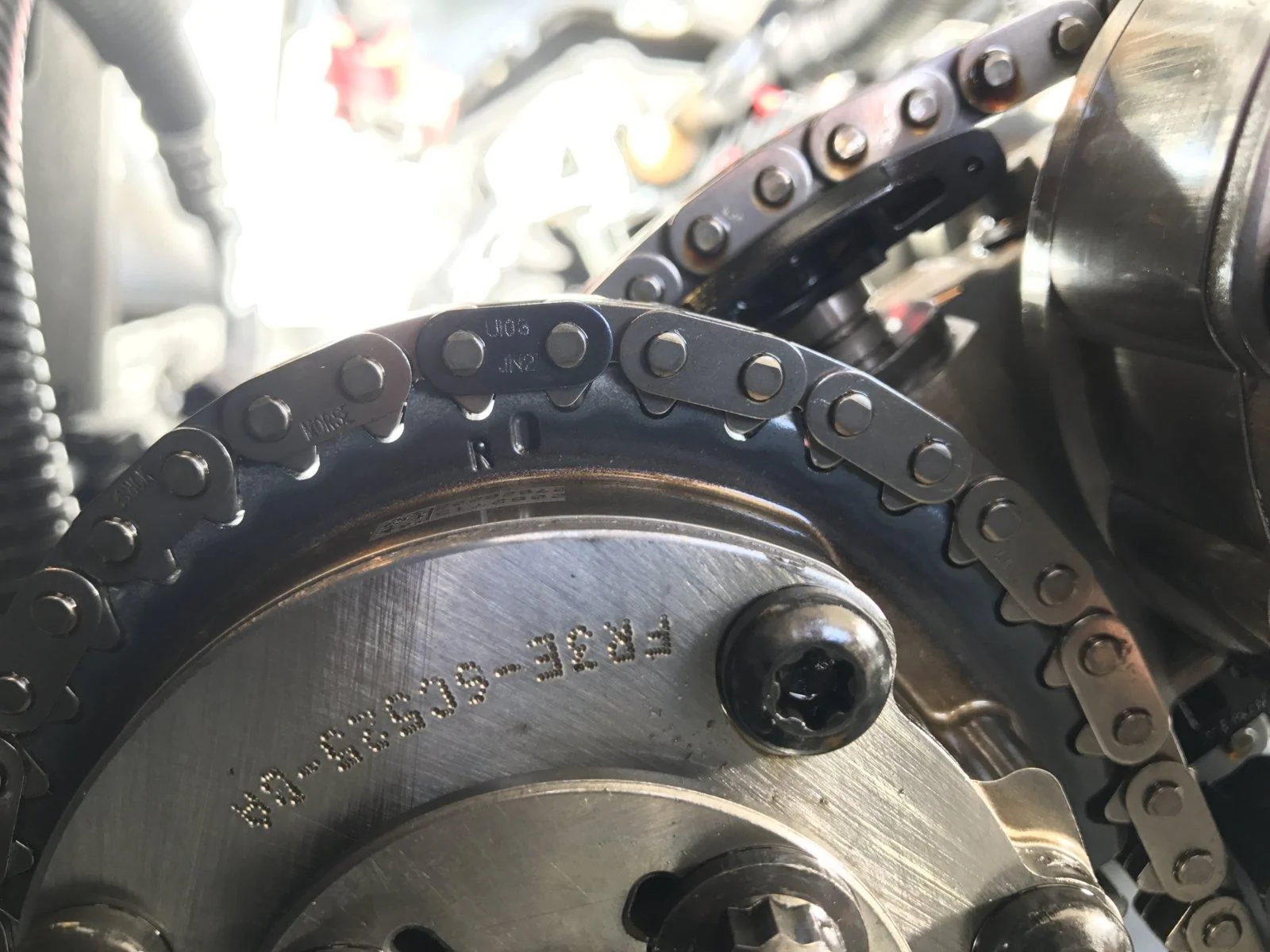

No reason you can’t using your own index marks. If you make any adjustments, to take tension off as an example, you run the risk of coming out of timing but should still be able to make corrections. I’ve done it the Ford way 5 times on different builds and it’s never been an issue. Using the shadow links makes me question nothing.
