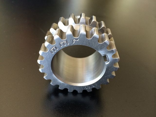

I understand all the specifics behind E85. It is much more knock resistant than 91 octane. My point is at 3000 RPM on E85 and 16 degrees of timing the detonation explanation for breaking timing gears is not what happened in my case.
I also had a twin pump fuel system so no way in hell it was lean. I have several data logs that show how dialed in the tune was.

I have 75 plus WOT logs from both cars and 600 plus from 3 previous coyotes.
Look at the MMR gear. Mine broke right on the key way. Look how thin it is and then imagine it spinning at 7500. That is why I have Billet gears.
For the purpose of science do you mind sharing one of the logs that was closest to the failure event on datazap.me?

Its Lund tuned in person by KenB. The tune is spot on.
Reds I don't think anyone is doubting your gear broke and that you experienced the absolute worst case scenario, but why it happened ??? Look... of course it's cheap insurance to anyone racing and bumping of the the rev limiter and such to replace. But you are kinda implying that hey, this could happen to anyone even at 3k, it's a ticking time bomb!
Hundreds and hundreds are running without with no issues, Travis at boost works says he has done in the hundreds over 5 years without failure.
Again not saying your wrong, and it didn't happen to you at 3k, but possibly when you were racing along the way and from reading you broke other parts trans year end and such, maybe the gear got damaged earlier. :shrug:

I am just informing everyone of exactly what happened so they can make their own decision. The Whipple American Muscle car had the exact same issue.
As I said earlier I have had 3 other 650+ coyotes and only installed the oil pump gears and used the stock timing gear with no problems. I assumed the timing gear was fine just like everyone else until it happened to me.
