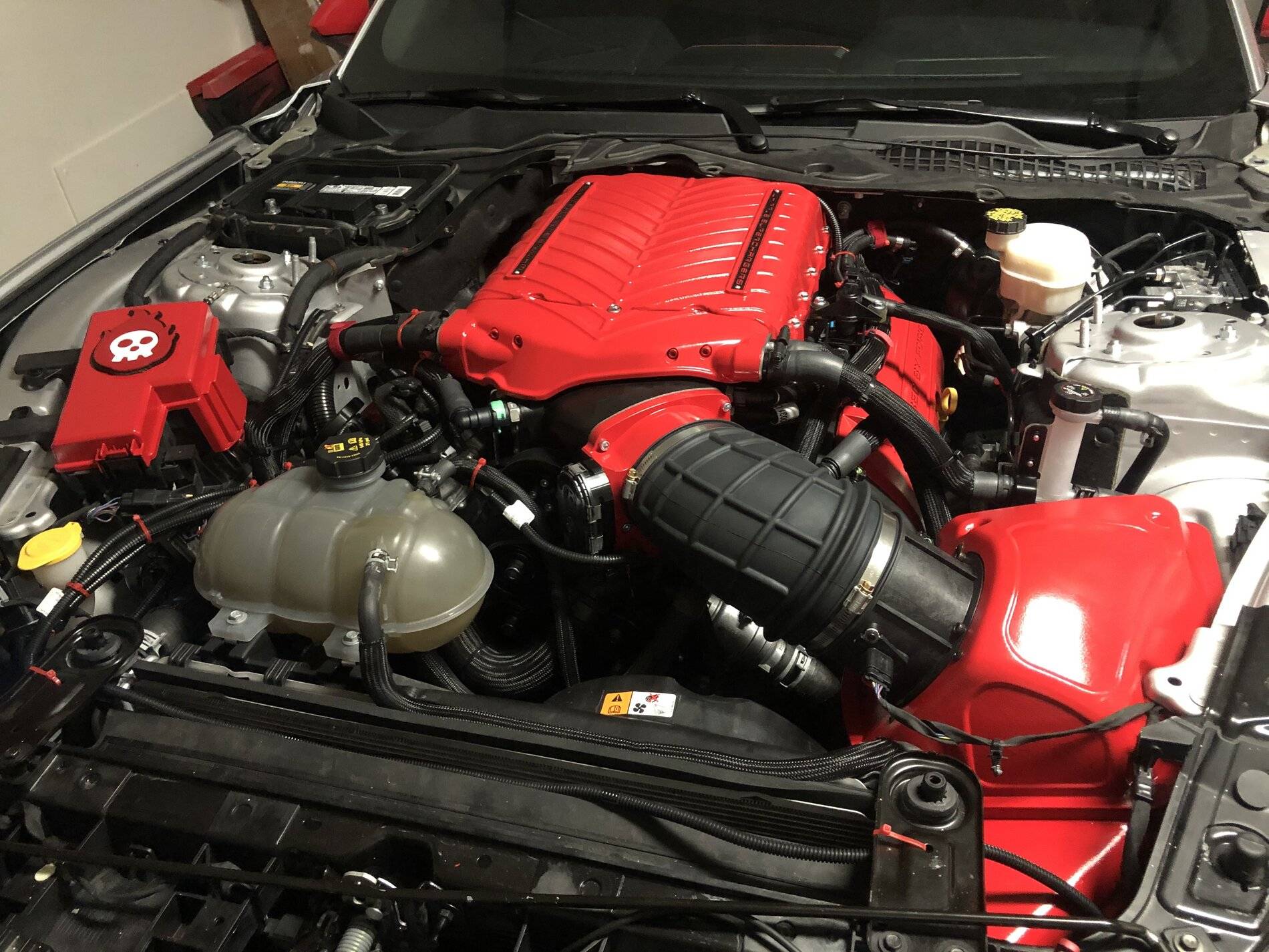

Before I get started. I’ve did a lot of research And figured that I might of mistimed the timing chains when doing my OPG install. But I feel like it could be something else well...
So I did my whipple gen 5 install afterwards.(pic below). So the thought of tearing this whole thing down again to fix the timing is daunting and I want to make sure I go through all possibilities first

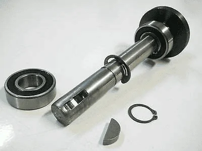

It sounds like your key might be missing from your crankshaft. If that is the case then your timing will be wonky because your timing gear uses the same key as your pulley. I definitely would not turn the engine at all until you can verify if the key is in there. Your pistons could hit an open intake valve depending on how much they open.
what is this “key” you speak of. What does it look like ? Bare with me. First time doing a big install like this. So I’m still learning. Thanks

The key is what sits in the slot in the shaft. It locks the pulley in place. It's the half round thing in this generic pic
not 100% sure if I’m following. But wouldn’t I not be able to drive my car if that was the case ? But basically. The balancer turns fine. It’s just when I try to take the bolt off. The harmonic balancer just turns left. I don’t remember seeing this key when I took everything off.

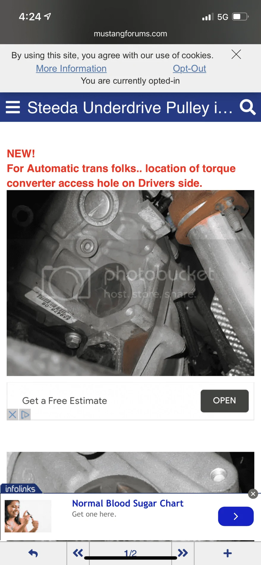

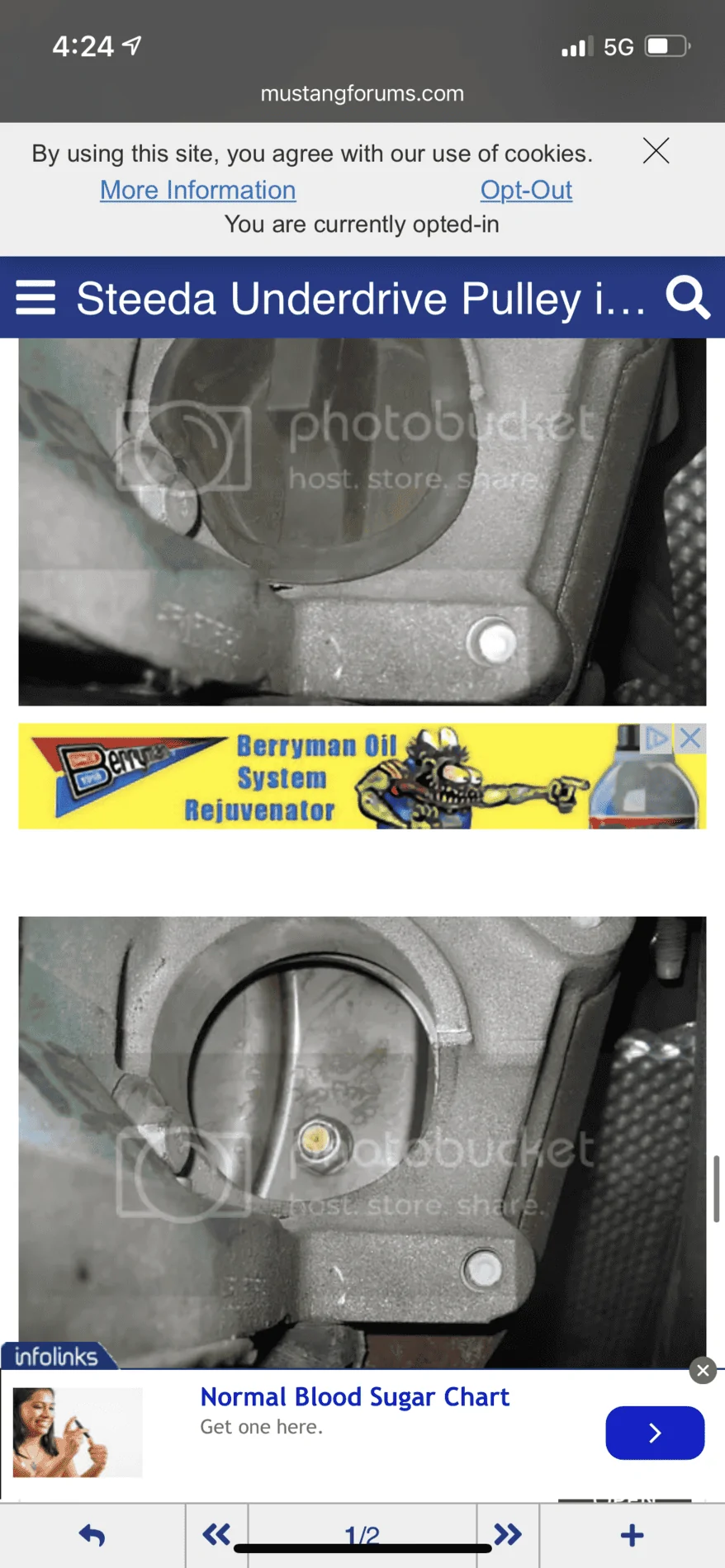

If you have an auto you’ll need to hold the bolt on the trans (specifically the torque converter) to prevent your crank bolt / balancer from moving when you remove it. It’s not a missing keyway issue the auto will just spin so impact or torque gun or you pop the cover under the drivers side and get a wrench on the bolt. What does your balancer look like, meaning is there a gap? I would pull it apart and retime personally. I’m literally doing this install as we speak so message me with any questions
Yea. It looks like it’s a small gap in there. Very minimum of anything. But I’m almost certain there is one.
would my impact not make it spinn ? Sounds silly. But was just wondering. Lol
