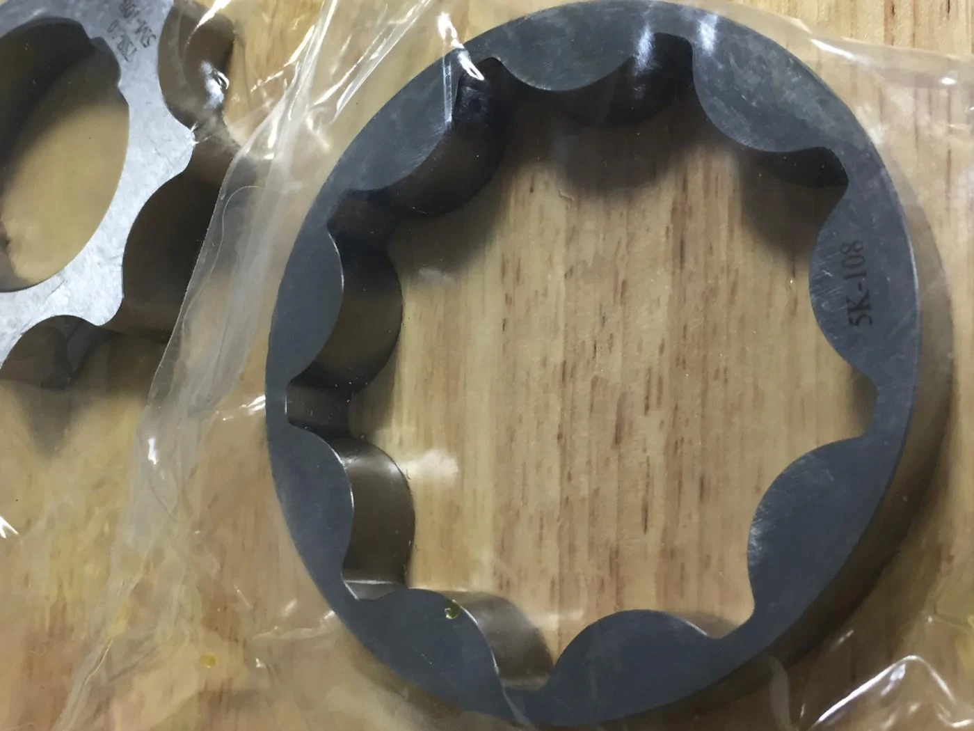

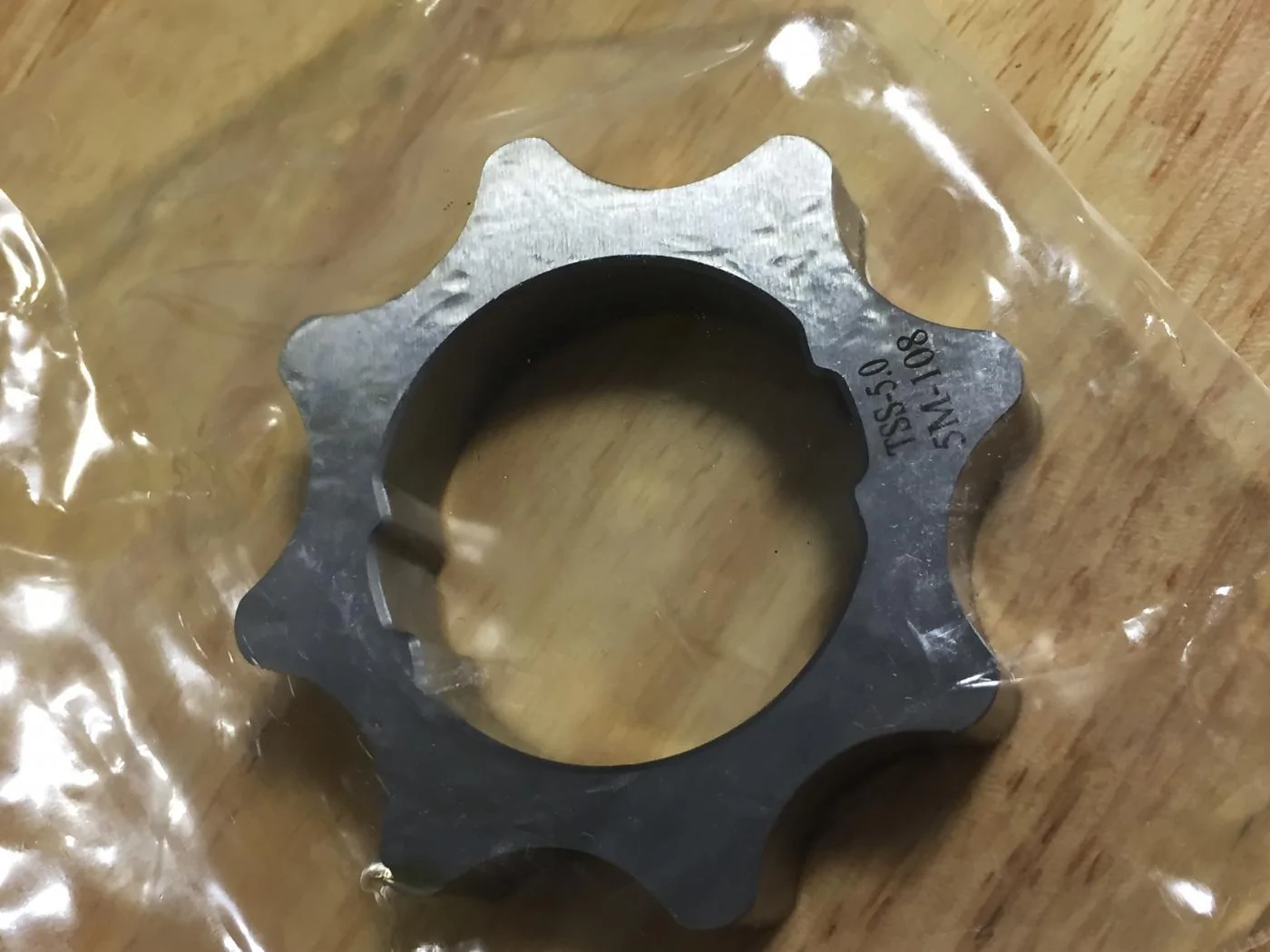

See pics of TSS OPG the laser P/N etching is the only outward appearence that differentiates it from a factory part. Emory cloth can take that off and it looks stock.
Installing the part will leave evidence that the engine has been worked on.

Just replace the ***** with the website name..
drkmrkiv said: ↑
Take a look at TSS oil pump gears. Their gears have much tighter tolerances than MMR's pieces and have read their gears are 'better' quality.
MMR:
This is 100% false!! Have you measured a MMR gear VS a TSS gear personally ? We assume by your statement "have read" that the answer is NO. I read on the internet that the world was going to end last december....
The MMR gears are machined on a state of the art CNC machine, the TSS gears are wire cut. If the TSS gears were so Precise, why would they list on their own website that they hand match sets - it simple - because they are not precise - do you think hand matching is more precise than CNC machining....
The MMR Billet gears are the best in the industry, they are the only gear proven over 1500HP and are used in all of the TOP coyote's in the country including the Hellion racecar that just WON the coyote modified class.
Please dont post information unless you personally have done the homework, (not what somebody or a competitor told you) the internet is already full of mis-information and misleading posts as it is.
And to clarify, the TSS gears may be a decent part, but they are certainly not better than the MMR gear by way of manufacturing and tolerance as you have posted. Our company has never put down another competitors parts to sell something and we feel it is unprofessional that someone needed to make this up to sell their product-this is not the way we have or will ever do business.
