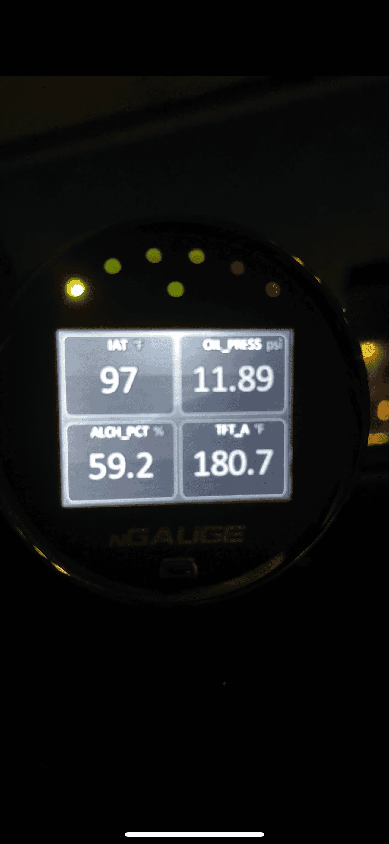

Posted to my Facebook the other day and everyone is losing their minds. I thought this was normal? It’s at idle, in gear and very warm (thanks to traffic) 205-ish degrees. I’ve seen 12-15 in that situation before. I’m running ford 5w-20 and a Ford filter that’s only a few months old with maybe 500 miles on it, mostly sat over winter.
tell Me this is fine, and the internet is just misinformed. I’ve tried searching, and all that mainly comes up is catch can stuff…

I have a 2021 and run 5W30 and my oil pressure is between 15 and 20 psi when it is hot.

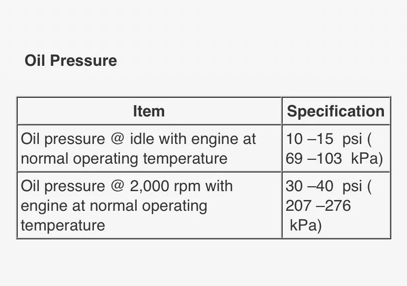

I've posted this before in other oil PSI threads.... so here's a repeat.
Oil PSI will change based on multiple conditions.
Oil PSI in ANY engine is always dependent upon operating temps, oil viscosity and SPEED/RPM. It's also dependent on extremely high tolerances built into these modern engines. Engines of days past (push rod engines) had "loose" tolerances and less internal parts where oil psi wasn't as high as seen in today's modern engines where build tolerances and specs are very "tight" and "close".
Also to note (for those not understanding oil psi or seeing such readings):
High oil psi upon initial startup is normal in every vehicle. The oil viscosity is thicker due to it sitting and dependent upon exterior seasonal temps (whether in a a garage or not). The colder the engine block, the thicker the oil will be, then as it warms up viscosity changes (thins out). As the oil does thin out and based on idle/speed/rpm/internal temps, yes the PSI will show lower readings. HOWEVER whether hot or cold, as long as those readings are within spec, there is NO concern.
Not every single Coyote is going to read the same oil psi @ X-interval (speed/rpm/idle) or at X-temps with X-viscosity, they just won't. Will they be within +/- 5-10psi of say the Ford spec, YES.
The oil psi specs below is for a bone stock S550 Coyote 5.0 right from Ford:
That above charted PSI info is also based upon the standard recommended oil for the 5.0 Coyote.
Here was an older thread regarding oil psi:
https://www.mustang6g.com/forums/threads/2018-mustang-gt-15-psi-oil-pressure-normal.109015/
For those just using the stock analog factory PP oil psi gauge in center dash pod above the center console stack, IMO, Ford should have designed that oil psi gauge with better increments.
Your oil psi reading is spot on. Tell the FakeBook idiots they need to be schooled. Morons.

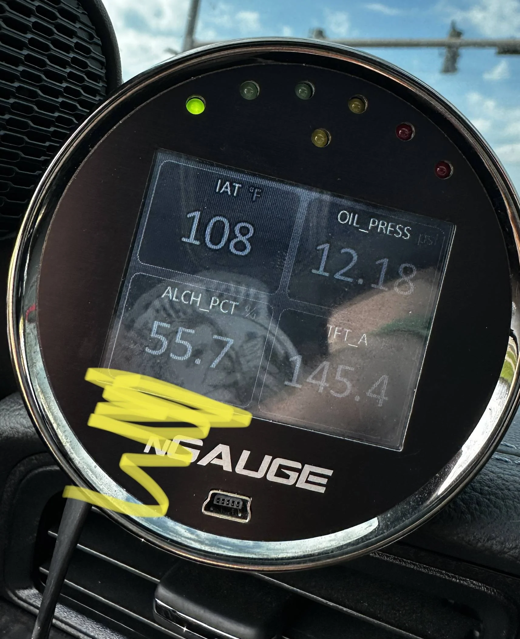

Irony. Changed oil today because I couldn’t get the gremlins out of my head. Old oil looked brand new, and smelled fine. Put Mobil 1 5w-40 in it to see if pressure changed.. this is after a 25 mile drive in and out of traffic. 😂
