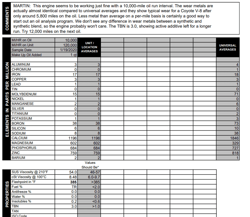

I always use motorcraft synthetic blend and never had issues. My 14 Coyote bought new had Synthetic blend from day one every 10K miles and my engine was mint. 1 Quart per 10K miles, ran like a champ. Had oil analysis at 120K miles with 10K miles on oil, the results speak for themselves below:
Do you know what percentage of synthetic need to in it to be able to be called “synthetic blend “ ?
Well, there is no regulations and therefore you could have less than 1% synthetic and be legally called synthetic blend
Once again nothing more than bs marketing in order to maximize profit
Either get regular oil or full synthetic, that is the only way to know what you are getting and paying for

Look I am just sharing my positive experience with the factory recommended synthetic blend oil. I could care less what the percentage is.
I have used it on other Fords as well, never had an issue. What wears engines is lack of oil changes and running them low on oil. Most of the well known oil manufacturers meet or exceed factory recommendations.
