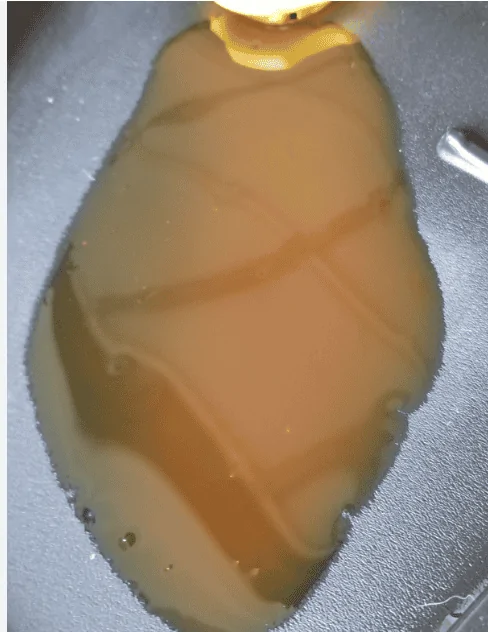

I have yet to change my oil after the first time I added Ceratec, does anyone have a picture of how milky the oil is? Just wondering what I should expect :)

Adding ceratec makes the oil look like brown coffee with a lot of cream or milk in it. Same kind of color. Lighter than typical hot chocolate. Anyone who sees it will notice it for sure. I would not want a dealer to see it just to avoid the inevitable hassle they will start If they have a bee in their bonnet over it.
That said it cured the tick on a friends 2014 GT, night and day difference. I was around that car a lot, drove it myself many times. He actually got .5 more indicated MPG on the gauges doing the same routes to work. I know I know, that's not scientific, but he had the car for long after and swears it was .5 MPG+ different after the Ceratec.
The oil will look like this:
