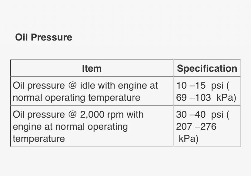

Oil PSI will "peg" based on RPM conditions.
High oil psi upon initial startup is normal in every vehicle. The oil viscosity is thicker due to it sitting and dependent upon exterior seasonal temps (whether in a a garage or not). The colder the engine block, the thicker the oil will be, then as it warms up viscosity changes (thins out).
Oil PSI in ANY engine is always dependent upon operating temps, oil viscosity and RPM.
The oil psi specs below is for a bone stock S550 Coyote 5.0 right from Ford:
That PSI info is also based upon the standard recommended oil for the 5.0 Coyote.

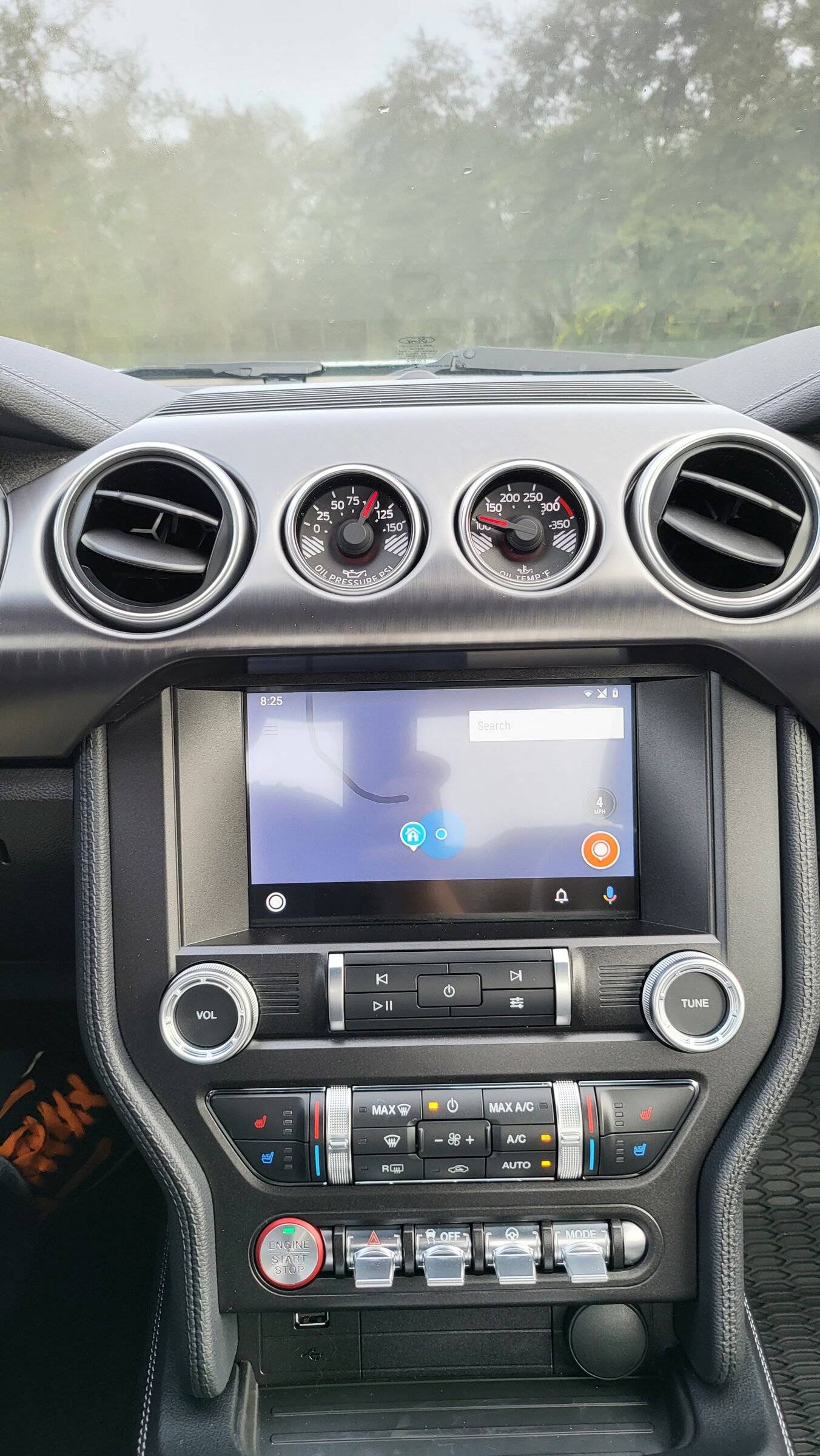

Thats why Im swapping out the factory gauges with a mechanical Autometer unit for pressure and temperature.
there are a few custom gauge manufacturers out there. would be interesting to get something made that matches the style and font of the factory gauge.
I have the autolite gauges from my previous Mach, if they look out of place It will not happen.
