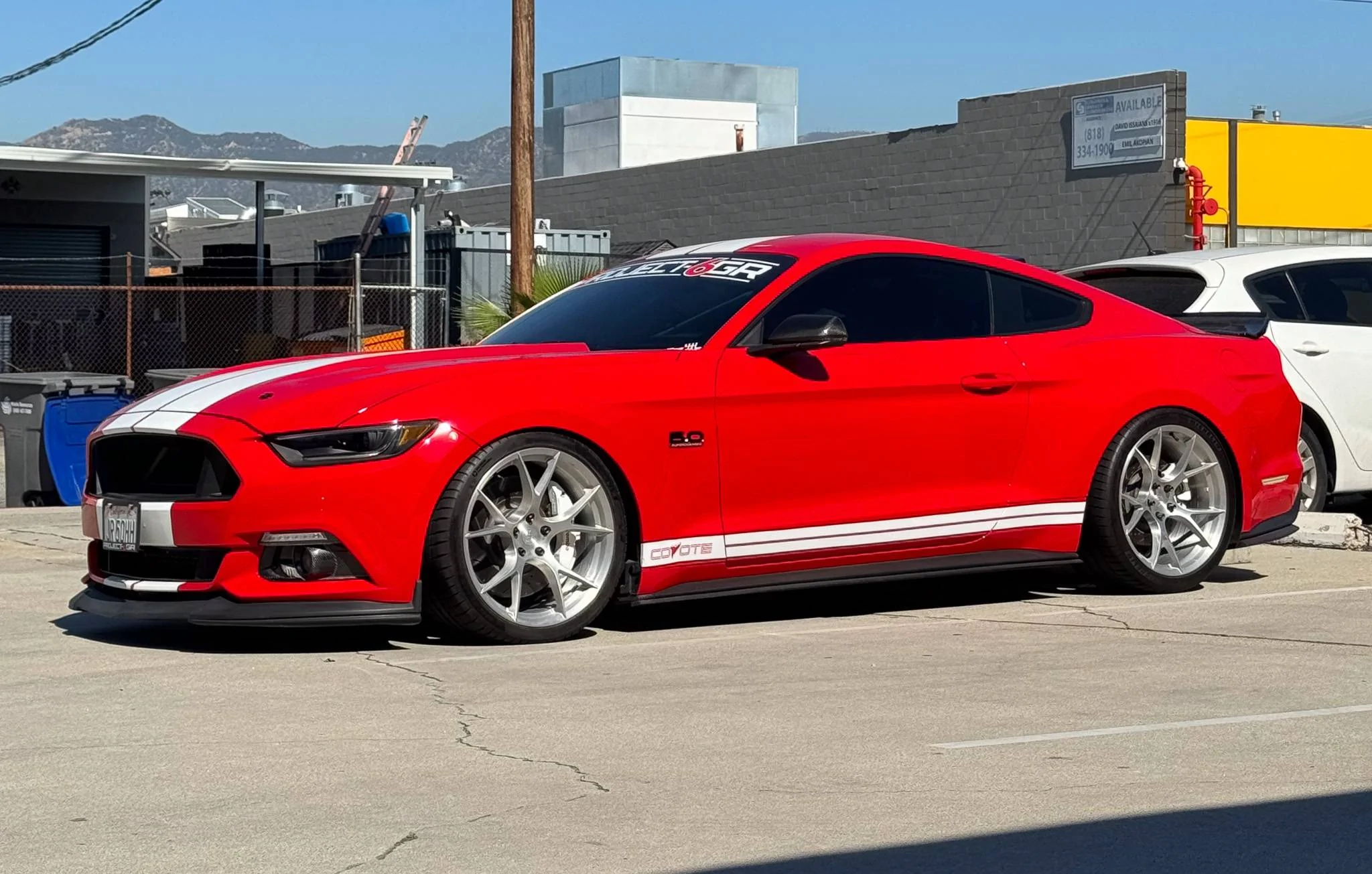

Hey guys finally got my Ohlins R&T from J&M hotpart.com with j&m camber plates and rear Shock mounts! 300f 1,000r hyperco springs.
That's a beautiful looking set of coilovers, this is Junior from N4SM. I have a set of coilovers on my car also.
