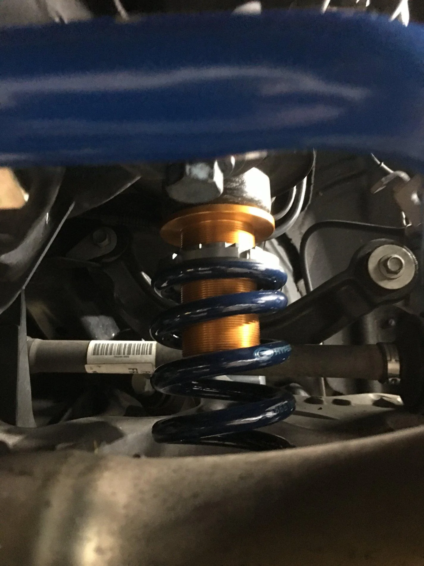

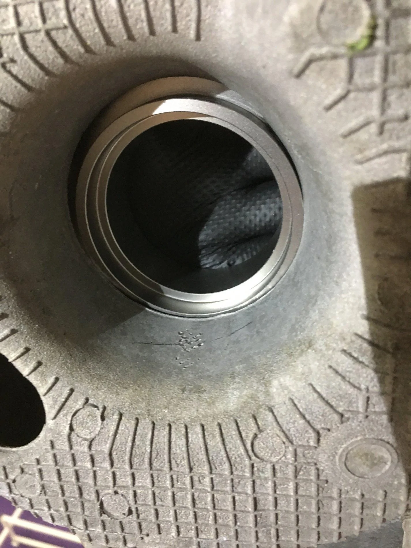

Not perfectly round spring seat pictured below

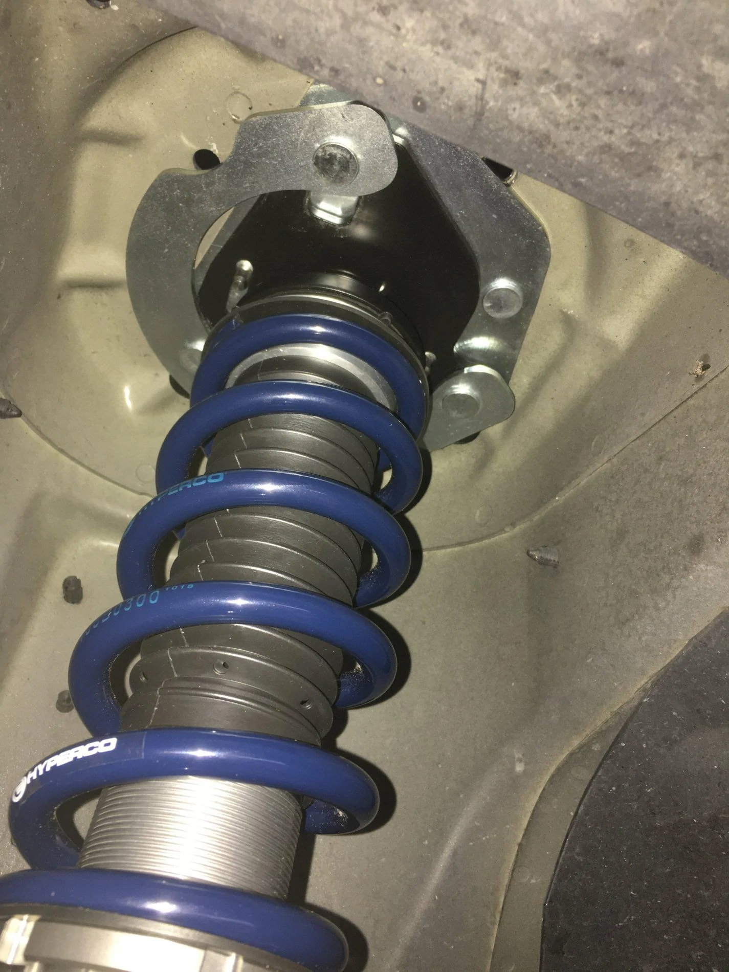

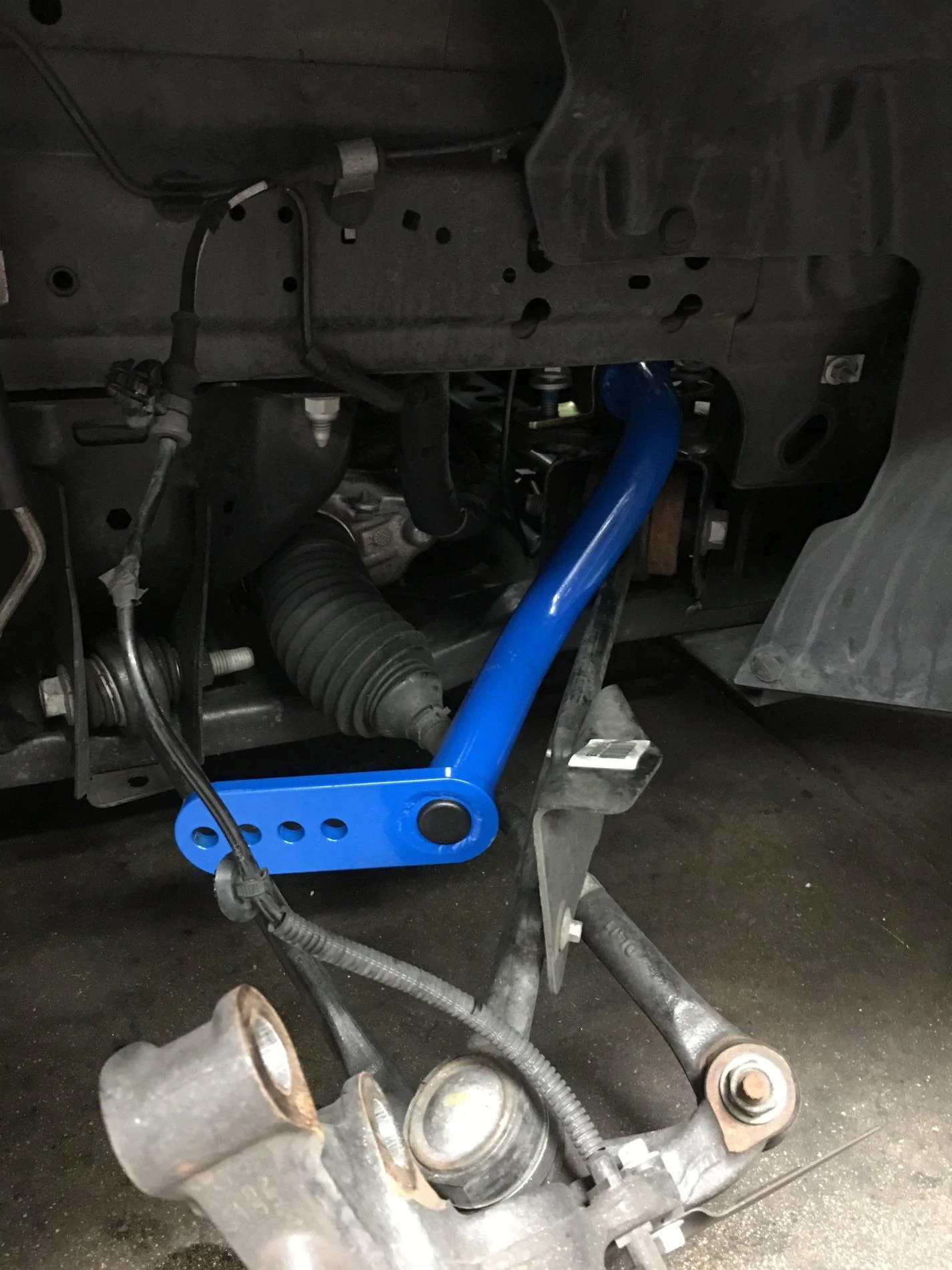

J&M camber/caster plates

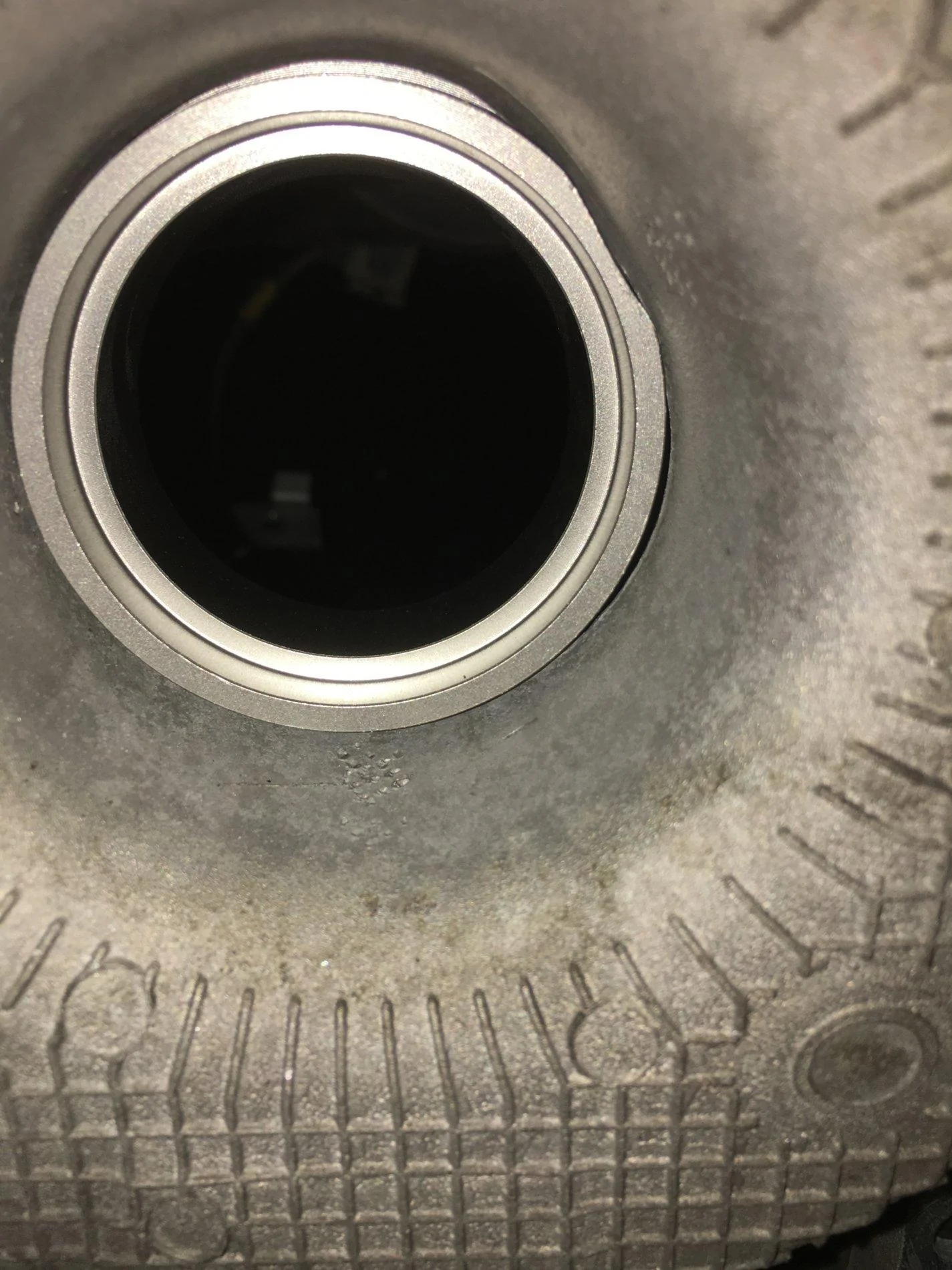

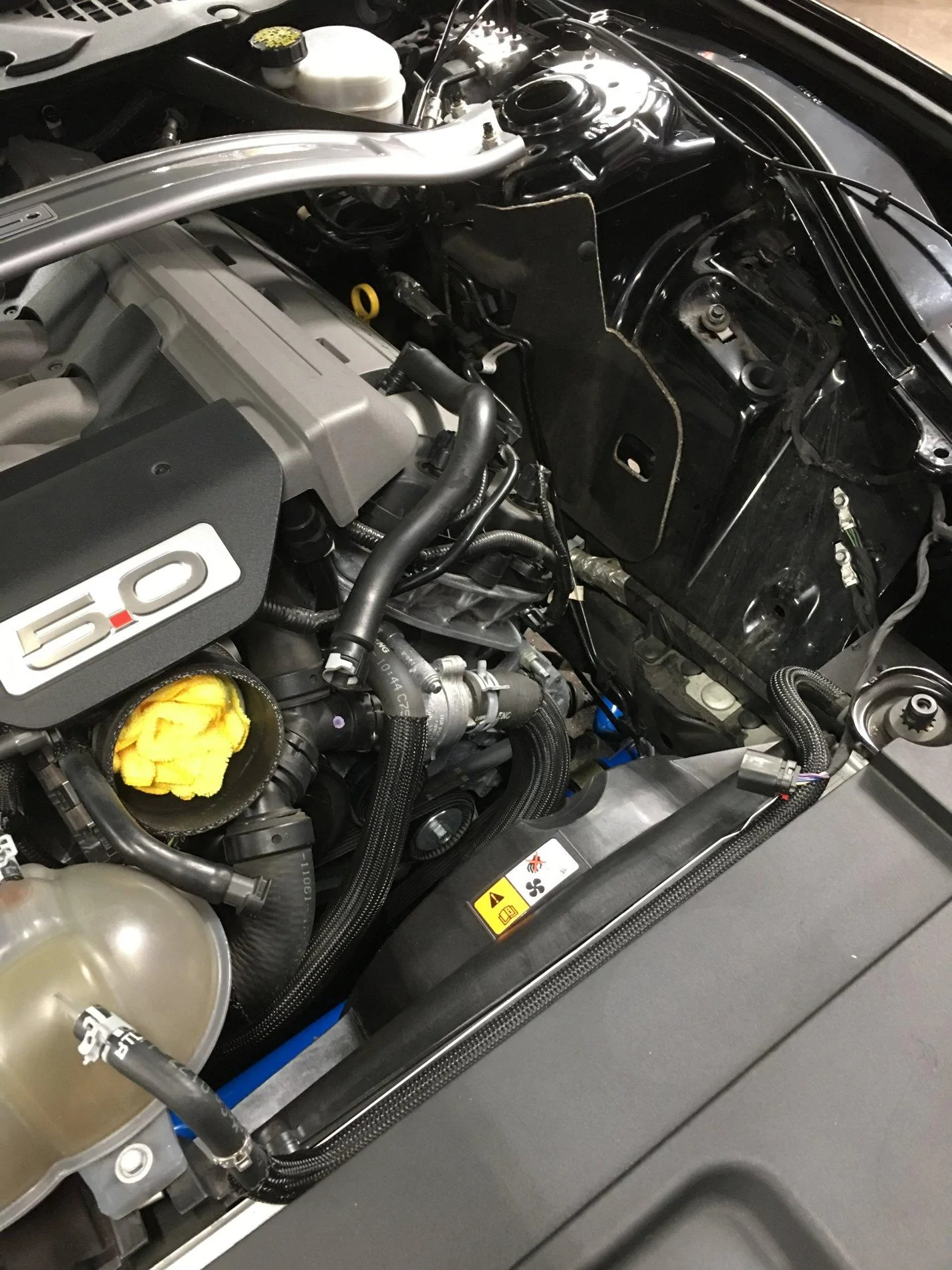

Intake removed to fish in the sway bar.

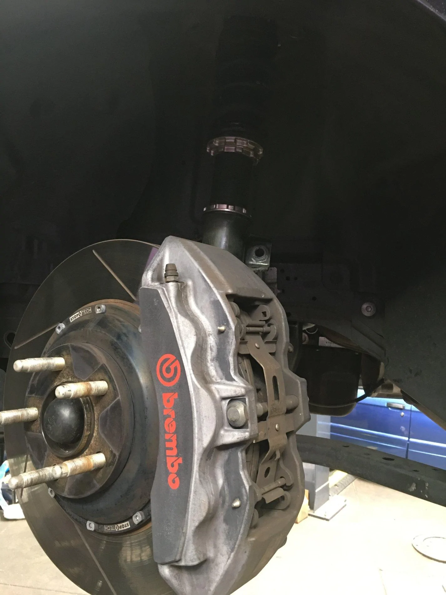

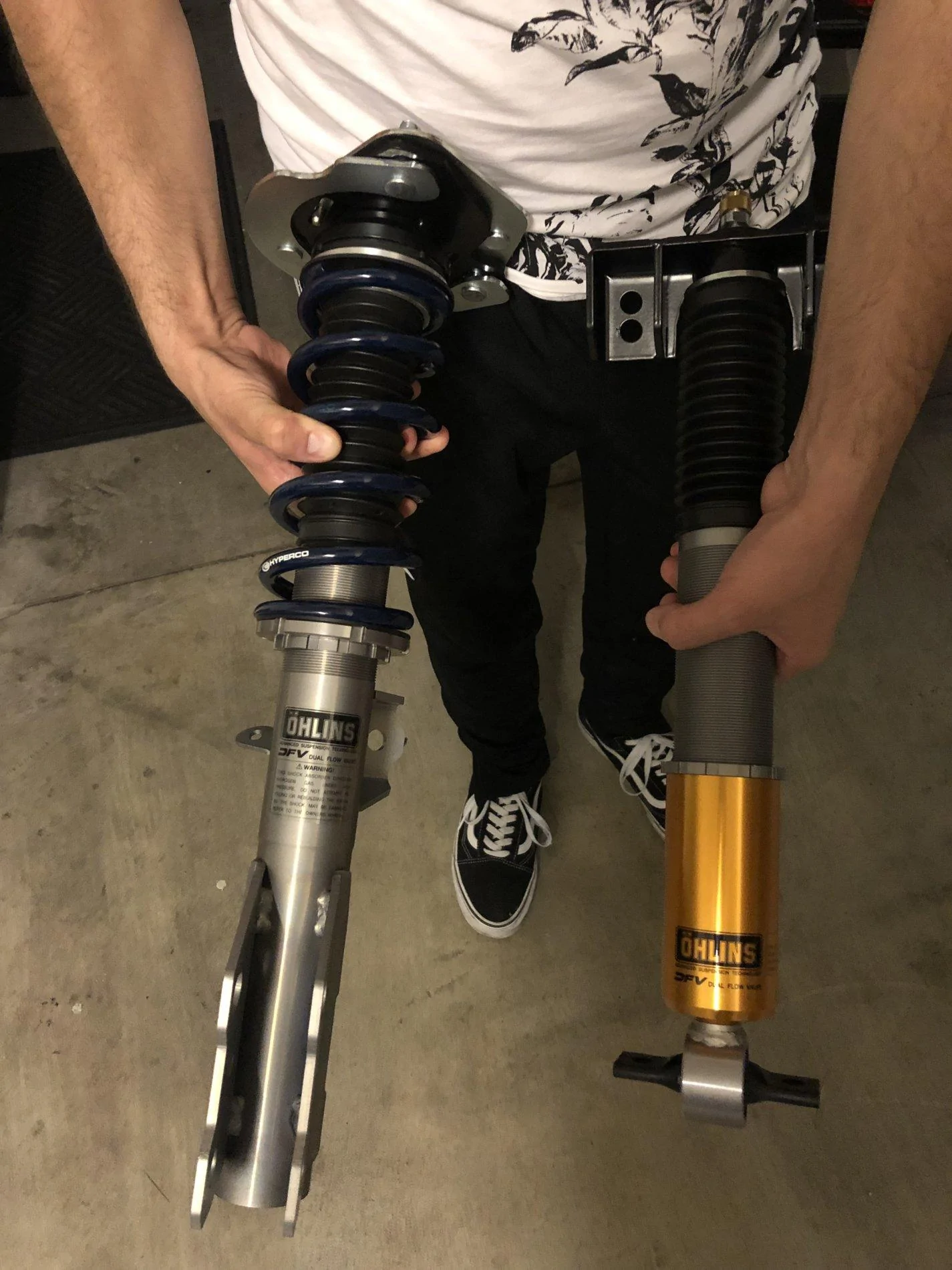

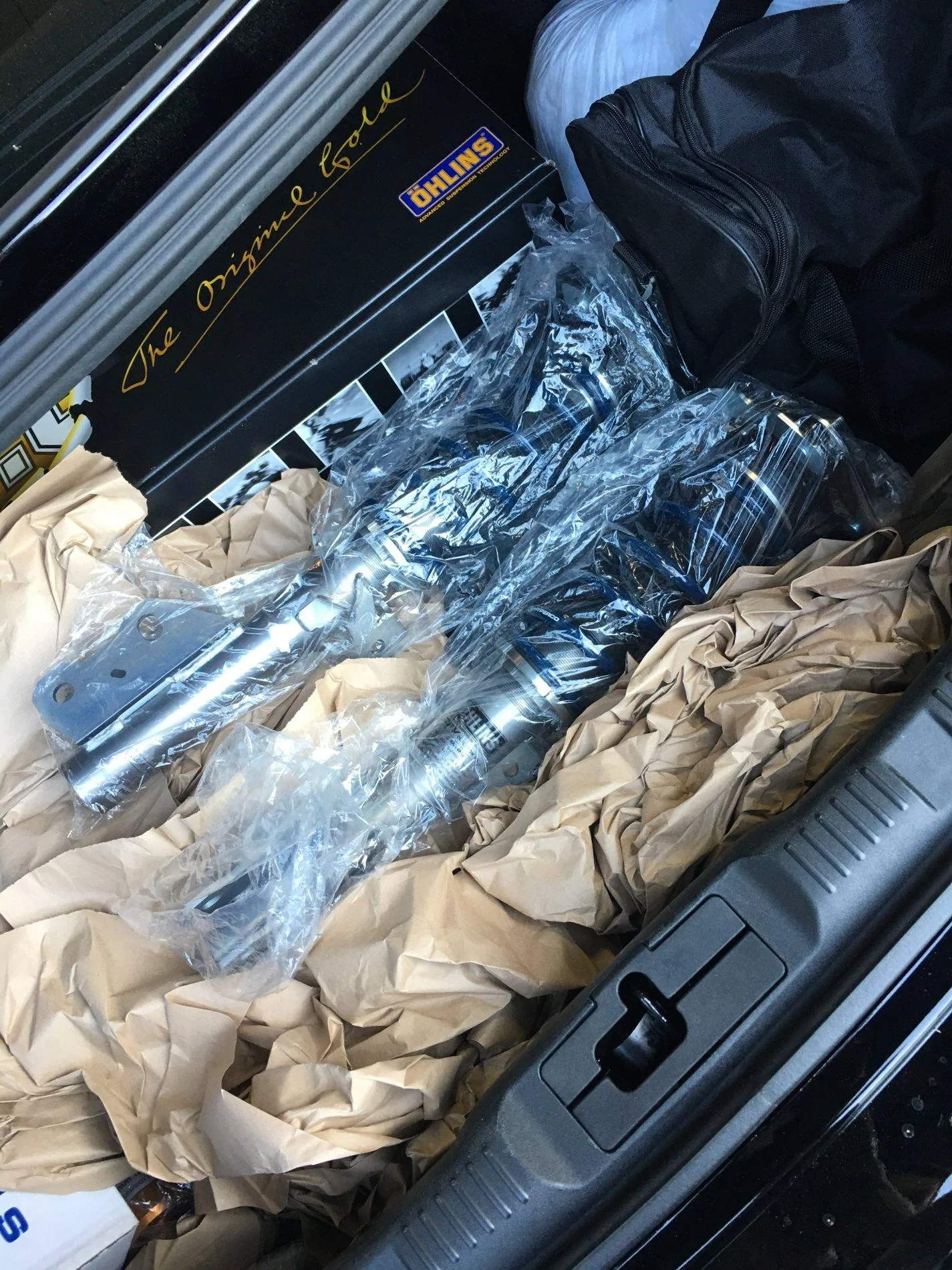

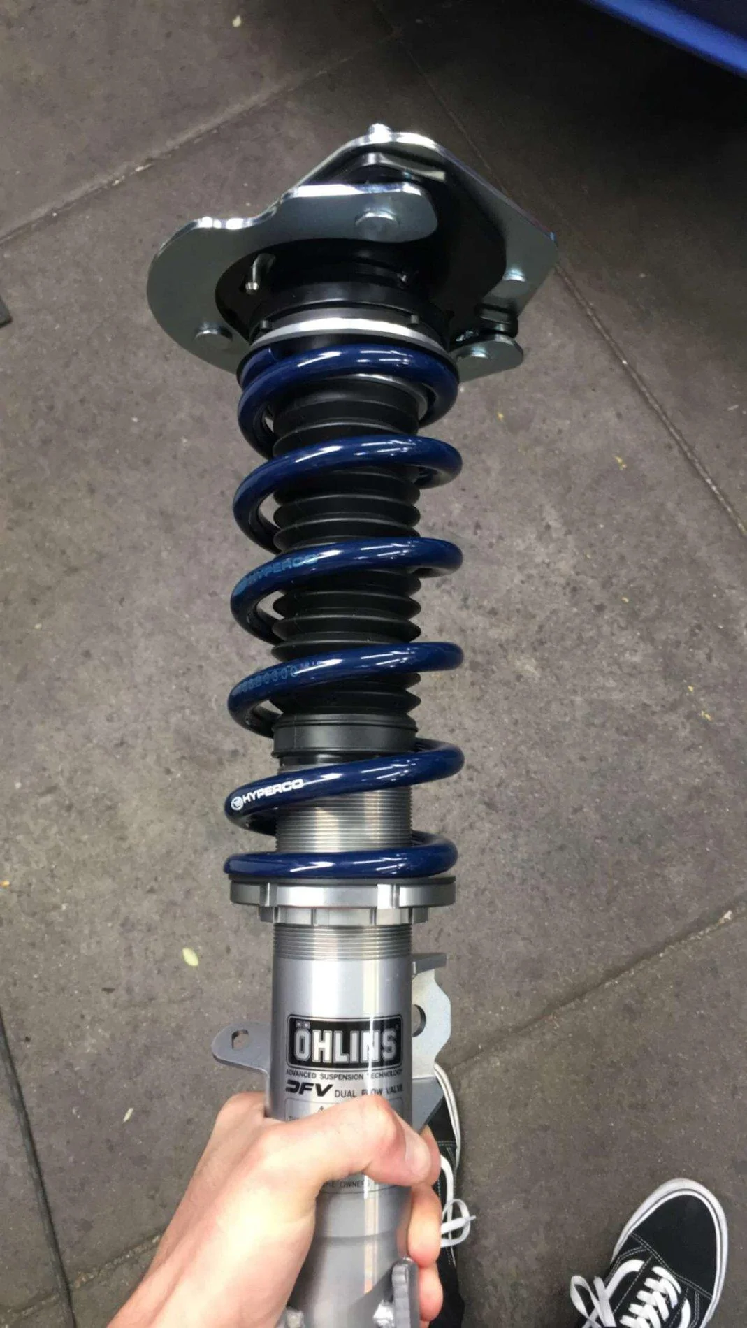

Hey everyone, I finally got to installing my new Ohlins DFV coils from J&M hotpart.com Forgive me if this is unorganized as im using my phone to post.
First we started by removing the old BC’s.

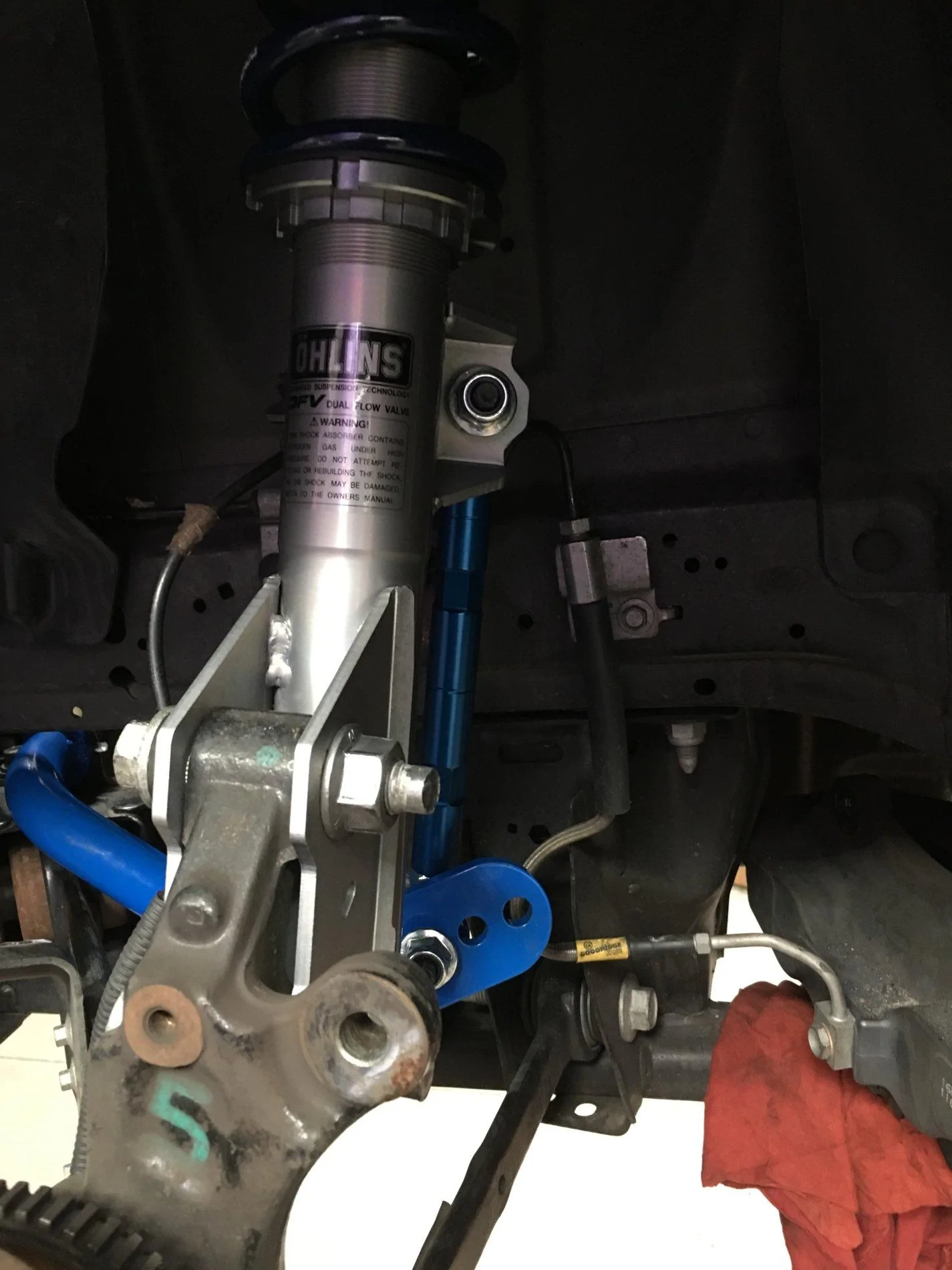

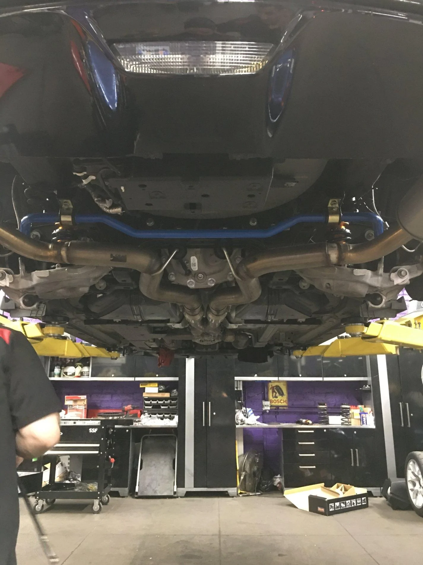

Then installed the sway bars and then the coilovers.
One thing to note when buying these Ohlins is that the rear spring seats are not perfectly round from the factory due to manufacturing tolerances from Ford, so we had to notch the Ohlins spring cup a bit.
Another thing worth mentioning is to make sure your endlinks are set up correctly in order to avoid rubbing on anything.
All work was done at Garage54 Inc in Glendale.

Edit: The sway bars and end links were NOT adjusted in the pictures.

If you also want a set of these don’t forget to Order them from J&M Hotpart.com and take advantage of a nice forum discount code “mustang6g” you can also choose your custom Hyperco Spring rates and they will valve the dampers to spec and include a dyno sheet.
