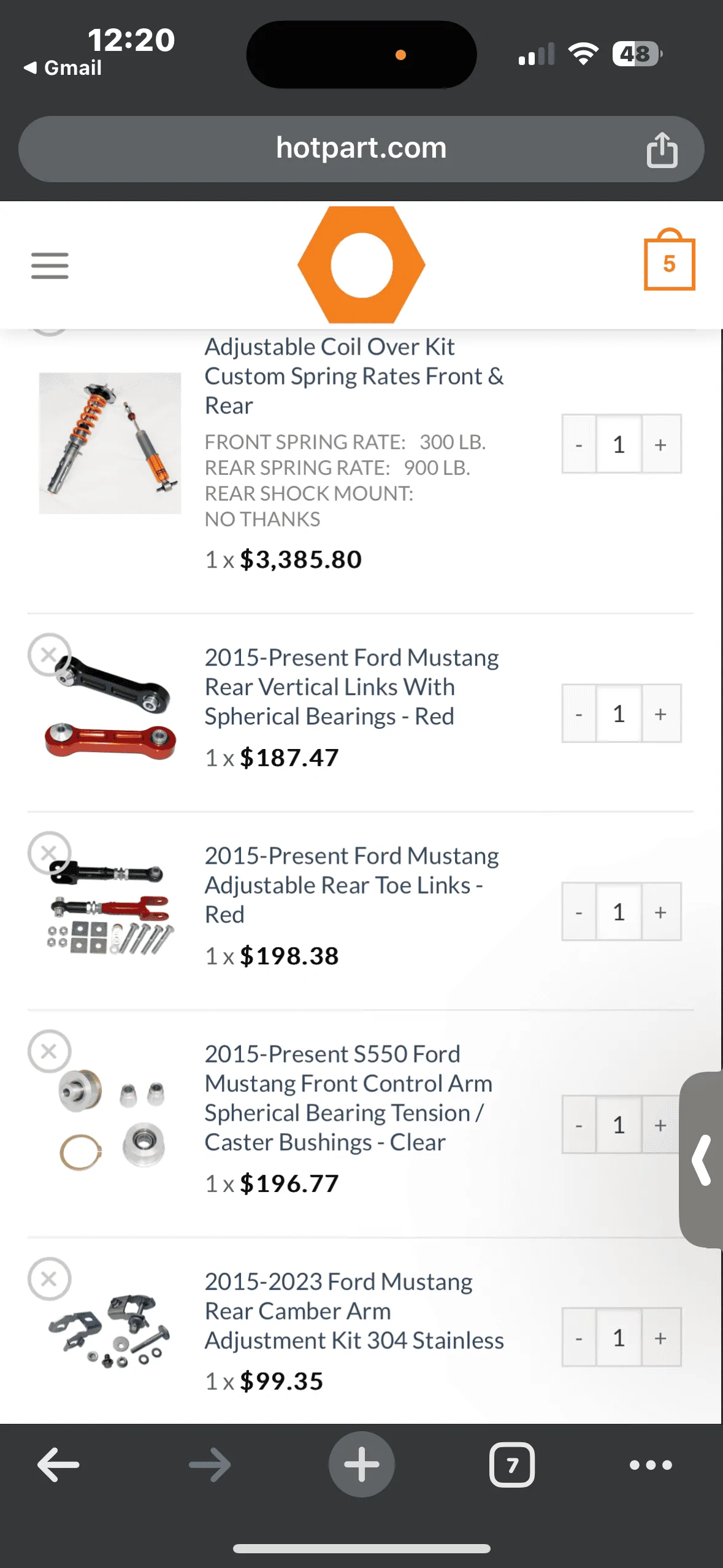

Thoughts? I think this is everything that you mentioned.
The toe links you don't need. It's a great part and serves a purpose. But I've had issues with noise on links like this and eventually went back to stock. The FP toe knuckle bearing, you do want. AMERICAN MUSCLE sells it. 100 bones.
I would skip the spherical on the vertical links. It's not necessary. Even the Mustang GT4 racecar uses stock vertical links. If you do upgrade that I'd find one with a poly bushing. I use the Steeda poly vertical link.
The front control arm bearing you don't need. But it is a great mod. It will make the steering more direct and reduce control arm deflection under hard braking. If it were me, I'd leave this one to later. It adds a tiny bit of NVH. I personally don't mind it.
The rear camber adjustment kit you don't need. It is adjustable from the factory. If you want a better solution, get the SPC camber arms from OPMustang.
Don't forget- address the IRS subframe. Go to BMR CB005 or the Steeda solution.

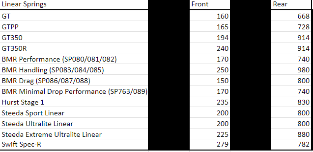

Yeah this setup is similar to the Swift Spec-R setup. Stiff front, soft rear. I think there is some evidence to suggest this is right. Also, go look at the Mustang S550 Bilstein coilovers. They do the same thing. Those two manufacturers know suspension.
Paging @TeeLew. He can provide his thoughts perhaps on the stiff front and softer rear. He does the same thing. Do some hard thinking before hitting that buy button lol 😅

The Ohlins rates get really good comments. If you go to slicks, you might need the added rate, I don't know. You don't need anything more that the stock Ohlins for just about any DOT tire I'm aware, though.
In general, run the springs as soft as you can, but as stiff as you have to control pitch and ride. The car brakes a lot harder than it accelerates, so you need a stiffer front than rear. Control roll and balance with the bars.
It's a complete oversimplification, but this is essentially the thought process.

As a current user of the Steeda dual rates in the back, I definitely think it's not best for feel. For long radius and on banking where you can really load it up it may be great. But trying to go hard in tight cloverleaf's the rear feels like it's struggling to maintain grip. My stock eco feels better in the back

I think 1200 rear is too much for the street, and likely most situations unless you're on the track and running R-compounds or slicks.
