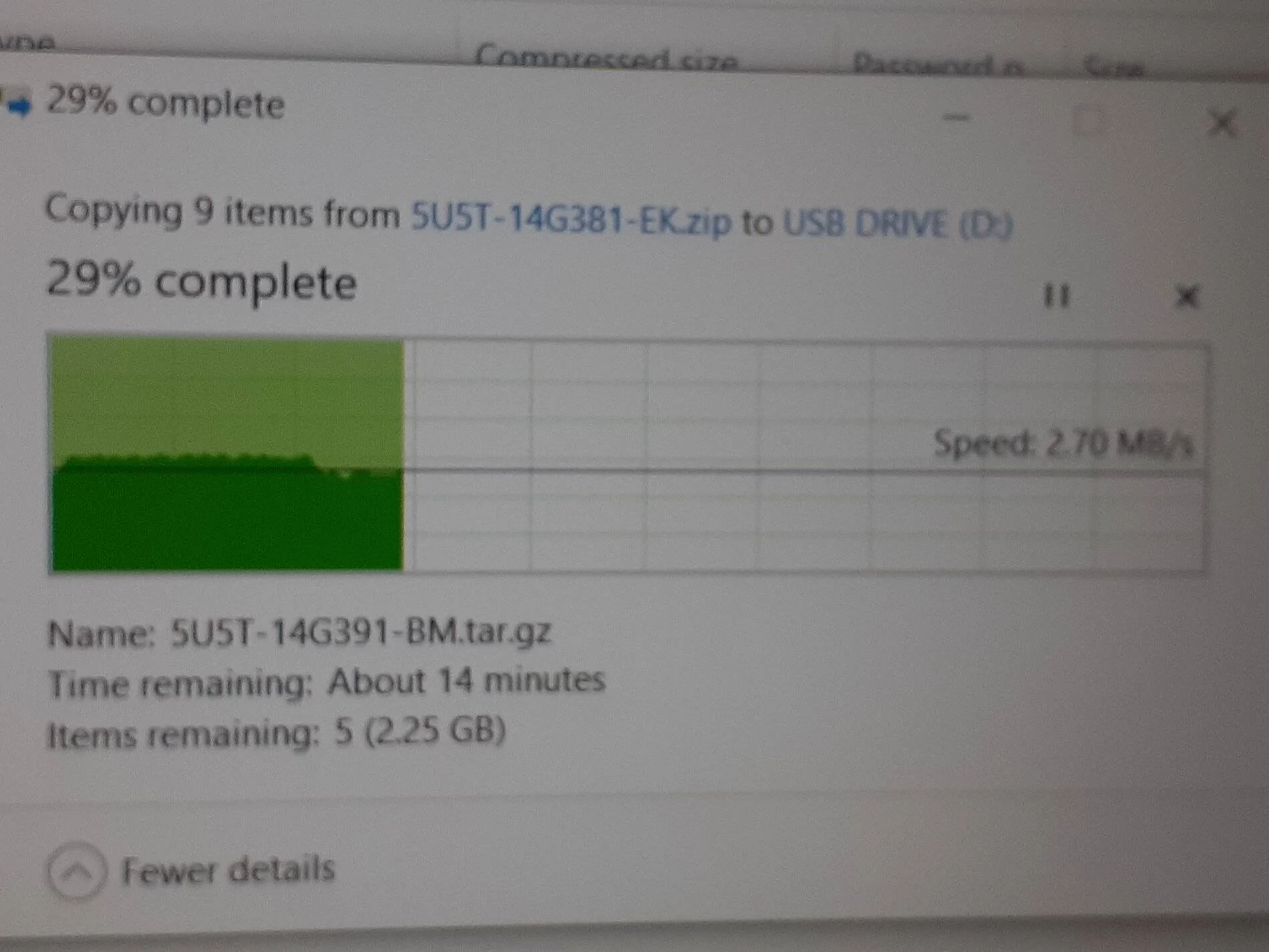

ok thanks. I will try this later and see.
btw, I did format the USB correctly.
Also, did you unpack these on Windows or OS X? OS X usually needs to have the one tool they recommend used. You structure looks fine though, assuming that's a snap of the root / top level. You should plug in, then see the Updating... drop down at the top.

I am using windows 10.

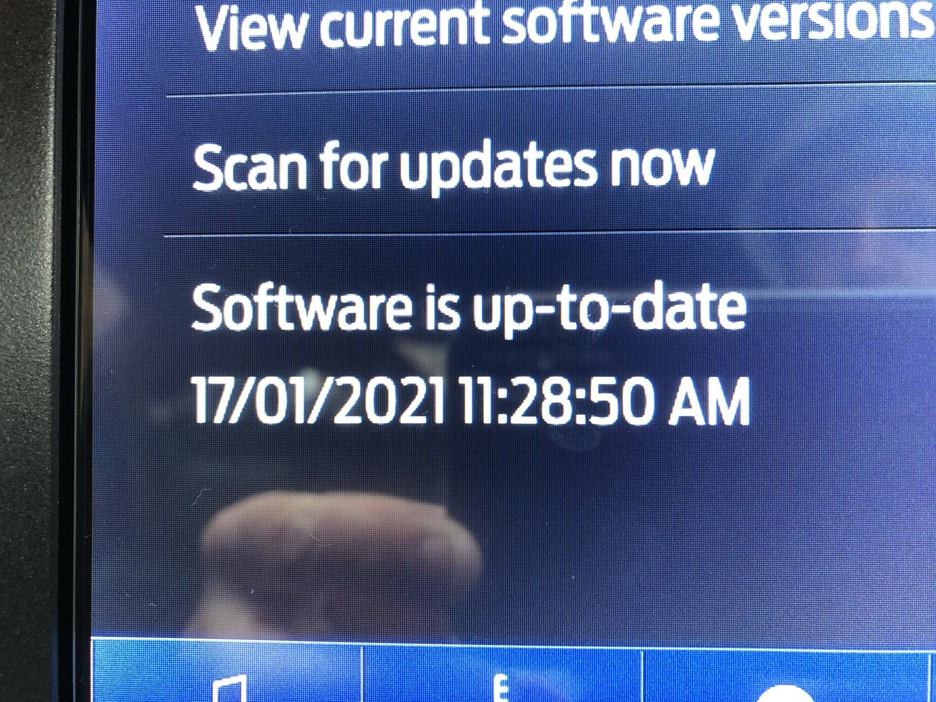

Try the Wi-Fi method if you can. Should get you what you need.
The car after a WiFi connection :
Fords update system after a 24 hour wait :
I don’t think my car and ford U.K. are friends ... lol
Any other ideas ? :like:

well, I re-download the sync 3 update and installed in the mustang went perfectly well. I don't know what happened to the first time I did wrong.
now I am ready to get the map update next.
