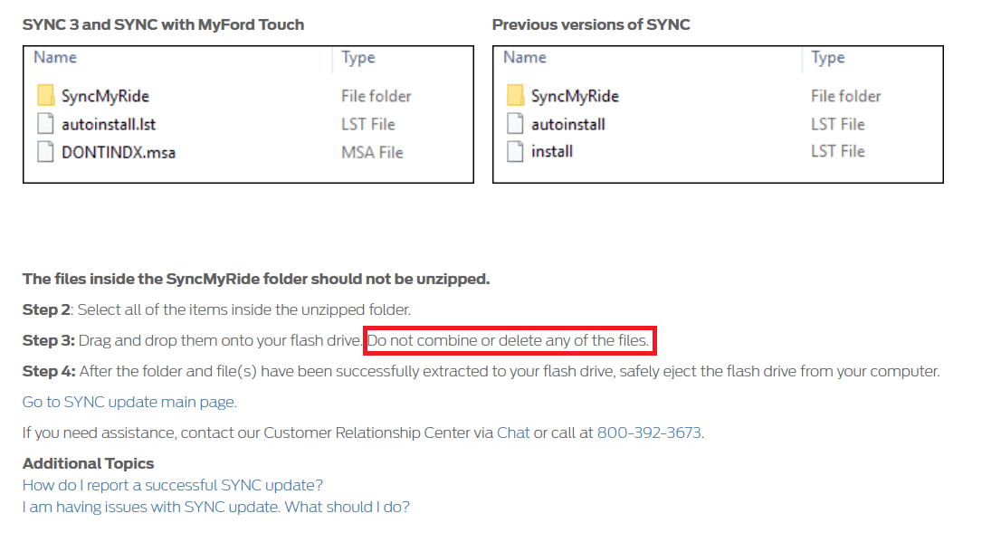

Is there a way to force the creation of the xml file... ?
From original "USB update instructions for SYNC 3":
The update in the vehicle was successful but I cannot find the log file that I shall upload back to the Ford server?
The update information is stored in the SyncMyRide folder on the USB Flash Drive.
The filename includes SYNC + serial number + VIN and has the extension .xml.
If the file was deleted by mistake, please plug-in the USB Stick into your vehicle’s USB Port again and start the Update Process again according to the instructions.
If this file was not created after a successful update, the USB Flash Drive was probably not in the expected format.
Please format the USB Flash Drive to exFat (all data on the USB stick will be deleted) and start the Update Process again according to the instructions.
In both cases, the SYNC 3 system recognizes that the update is already stored and will interrupt the update after a few minutes with writing back the feedback file onto the USB flash drive.

It looks like this time around there's no "activation" file or anything like that, right? I know for the 3.3 to 3.4 update there was a starting file or whatever to put from a folder to folder.
