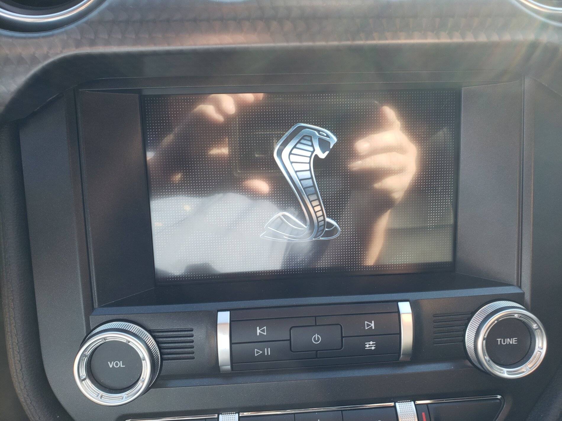

Yeah I have only changed what I think is referred to as the splash screen.
The background once it has booted up is still the standard ford theme - ultimately I want to change that to the Lincoln grey theme :like:
WD :like:
I am using the Lincoln grey theme and prefer it way better than the blue theme. Pony animation on start, no animation on shut down. I don't know if there is a compatible code combo for the FP animation and grey theme. I don't see why not. I messed around with this last year and don't remember exactly what worked.

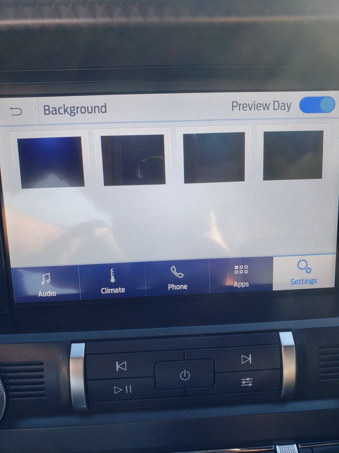

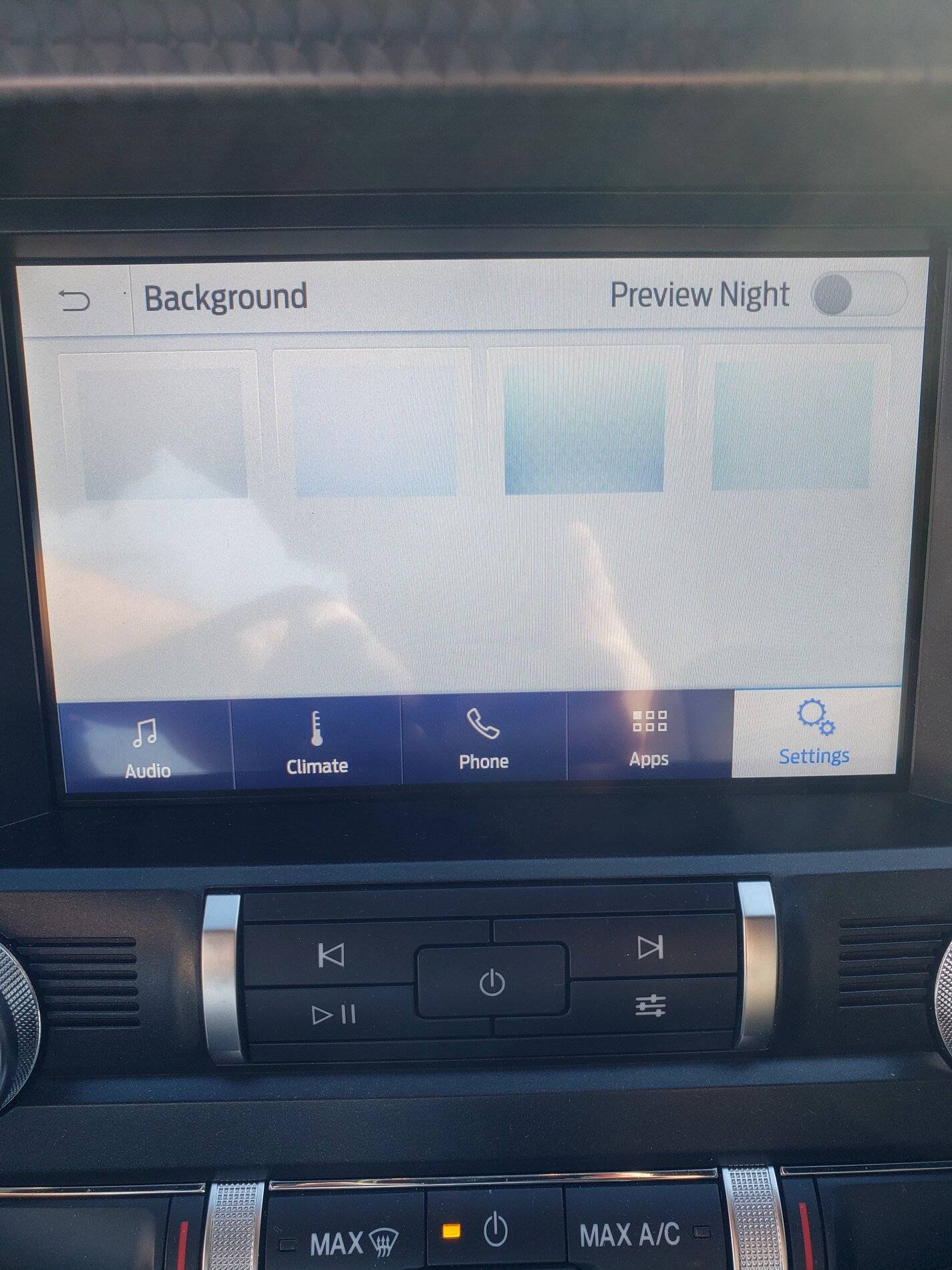

To enable Lincoln black theme with Forscan:
First line has to be set to Lincoln (8)
Leave Mustang animation as is (6)
Lincoln Timeless is the only code that worked to change the theme (2)
7D0-01-02 8xxx xxxx xxxx
7D0-02-01 xxxx x6xx xxxx
7D0-03-01 xxxx x2xx xxxx
After your APIM restarts you can go to display settings and chose NIGHT mode. Go look at the background colors and pick your favorite shade.

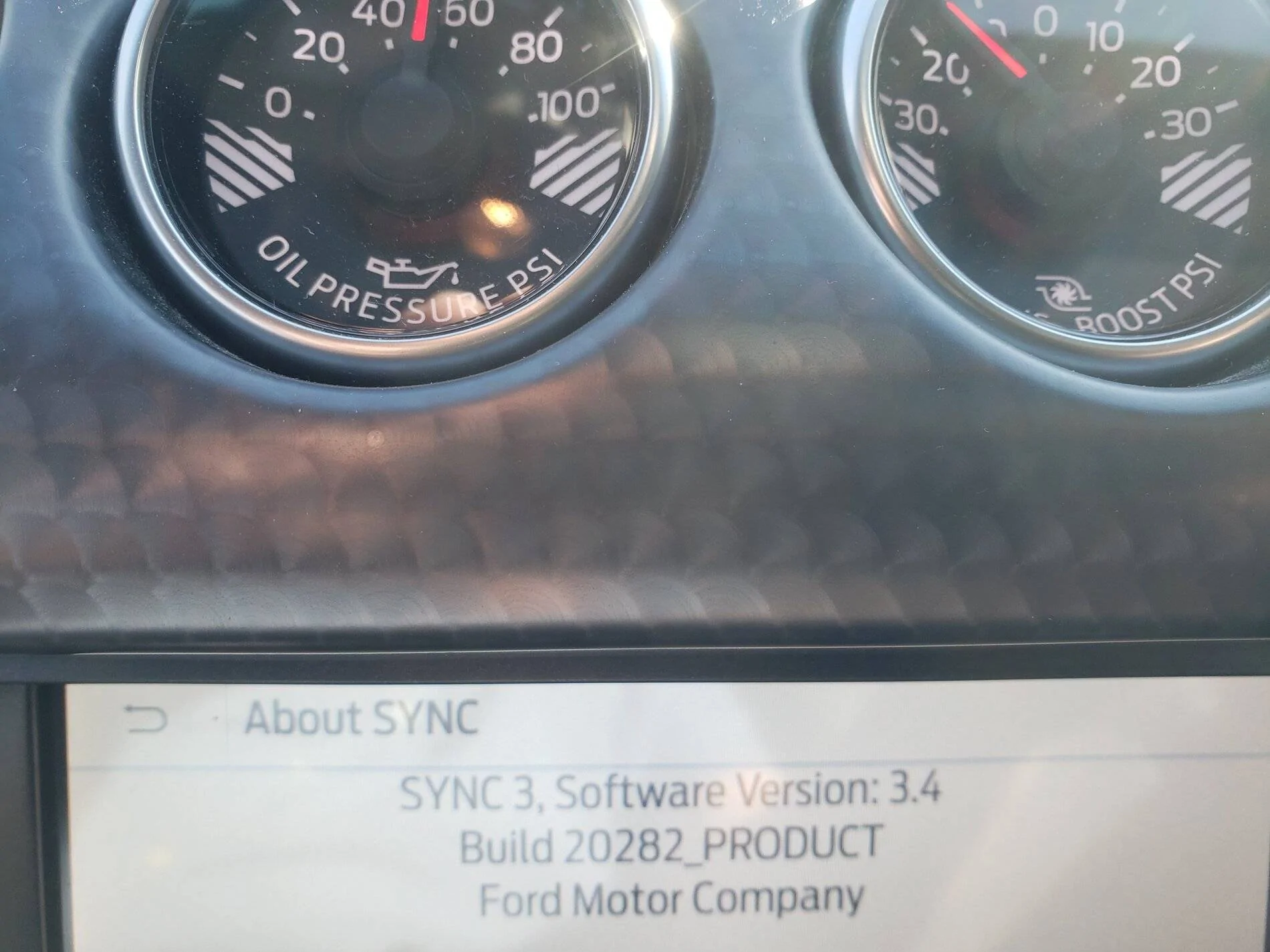

That's cool..I did the update this evening and all is good except figuring out why my android auto isn't working.. I paired etc but seemed to come on then go off..I did some cleaning data and removed my car from AA to see if it works now.. I did the master reset also ..try it tomorrow.. your AA worked with not doing anything?
No issues with AA. But I had to connect my phone via USB to get the AppLink apps working again. But once they were reloaded they work fine via Bluetooth.

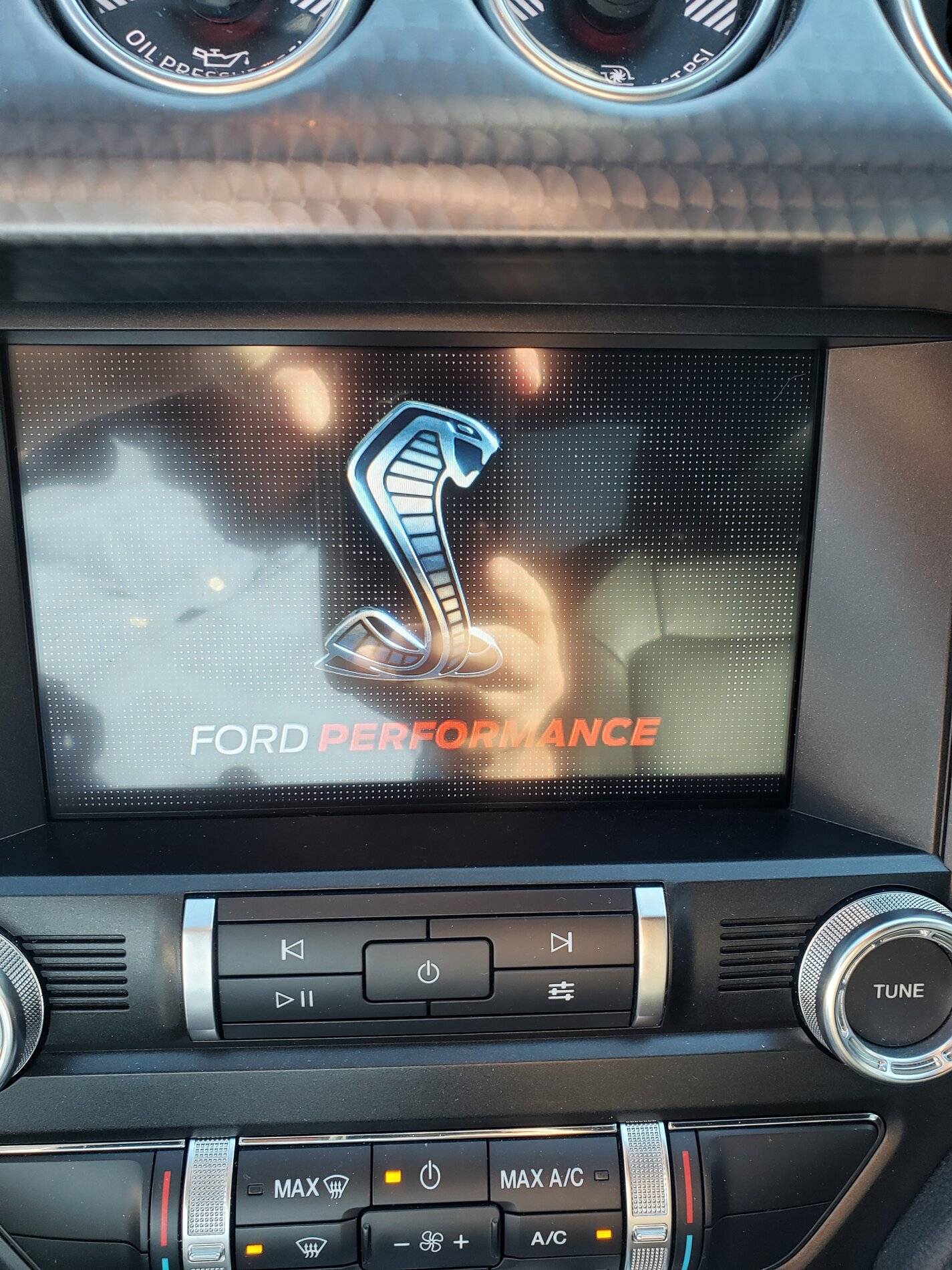

Do you know the forscan value for ford performance ( the cobra ) and did the climate controls on screen remain after?
Yes, everything works perfectly, including cooled/heated seats and heated steering on both home and climate screens. For FP animation, use this code: 7D0-02-01 xxxx 10xx xxxx. Hope this helps.

That's cool .. I did the update and all is good too. Thanks for the forscan info.. does the animation show when turning on and off with just a change in one line ?
