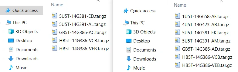

Following on from the above (as I now get that interlog file) ...
My first download gave me the five files on the left - they gave me an xml file but once uploaded, Ford failed to recognise the sync update (although it appears to work perfectly).
My second download gave me the seven files on the right - they give me no XML file and the interlog file exactly as per the above post.
If it makes a difference, I am a euro car using the Ford UK site :like:
Any help really appreciated :like:
WD :like:
WD :like:
Can't really be of any help on why the interrogator fails. No knowledge of the inner workings on that bit. For the file sets, those look fine for an EU build. Left would appear to be 3.4.20136 where you have the Voice and Apps packs, then 3.4.20282 where you have Voice + Apps + Gracenotes.

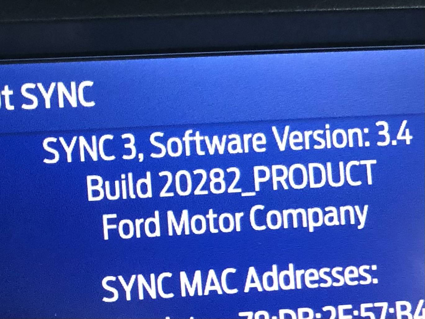

As the car is running 20282 successfully :
