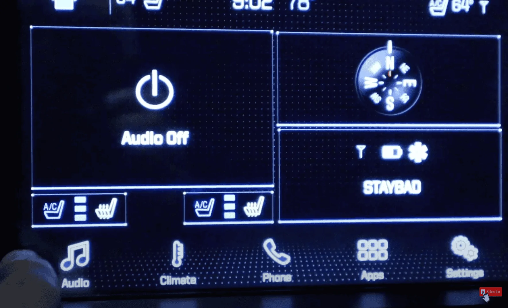

I used these settings on my 2020 Mustang Ecoboost running Sync3 version 3.4 and it worked and looks great. Sooo much better than the default blue! But I recently came across a YouTube video where this guy was showing the "Ford GT" theme on his Mustang's Sync and I think I'd like that even better. However, it doesn't seem like this theme exists in Sync 3.4 anymore. Does anybody know it that's the case? Thanks!
Ford removed this theme from Sync 3 ver 3.4. So yeah, can't use it if you go up to 3.4.
