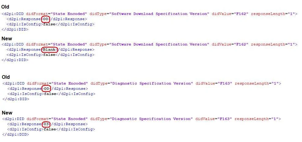

OK, I downloaded the package and installed it again. It ran much more quickly this time, and it generated a new XML. When I compare it with my old one I can see two differences:
These seem to be related to a software version, so they could explain why Ford thought I wasn't up to date.
There's one more difference in the free space in one of the partitions, which you can see below. I'm sure this has nothing to do with how Ford determines if I'm up to date, but I think it's relevant in the sense that something new might have been installed today, which wasn't there before.
Let's see. I've uploaded the new XML. I'll keep you posted.

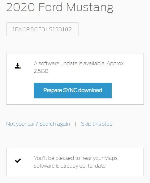

In Europe they're on the same website. When you look up your VIN they tell you if there's a new software update for you, or a map update, or neither. And map updates are not listed unless there's no software update pending.
Here's how it currently looks for me:
"You'll be pleased to hear"... No, I'm not pleased to hear that, because I know it's not true. :crackup:
But I don't think I'll see any other message in that box as long as there's something to download in the other box. At least that's how it used to work with my Mondeo and Sync 3 v3.0 - always got software updates first, then map updates. Never the other way around, never both at once.
