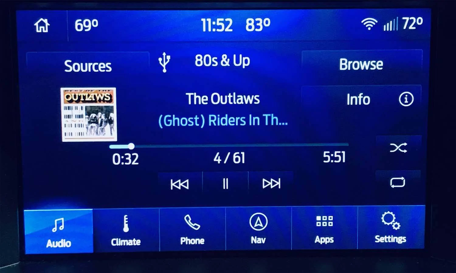

Absolutely horrendous update for music lovers. First of all, when playing my music through the USB port the new audio screen on 3.4 is a huge step backward. Can the album artwork get ANY smaller?
Then, worst of all, Sync will not allow browsing playlists anymore! When I do a New Search I first got the message "For your safety certain functions have been disabled" . Okay, so I tried searching for playlists when I was stopped and all I get is "Browsing Currently Unavailable." Originally I would get that error message while indexing which would last a minute or two, but with the 3.4 update I was getting that message after 20 minutes.
Am I the only one with these problems?
