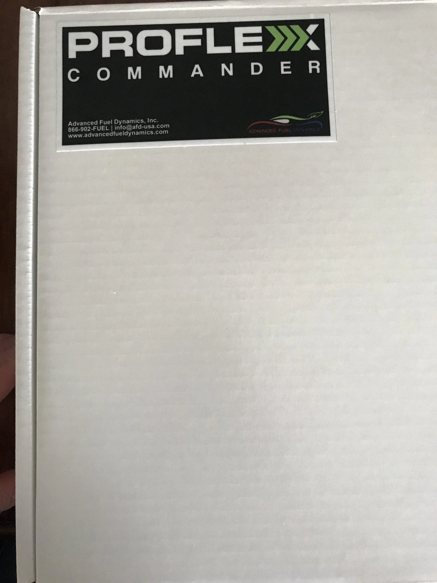

Wow!!! Summit Racing is quick. I got my kit in a day with free shipping. It beat the fuel line disconnect tool kit that I ordered as well. I didn’t think it was going to come in that quick. I just dropped my car off at the Ford body shop to fix the infamous gt350 bootie sag. They had to order brackets that were like $700. Take advantage of that warranty.
