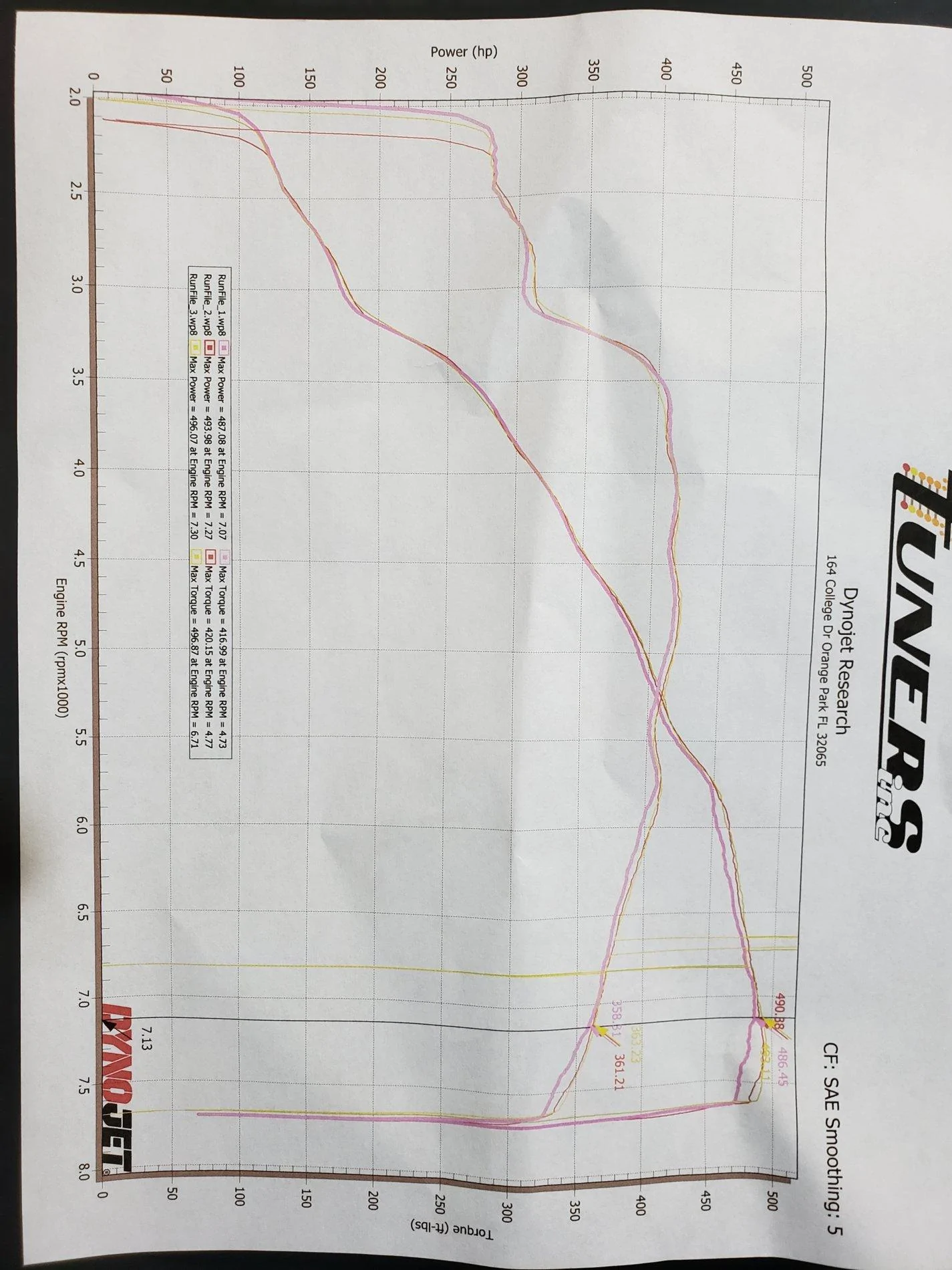

Installed the Proflex a few days ago. Ran on 93 till today to make sure everything was good to go. Took her to a local tuner and got her on the dyno. Did 2 runs on 93 (was almost empty) and then added 10 gal of e85 did 2 more runs. Content came to about 70-72%. Made 487hp and 416ft/lbs on 93 and 496hp and 420ish ft/lbs on e70. I say ish because the dyno had a few torque spikes on the second ethanol run. Long story short, no codes, no strange behavior since putting ethanol in the tank. Made more on 93 than expected and gained less than expected on ethanol. Power mods are Bline cat delete and Borla Atak. No tune. Not willing to risk the warentee at this time.

thanks for the clarification. so it looks like you gained about 10 hp over 93 octane running about e70. gray at AFD says we'll gain the most hp between 65-80 ethanol content. so you're getting about the max we can get at e70'ish. 10 freaking hp lol. since i run 91 octane, i am going to say i gain about 12 hp :sunglasses:
AFD says with intake and tune they got 51hp gain from 93 to e80: https://www.advancedfueldynamics.co...der-for-ford-mustang-gt350-and-gt350r-voodoo/
such a big difference. they also told me via email expect 30hp gain on a stock gt350/r. i guess we need more data points and dyno runs. but thanks for contributing.
