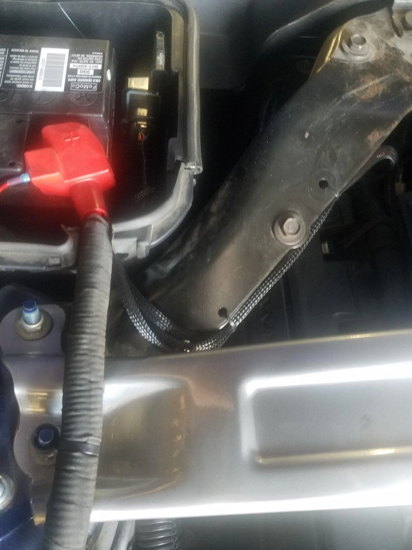

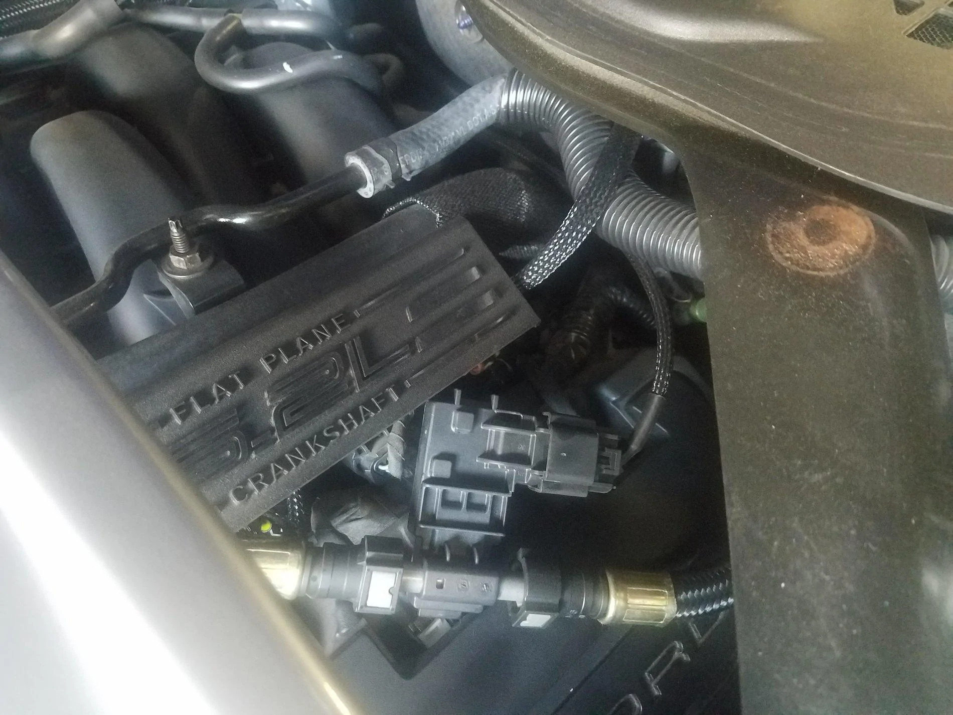

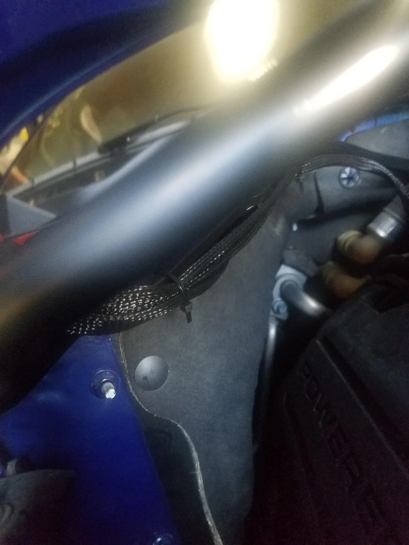

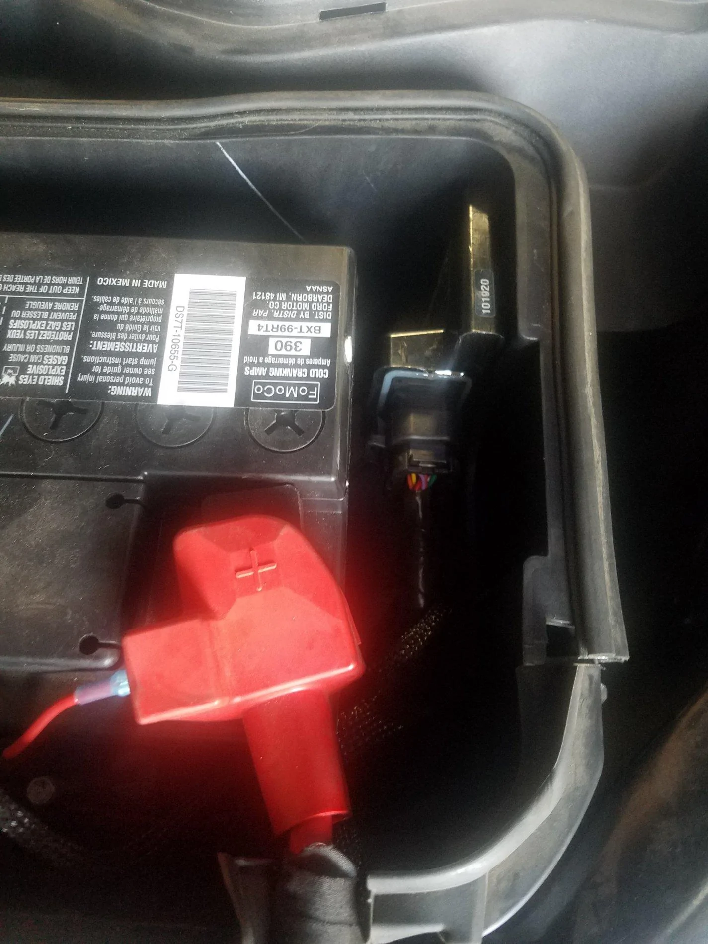

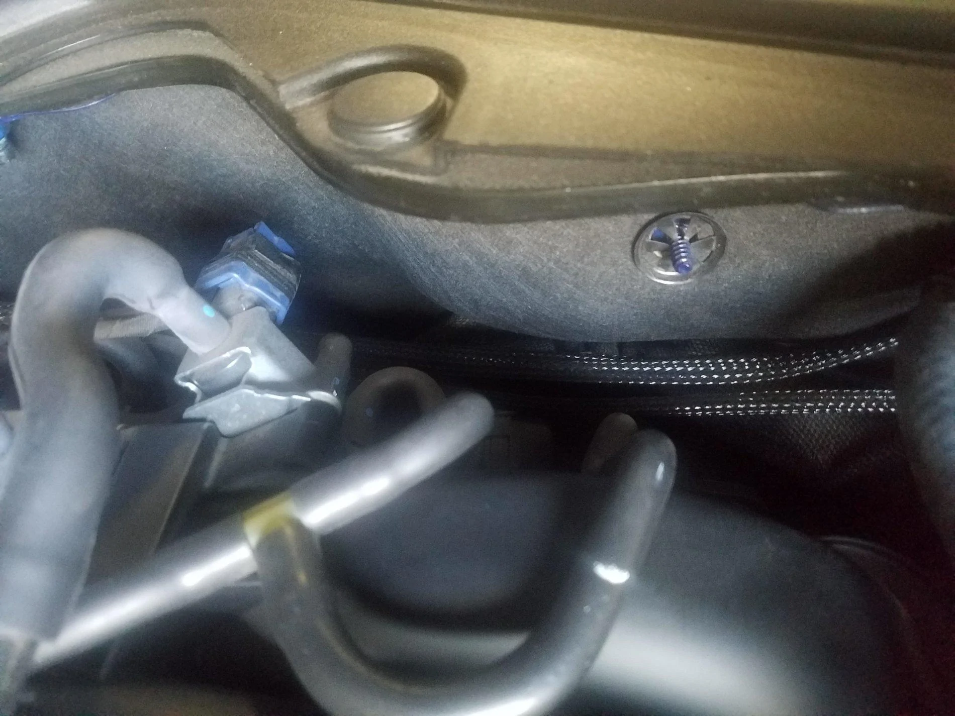

I am at home I will take detailed pics tomorrow (my car is stored in my shop) I was able to chase all the wires into the battery box through the existing hole where the positive cable runs to the battery.I Tied into the ground from the 10mm nut that fastens the Neg Bat Cable to the Battery terminal.I have yet to mount the Power Commander to the battery box. I think the instructions only mention mounting the box harness side down to keep weather out. But as @mmakam2 stated its dry inside! The wires that lead to fuel sensor and drivers side injectors are ran up the black steel piece running from the battery box across the firewall and then to the appropriate connections. I zip tied all the extra wire inside the battery box so it looks real clean!

Yes please! Would love to see photos for reference. Plus no additional cutting on the battery cover. That’s ideal.

Just ordered my kit Saturday. Any tips or pictures on how to route or hide your wires so that it doesn’t look like a mess?
lightrules
lightrules
Jul 25, 2018
2,446
2,288
West Coast
Yes
@FLATPLANE brought it along firewall at the back of the engine, his is probably the cleanest look.
