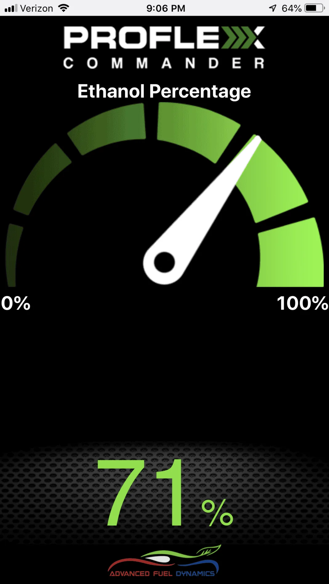

I can tell a difference since I’ve added the proflex commander. Even from having intake, full headers and exhaust and dyno tune. My best has been e71.

When I mentioned to the tuner that they claimed a 50hp gain he said "sure, it would make that compared to 87 octane." His shop specializes in Mustangs, he told me about a 5.0 that they tested a theory on. From 87 octane to a e85 tune they made 49hp. I did the dyno pulls about 25 min apart. Same temps, same barometric pressure, same humidity. Car didnt even leave the dyno. Once we put in the e fuel we ran it at 3000 rpm for about 3 min to work the e fuel through the system. Once the app showed 70% we did the last 2 pulls. 50 hp is a false claim in my opinion. I still like the system though and got it for 20% off so I'm somewhat happy. Not unhappy.
I can tell the difference too. Not so much the power but smoother acceleration. Chrisper on the top end and makes power till redline. As the dyno showed, 93 near redline backs things down because of knock. The tuner taught me a ton today about how the knock determines what map the car uses and the such. Very complicated but intresting.
