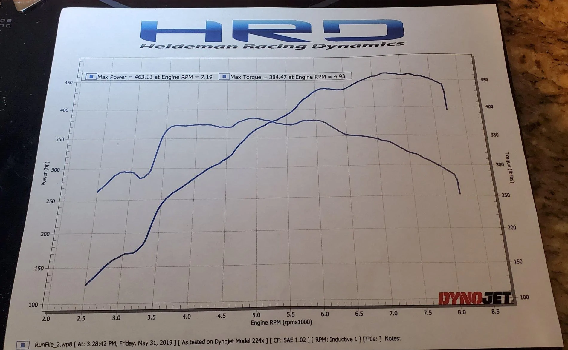

Just an update guys, I had my car dynoed bone stock at Heideiman Racing Dynamics, on a DynoJet, made 463whp. (SAE smoothing, not STD)
Then my shifter broke, and my car is at the dealer. Once I get it back, ill continue my journey and updates.
