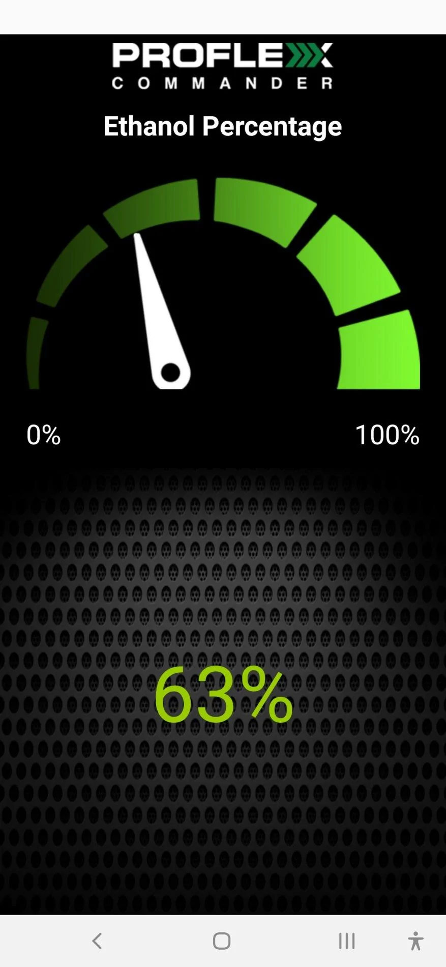

So, I was finally able to get down to a 1/4 tank of 91 octane today, and a local ARCO had an E85 special of $1.85 valid only today. Most so-Cal E85 prices hover around $2.75-$3.00. So I filled up from the 1/4 tank of 91 and the rest E85 and that got me to E63-E65...
I had the old harness and was not feeling that the kit was doing anything with my first tank of E85. The car just wasn't running smoothly and I was getting "pops" and "pows" on certain up-shifts that just didn't sound right. Now with the new harness, the car is DEFINITELY feeling good, throttle feels much better (more power) even in the lower RPMs that wasn't previously there. The car runs smooth, the loud "pops" and "pows" seem to have gone away (I am not talking about the crackle and gentle pops and blurbs that we all love). In short, the ProFlex Commander with the new harness seems to be working as advertised. Finally!
I say all this tentatively though as I've only driven it 10 miles on E65 and the new harness. I have yet to even go WOT. But so far, the feeling is night and day from the old harness and all the problems we were all having on that old thread.

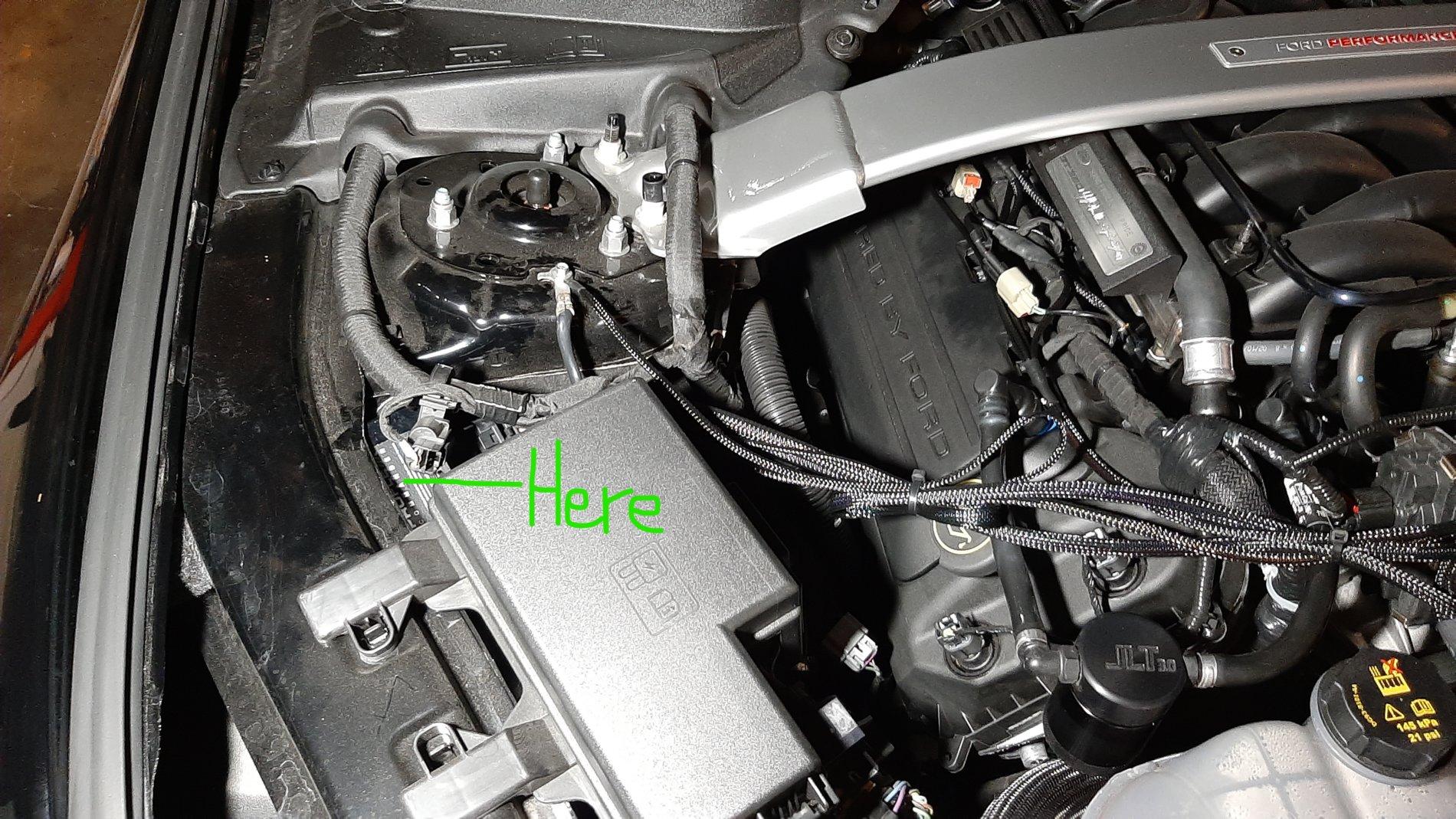

So at this point, I'm optimistic and really happy about how the new harness is working. Here is where I have placed my Commander, right above the fuse box in the engine bay, passenger side, in a little nook I found...

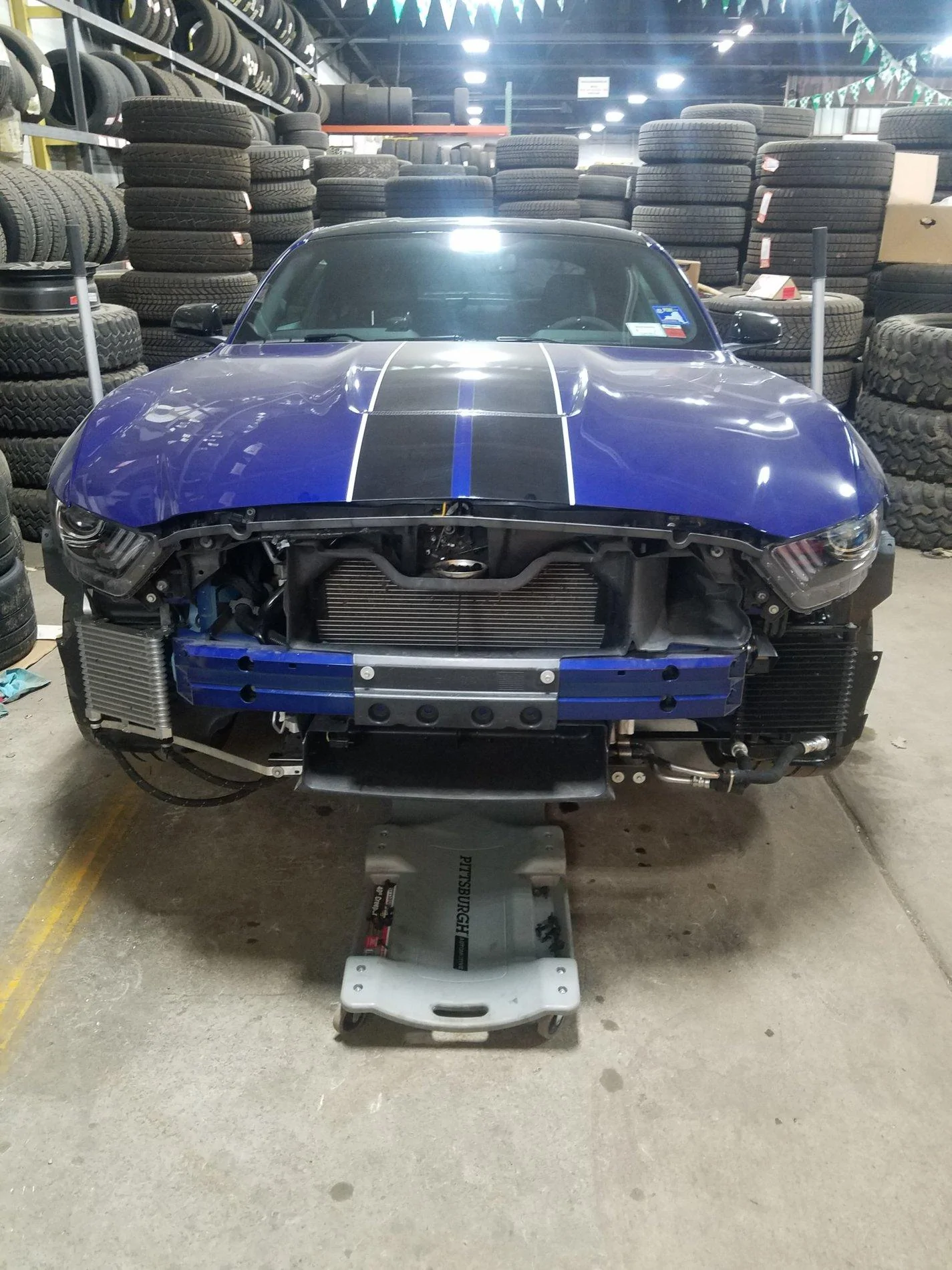

Here is Mine right now lol
FLATPLANE
May 5, 2017
120
50
Buffalo NY
Billy
2016 Shelby GT350 Tech Pkg. 18 Chevy Silverado 1500 4x4 16 Lexus IS350 FSport
Front Toe Hook from ZL1 Add-ons
Fixing up front end Splitter was a little gap in there
Cleaning out Radiator, Oil Cooler and Trans Coolers of debris
Rear Knuckle to Toe Link Bushings Ford Performance
AFD ProFlex Harness install Hopefully Tonight/ Tomorrow
